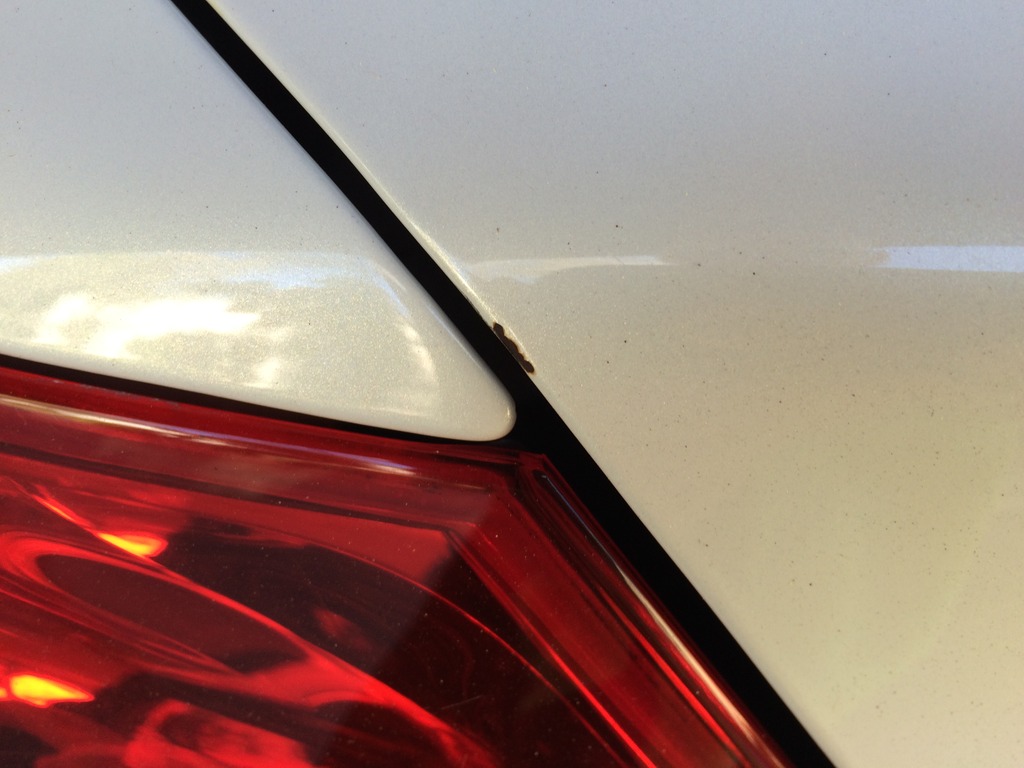

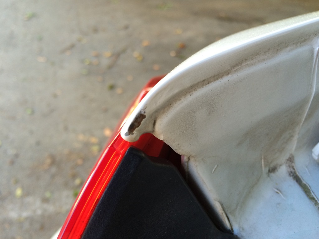

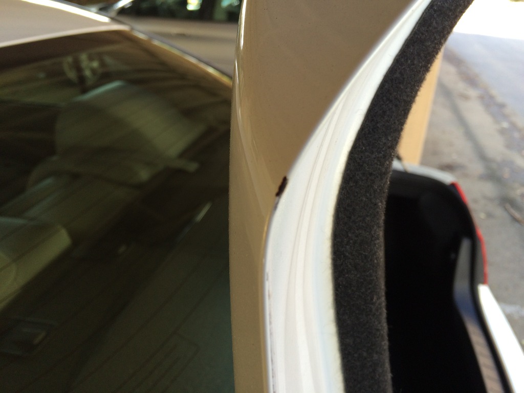

Does anyone have issues with the trunk hitting the rear fenders and chipping the paint? I adjusted the stoppers per the FSM and even replaced the stoppers.

Absolutely. My bottom side corners hit the plastic light tops. It looks like there is clearance, but closing the trunk causes the lip to hit. I've sanded off the rust and repainted it. It continues to get hammered down to the metal. I may just try to keep that part of the lip wet with rust proofing. You probably want to close the trunk gently. It's hard to control what your passengers will do.
I do! Fully extend bump stops too.
Sadly, and weirdly all my panel measurements are "within spec" per the FSM (DLK-221)
Also, the bumper keeps popping up at the right rear qt panel junction. No rearward accidents in this car (only minor front bumper dmg). Weird...
Did you end up finding a solution? I dont want to repair it only for this to come back and ruin my efforts.
UPDATE: I managed to make the panels align slightly better by adjuating the height of the plastuc covered 9mm bolts that act as hinge stoppers. I still dont like the fitment, but it's not touching on trunk close anymore.
