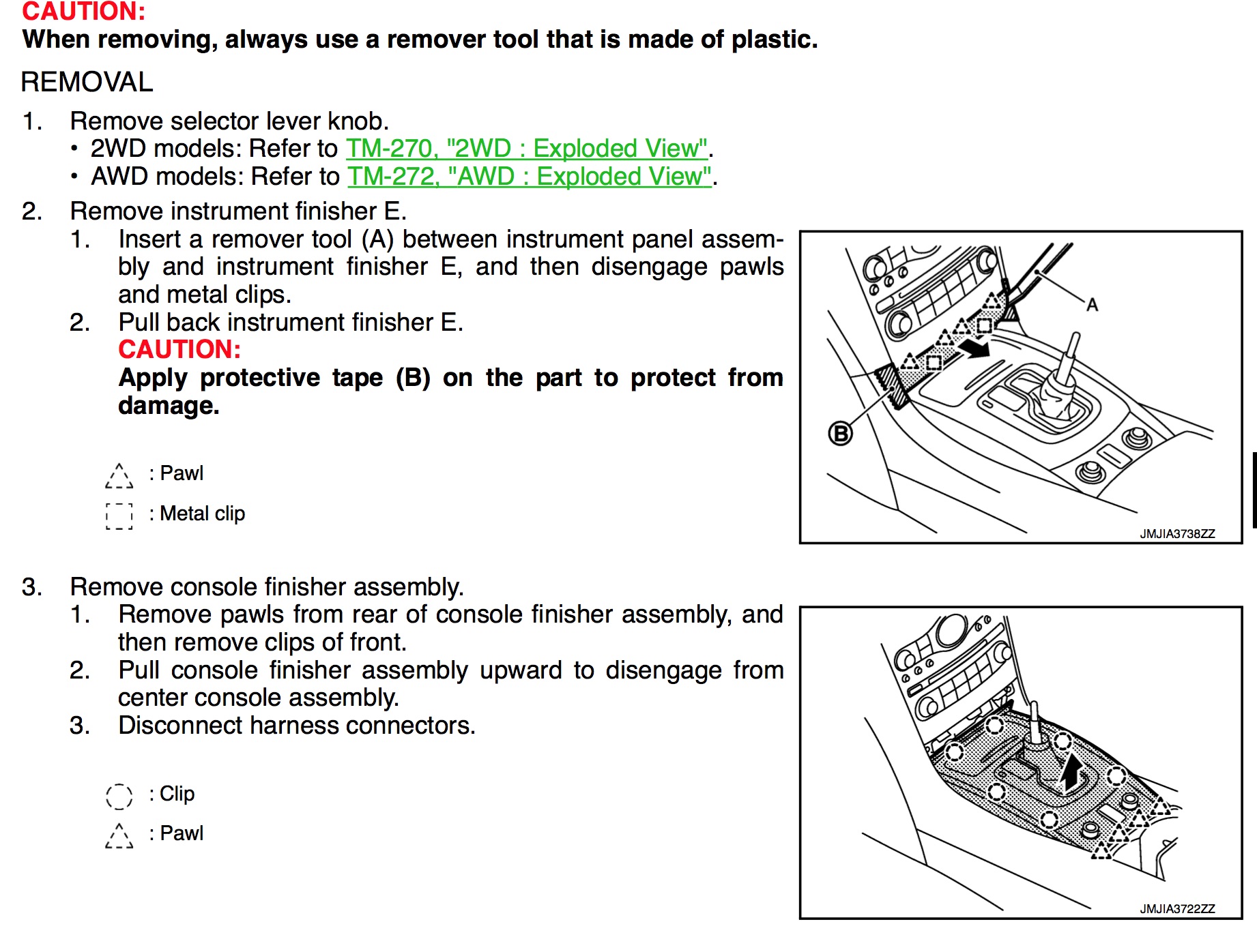

You talking about just the trim piece around the shift lever? (see pic) I think you pop the clips starting at the rear of this piece (thin plastic scraper to pry it without damage) and then the last two front ones pull slightly back...

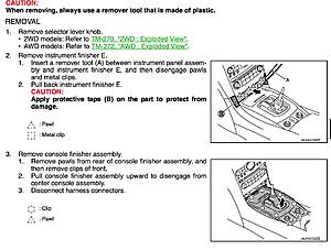

Eh, sorry, I pulled that pic from an older service manual ('06)... This should get you there:
