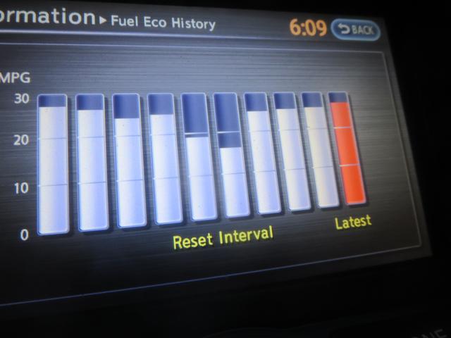

There is only one accurate way to calculate MPG
Fill tank, set odometer to zero.
Reset computer
Drive 350 to 400 miles at a steady 70-75 MPH no cruise control, tire pressure 35lbs when cold
Remove junk from trunk
Refill tank and divide miles traveled by number of gallons to refill tank
Reset computer again
Four fill-ups from NJ to Florida
Two fill-ups for local driving while in Florida
Four fill-ups on the return to NJ
Frequent starts and stops, short trips kill MPG on these vehicles
