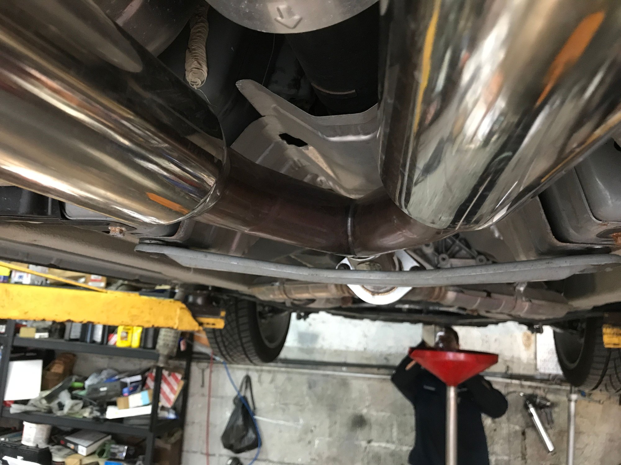

Hi everyone, this is my first post and its a question.
I recently installed BC racing coilovers on my 2013 g37x sedan and I am glad to say there is no "clunking" noise in the rear. I had my topspeed Y back exhaust installed and it seems like the middle area of my car is banging onto this center bracket piece.
Did anyone ever remove this center bracket and have no trouble with their exhaust? Is this piece a structural or rigidity piece that is important to the car? Any insights would be great thanks!
topspeed Y back exhaust recently installed

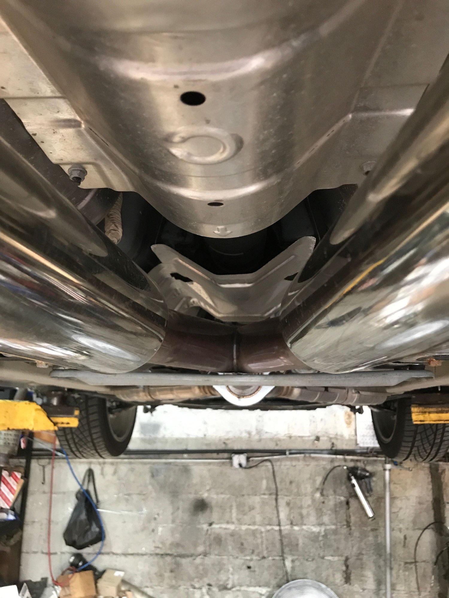

All fixed!
Just posting after pictures now, its all good no more noise issue. Thanks all.
before: its literally touching already so it rattles.
after: the clearance of a few millimeter cleared it. No more rattle or metal to metal contact noise.

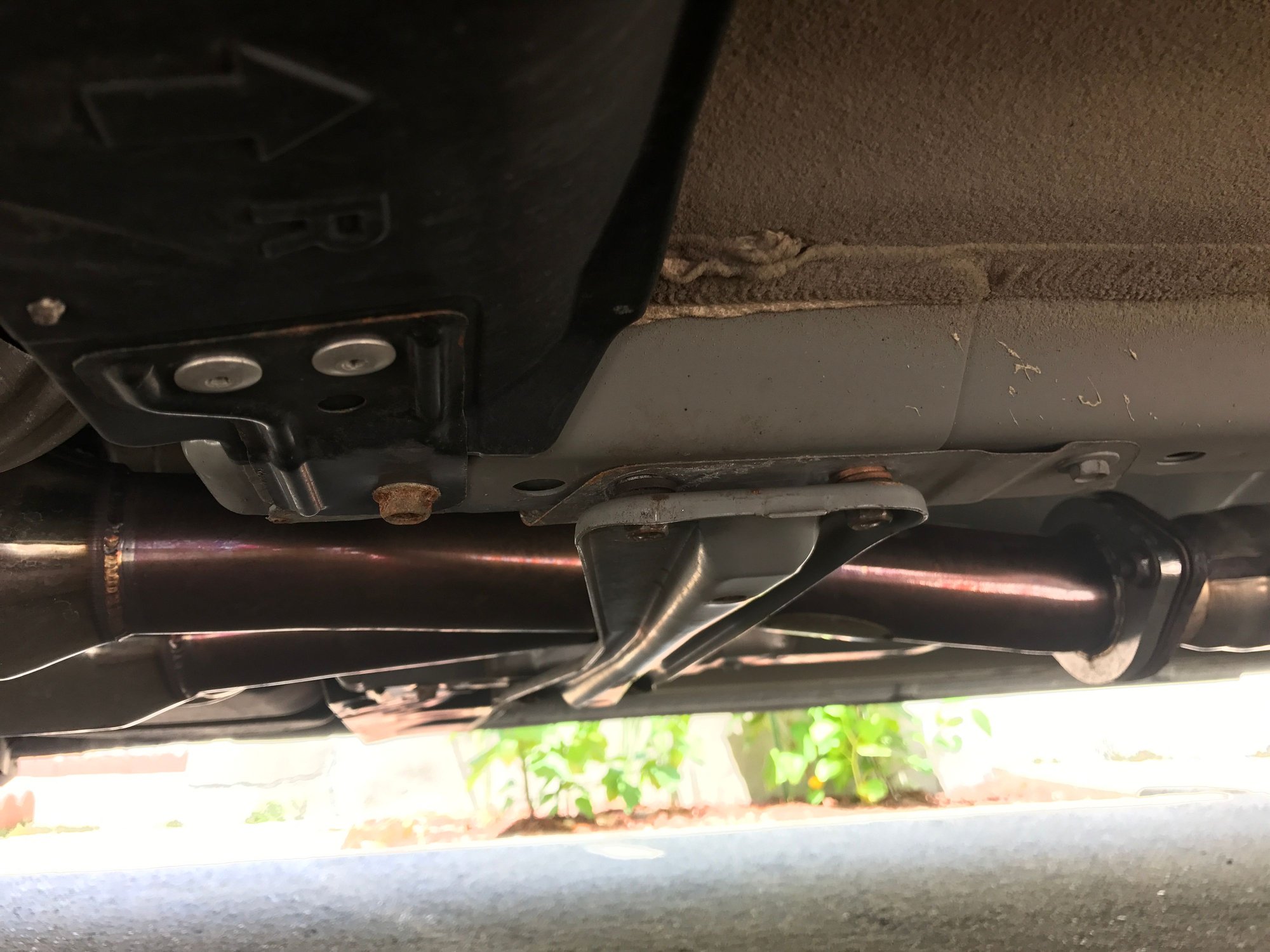

Do know what the part number is / or what it’s called this is the only thread I can find this part on and can’t seem to find it no where
