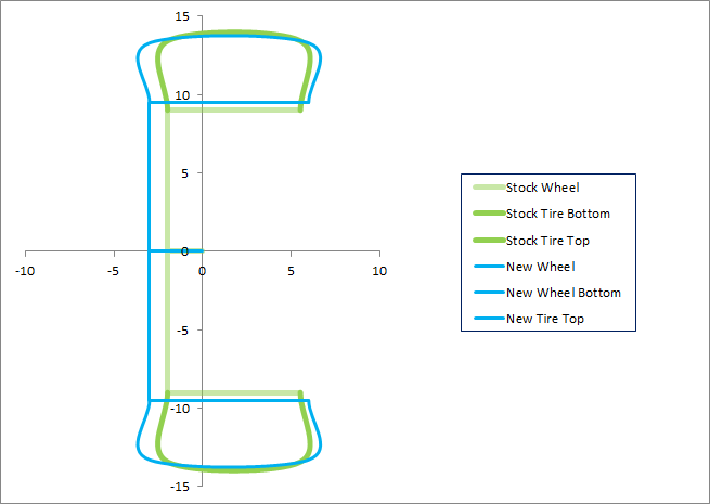

I am running a 19x9 +38 with 275/35-19 Continental DWS's, and on anything but flat roads, they require some muscle to keep the car straight.
Old May 5, 2017 | 10:50 PM
JohnP's Avatar
JohnP
Joined: Apr 2017
Posts: 7
Offset is only 7 more than stock
The stock offset on the front is +45, so running +38 is only a 7mm difference (center of your setup is 7 mm further out than stock). When I was having trameling problems, I wondered if the offset was to blame (in theory, the stock suspension should rotate about the center of the tire and when you move the front tire out, road imperfections have more leverage if you will to move the suspension around), although 7 mm = ~1/4" is so small.
I also wonder, if just having a wider setup on the front leads to problems on uneven surfaces and/or with worn tires as the outside edge of the tire is that much further out from the axis of rotation.
In your case, the outside edge of the tire is 26 mm (about an inch further out). See attached picture.
For me, new tires was the fix. Don't fully understand why.
