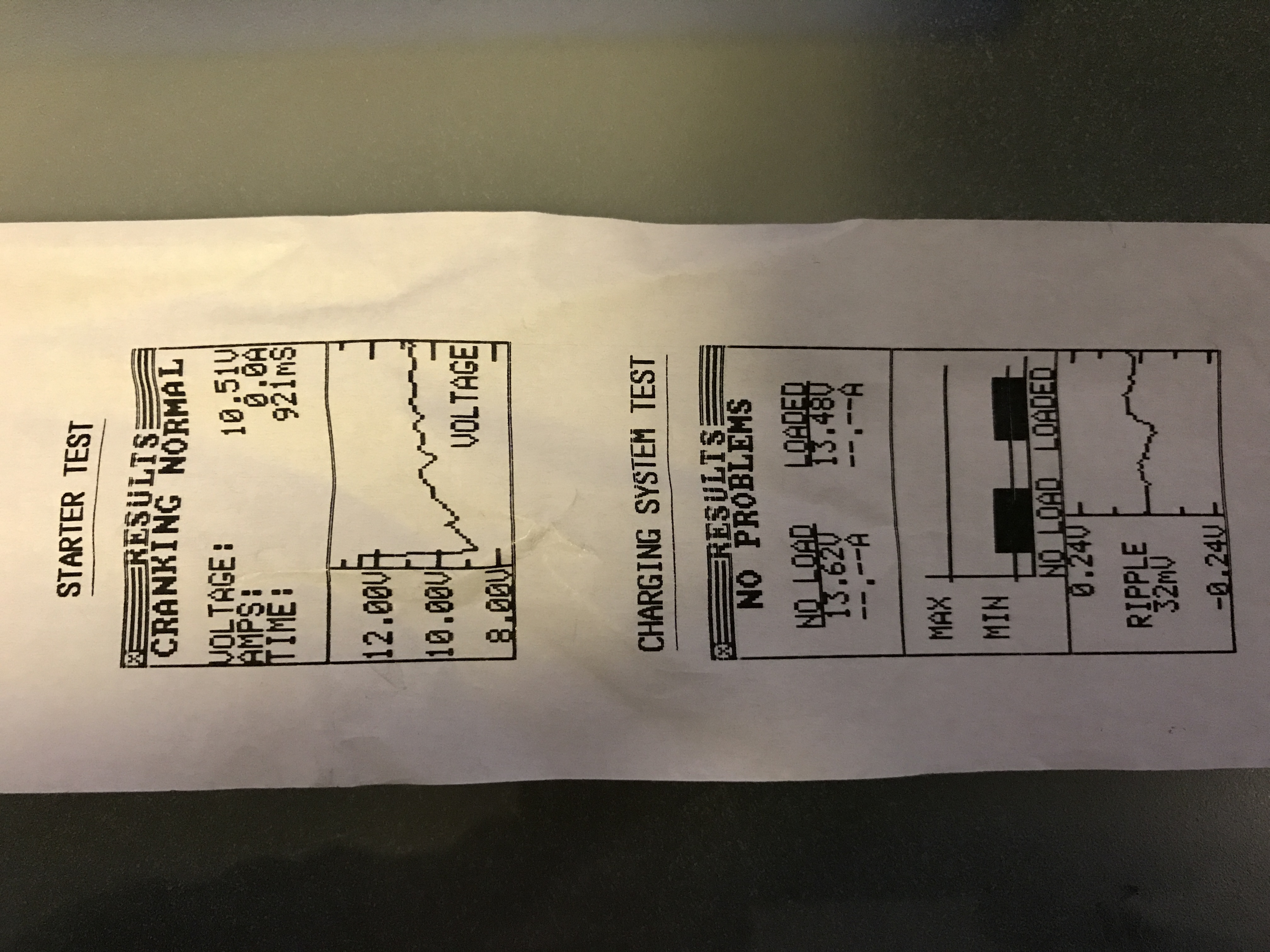

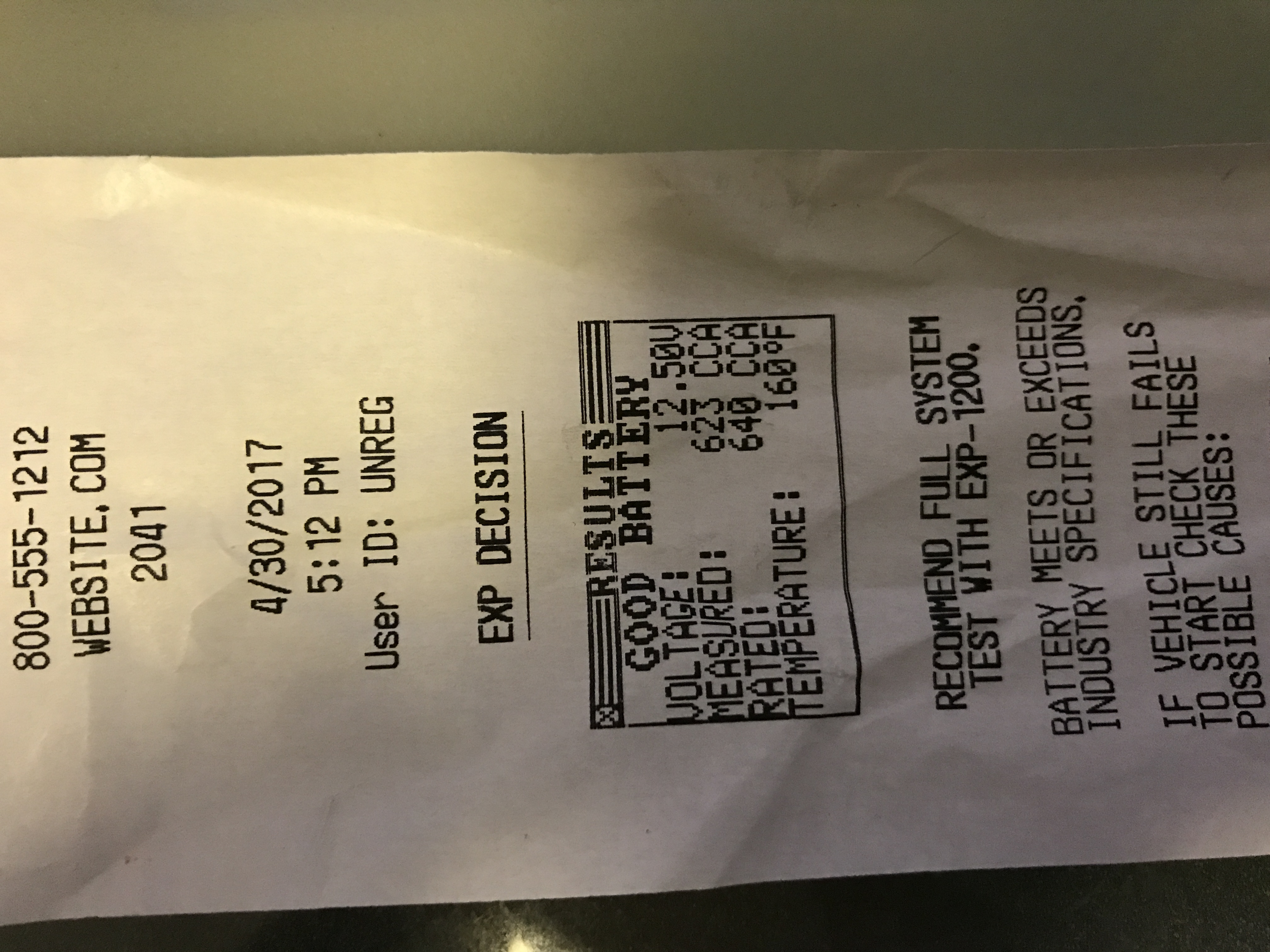

Posts: 24
Originally Posted by crookncastle
test your alternator and load test it. load test your battery, plenty of shi tty batteries being sold by auto parts stores like autozone and oreillys.
I went to Advance Auto Parts and they did a battery test as well as a load test on the alternator. It all seems to be fine according to the tests. I have attached the test results.
The person who performed the tests suggested that it could be parasitic draw and someone who knows how to test for this will have to do it.
Please chime in! Thanks.
