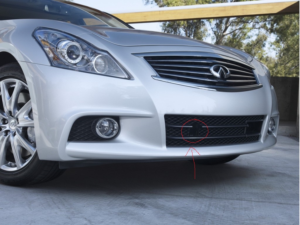

Quick question, I'm trying to get the stillen license bracket for long drives to and from LA, normally I'm rockin no front plate.
Everyone says install is super easy 5 min, but how do you remove the tow hook eye cap cover to screw it in? For the g37 sport bumper there is a black mesh piece on the grill that blocks the entrance of the thread?

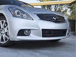

just to be clear im talking about this:
in the picture the tow eye hook cap is already removed
so i just wedge a screwdriver in and it should pop out easy?

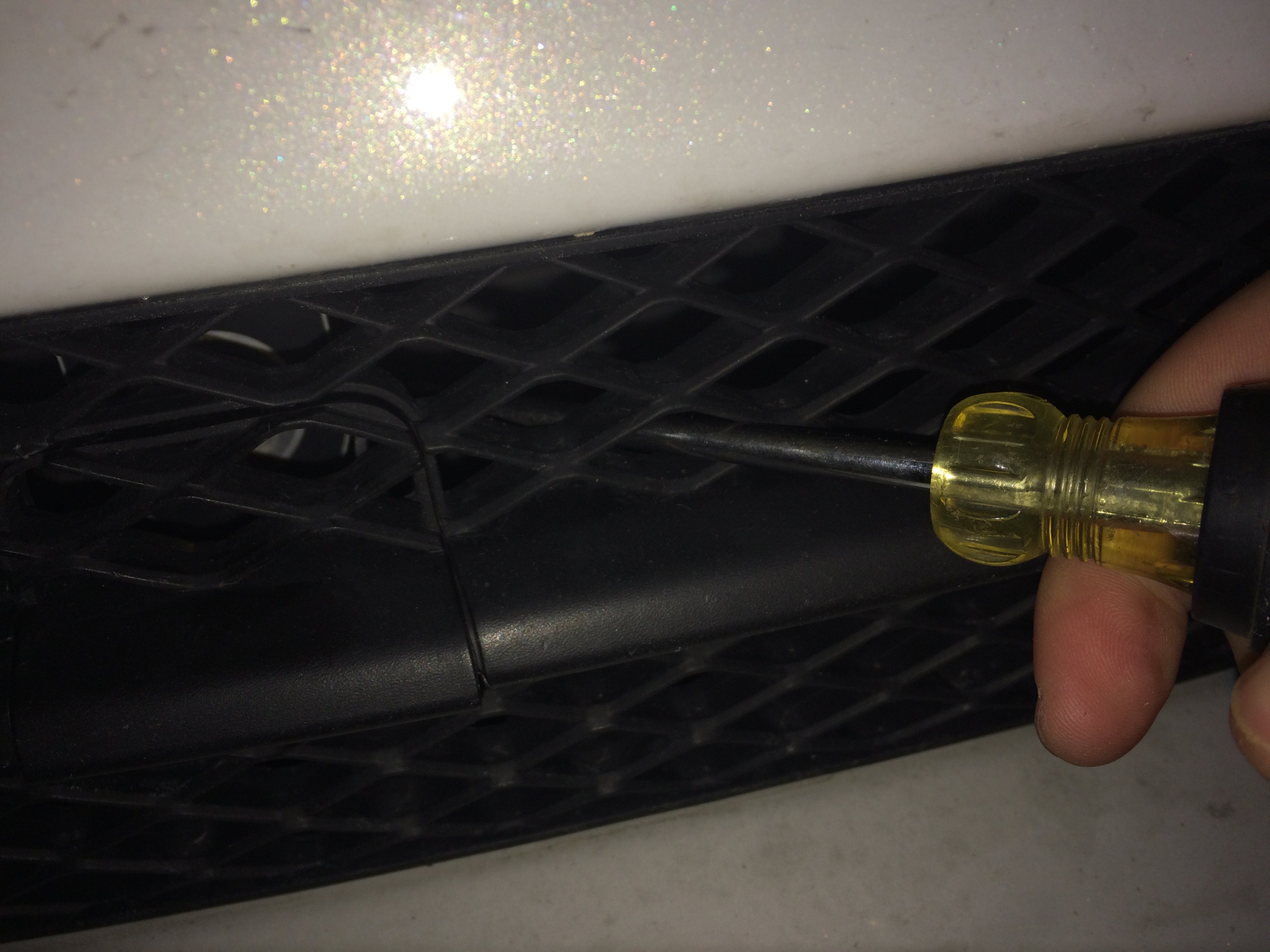

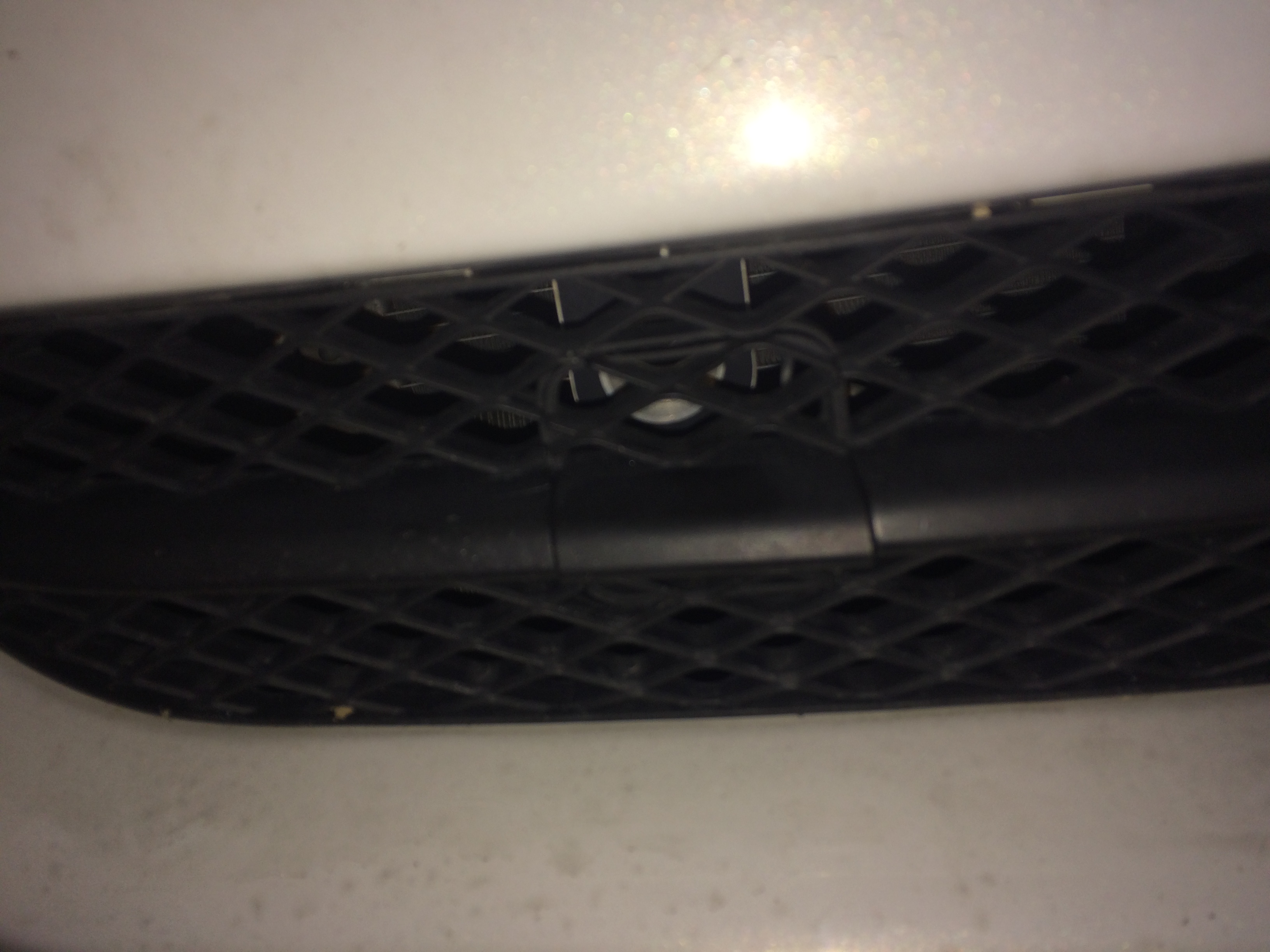

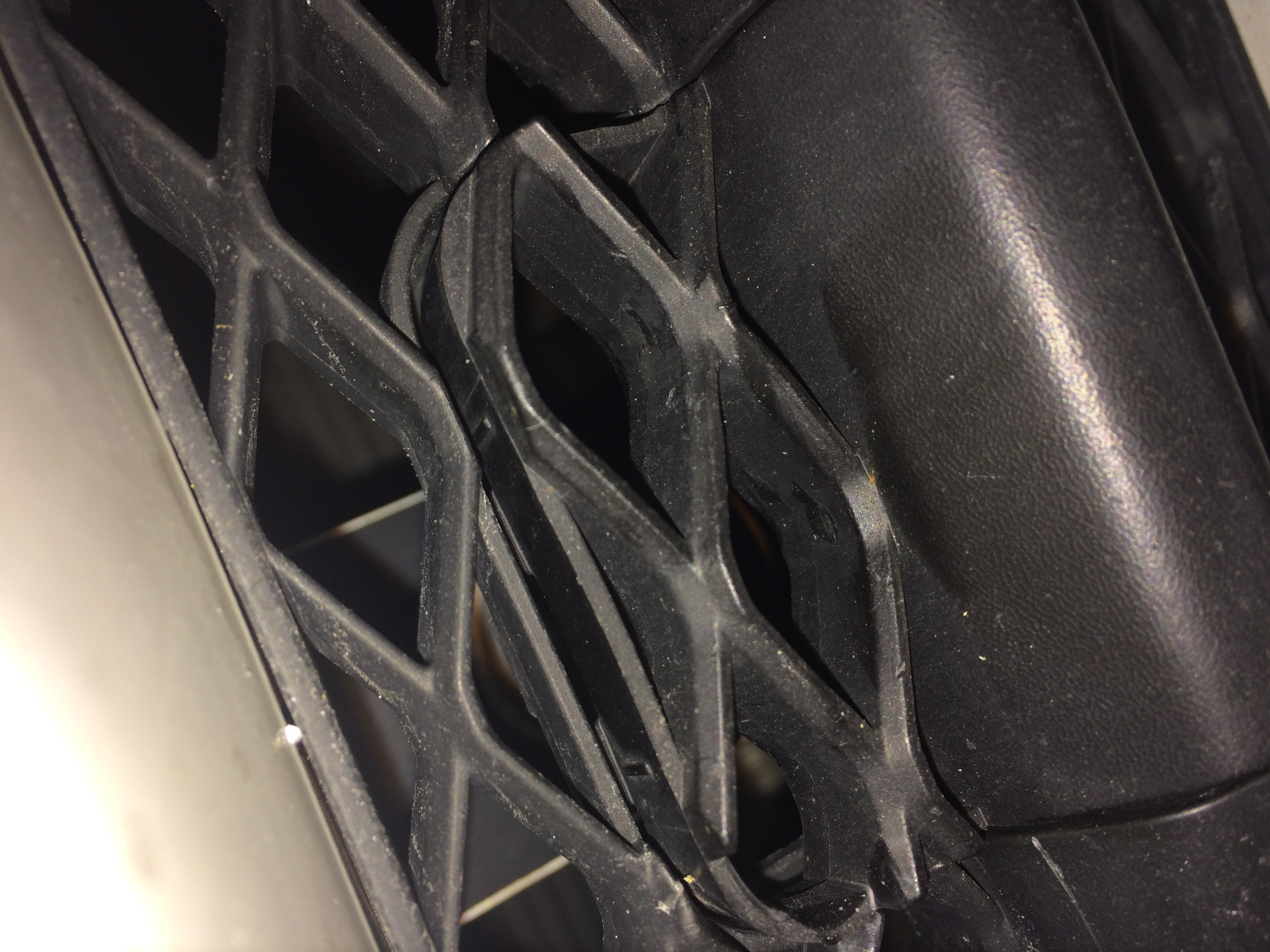

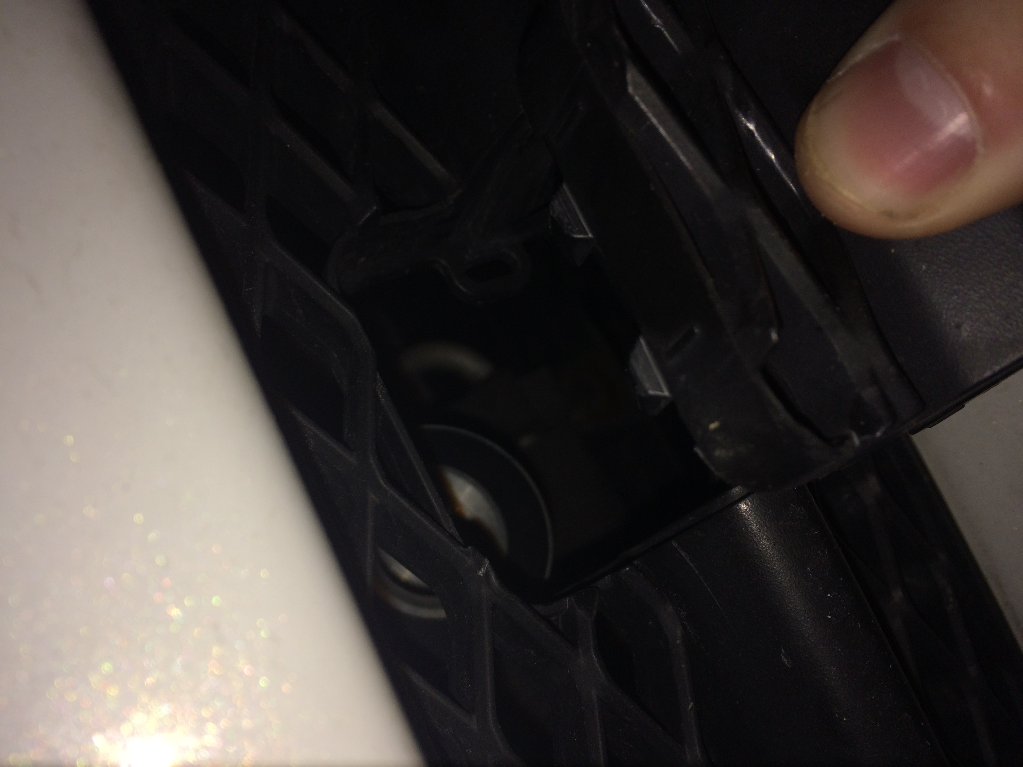

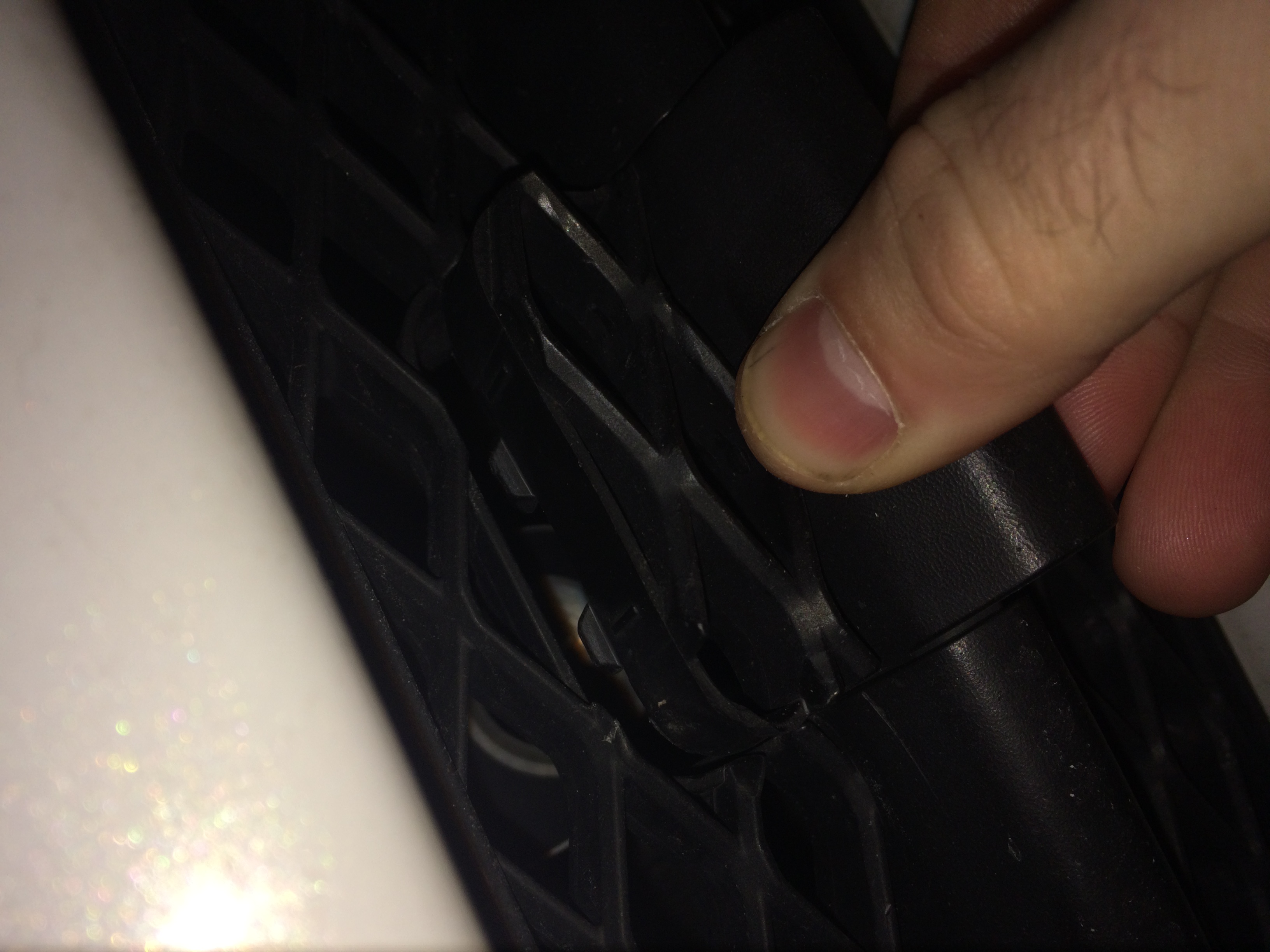

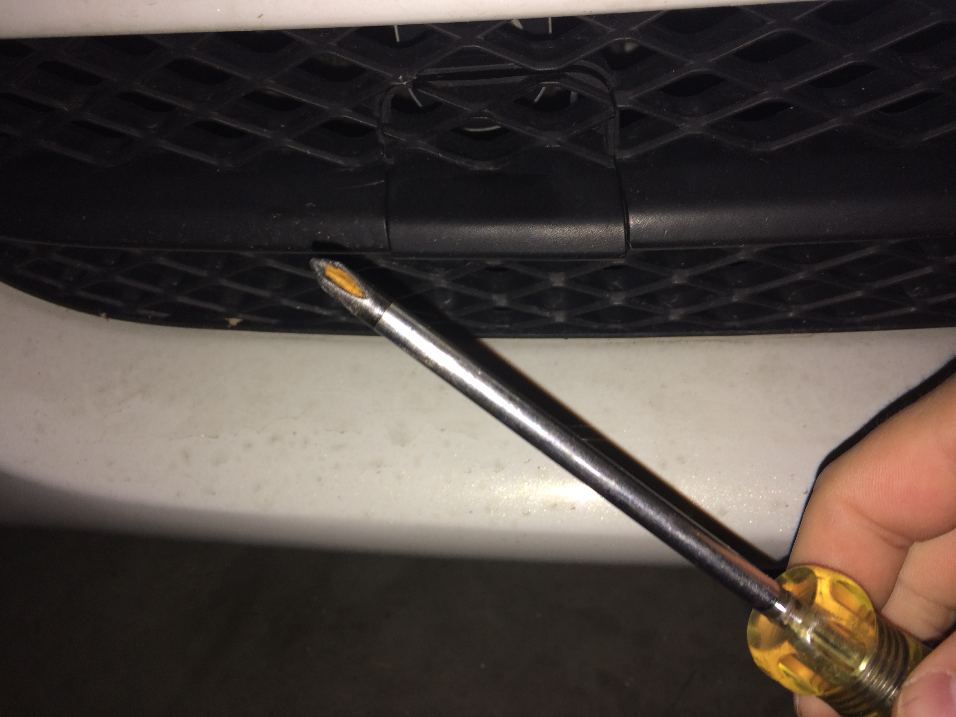

Yup, takes a little bit of a touch. Dont crank but almost "bounce" the screw driver at an angle and work it out.
I just went out popped mine in and took it out in less than 2 minutes. Screen shots attached for reference.
*My insertion of the screwdriver is obviously not in the patch that pops out but you get the idea. Stick it in the center hole of the tow patch and kinda bounce it with moderate pressure and try different angles but it will give
