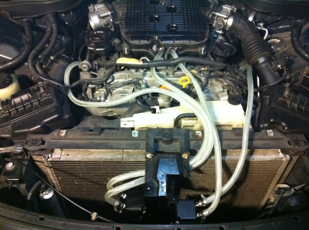

Cover where the hood latch is when you open up the hood.
