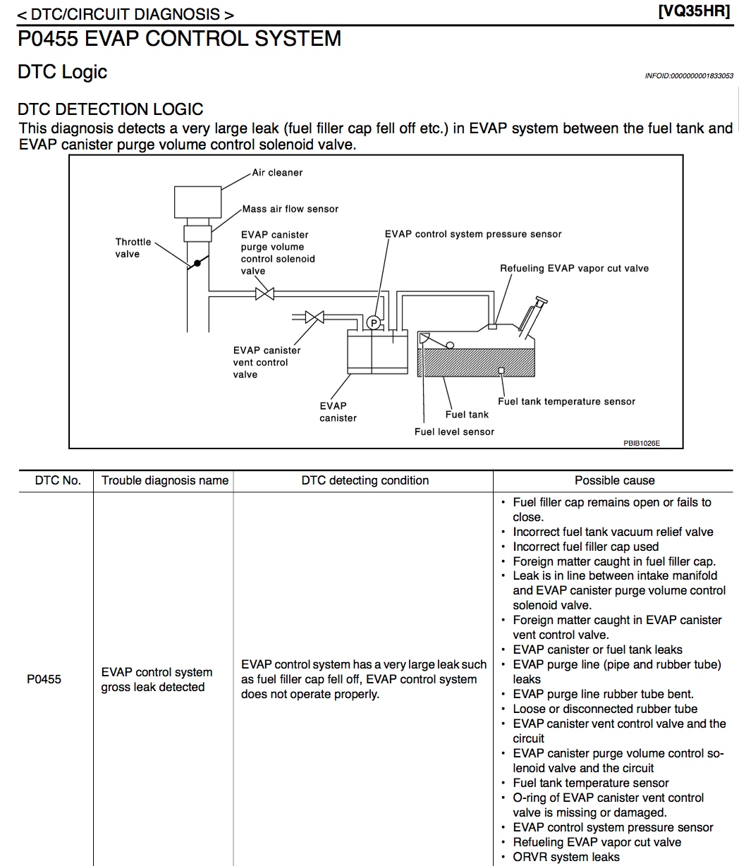

Originally Posted by qmantran
A gas cap would show up as a small leak.
The main reason I asked about the cap is looking up the code shows this:

Just to confirm a "gross" leak can be a missing or defective gas cap.
Evap codes can be difficult to fix, as we don't have smoke machines to help us find the leak.
I need to head out for a few hours, but will type up a few things you can try when I get back, assuming you want to try to troubleshoot this. This code is not one of those "P0xxx = replace xxx"
EC-313 http://www.nicoclub.com/FSM/G35/Sedan/2008/EC.pdf
