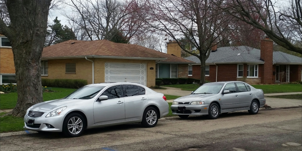

SR20 forever!
Yup, that engine was bulletproof. Was sad to have parted with it, but I wanted AWD.
