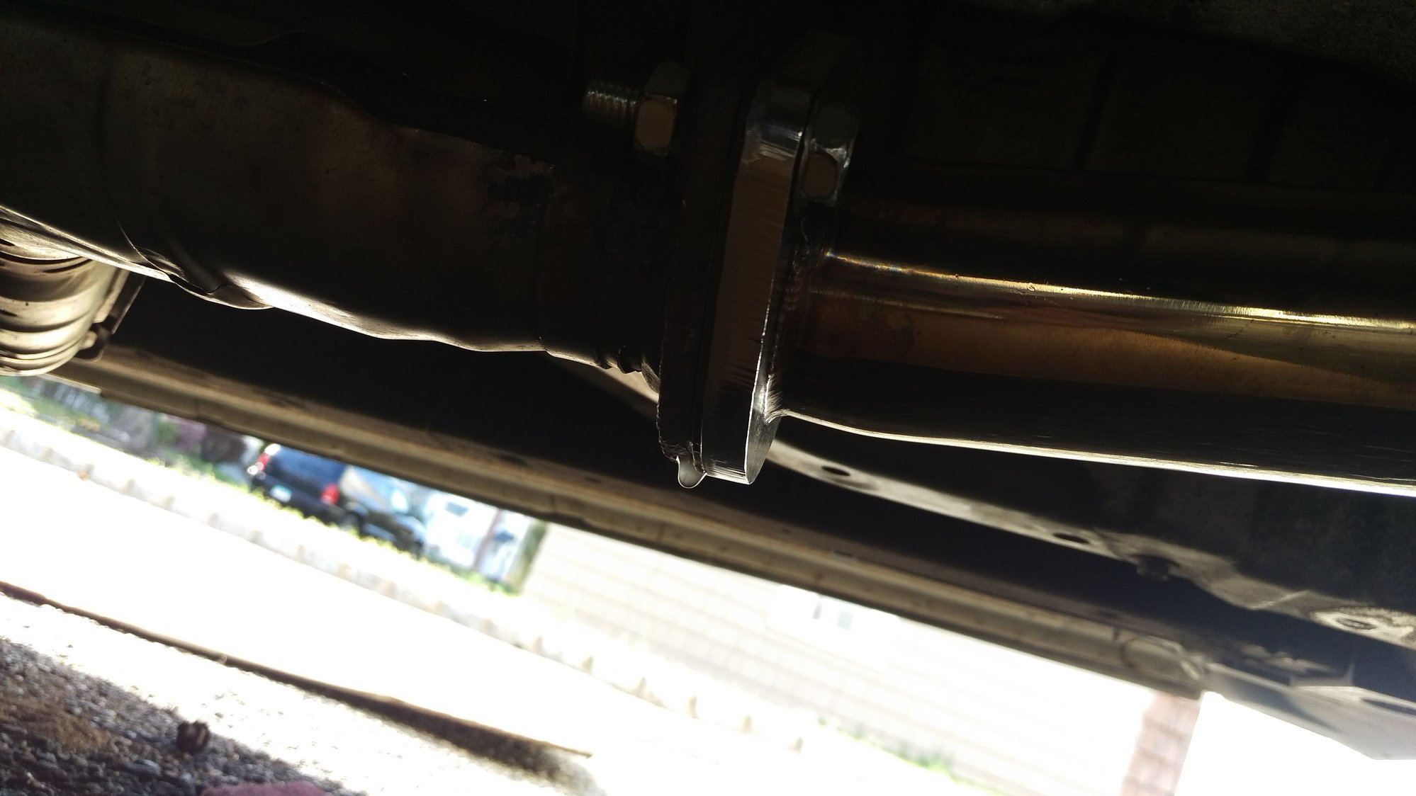

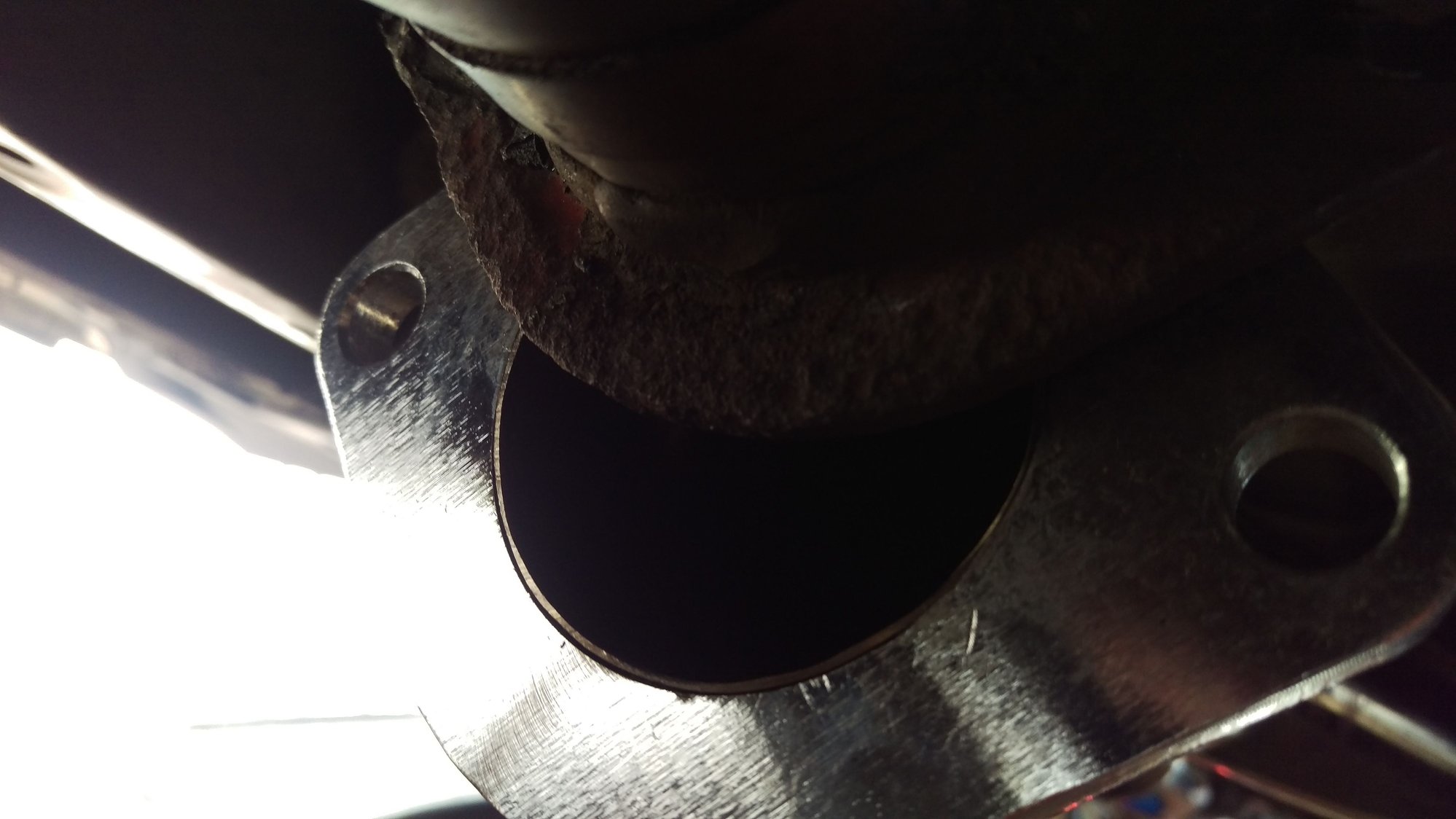

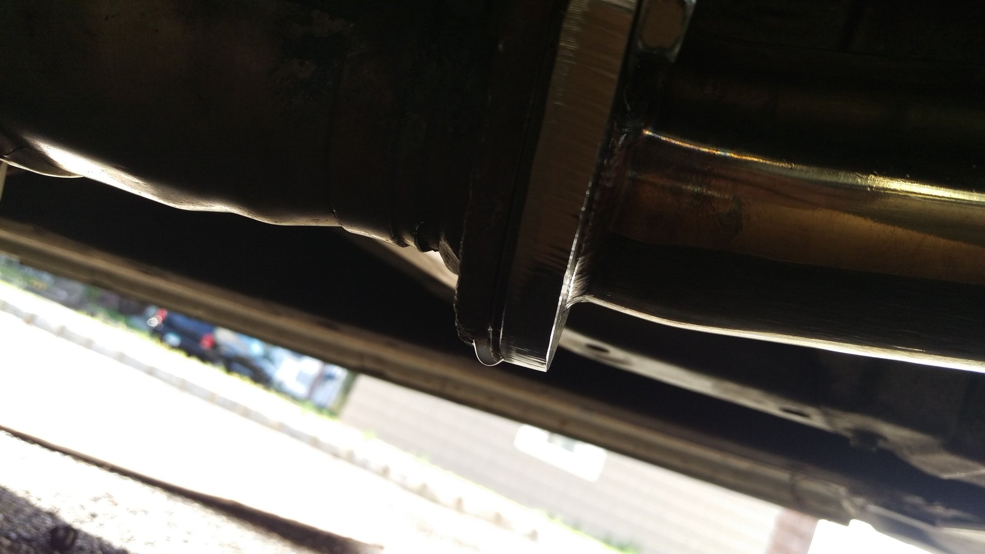

Thanks will try that. How about the water dripping at the mid-pipe and ypipe connection.I've taken them off and back on 3 times and still dripping water. The gasket seems fine.
The pipe inside the midpipe is not even,maybe this is causing the issue(picture2&3)

I wouldn't worry about a small amount of exhaust condensation dripping. Over time rust will fill in the gap. More than likely the exhaust flange is not flat and the gasket can't make a proper seal.

If you can see in picture 2, the midpipe is not even which might be a defect from topspeed. It's also making a hissing sound from that area. I probably just a to a muffler shop and see what they can do.

You might need to apply a thin coat of high temp RTV sealant to both sides of that gasket. You need to apply the RTV, lightly snug the bolts to flatten the RTV, wait an hour then fully tighten it down, should take car of any leak you may have.

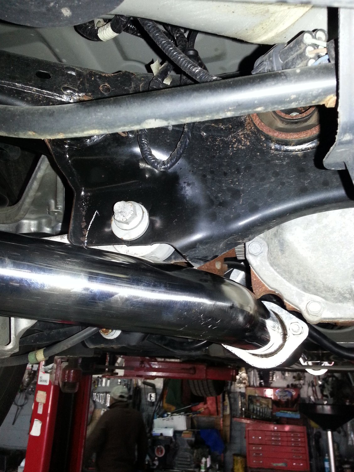

new subsciber here. Just purchased a top speed exhaust for my 2013 g37xs sedan and iam running into the same problems.
The rear section is touching drivers side of the rear end and both pipes are up against rear suspension arms. Readusting did not work also. Probably going to heat hangers with a tourch and try to bend them up to get more clearance.
Top speed guys said it should adjust with out bending nothing and said they might have got bent durring shipping. I dont think so because the box was in good shape. At least there is no exhaust leaks.
Any ideas or opinions would be appreciated.

Flip the midpipe, so the hangers weld point start at the top, it was a better fitment for me, even though topspeed told me the hangers should be at the bottom.

It is hanging lower, but now the rear pipes are not hitting anything in the back, also the flange at the midpipe to ypipe connection is more flush now.

Need to bend hangers
My front y pipe was fine it had about a inch of clearance from the brace.
my problem is the rear section touching the suspension, the hangers are on the bottom.
going to bend hangers when I get a chance. I guess that's why this exhaust was 1/3 of price of a Ark.
