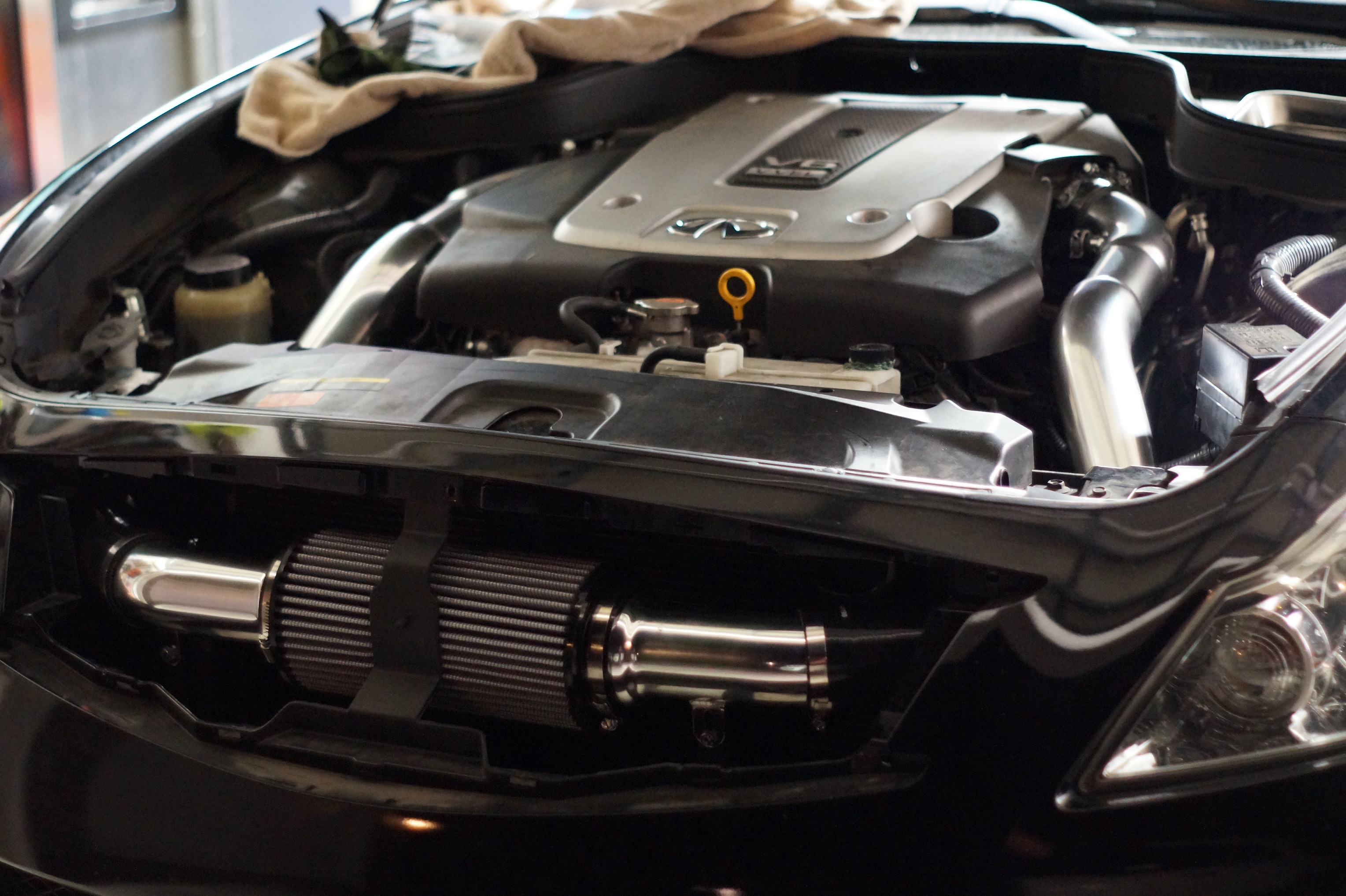

Takeda Long Tube Intake, installed!
IDK how you could realistically do this without A) Dropping the bumper, and B) opening up the intake inlets with a dremel. Sure, you could squeeze them in, but they would be all contorted. It's all plastic that needs trimmed, so it's an easy job.

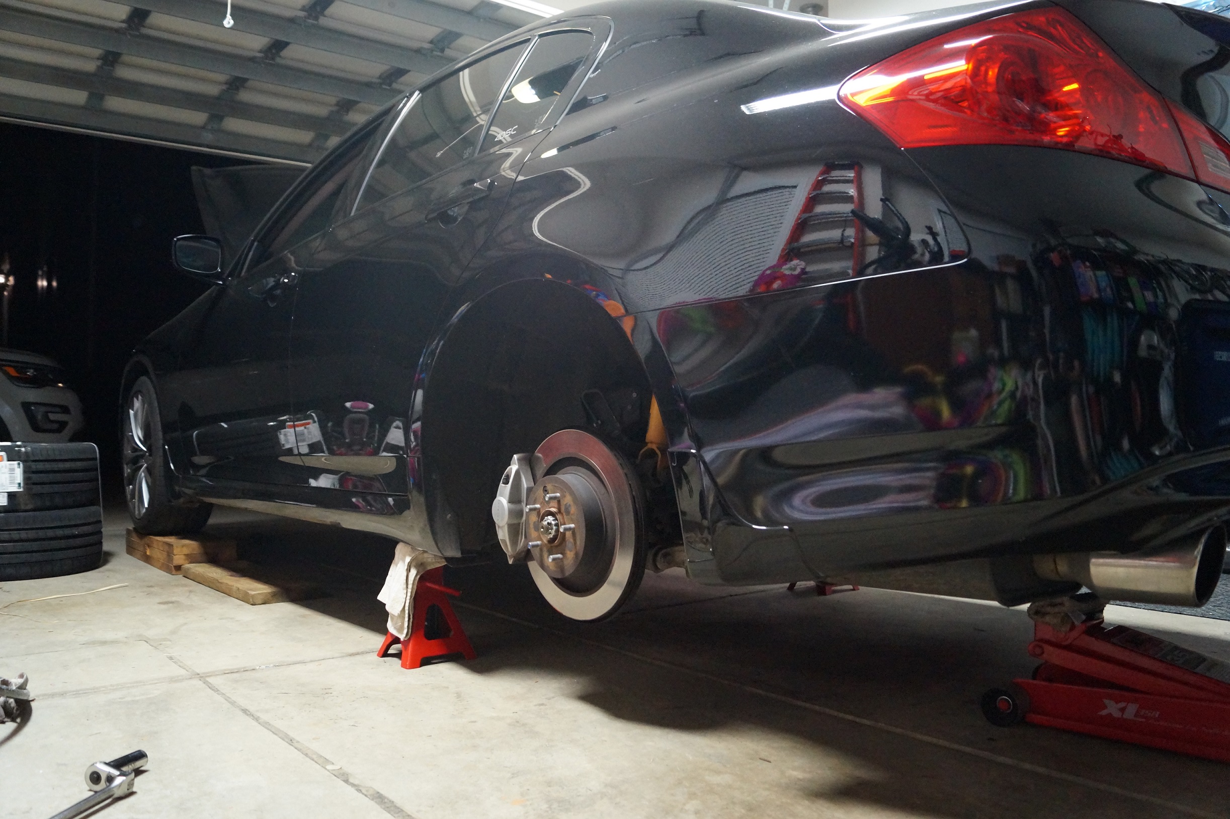

Unfortunately, I can't drive my car, because.....I put the rear up on jackstands and took the wheels off to drop off and have new tires mounted and balanced. We all do that, right? And they couldn't get to it today So, tomorrow by 10:00 AM.

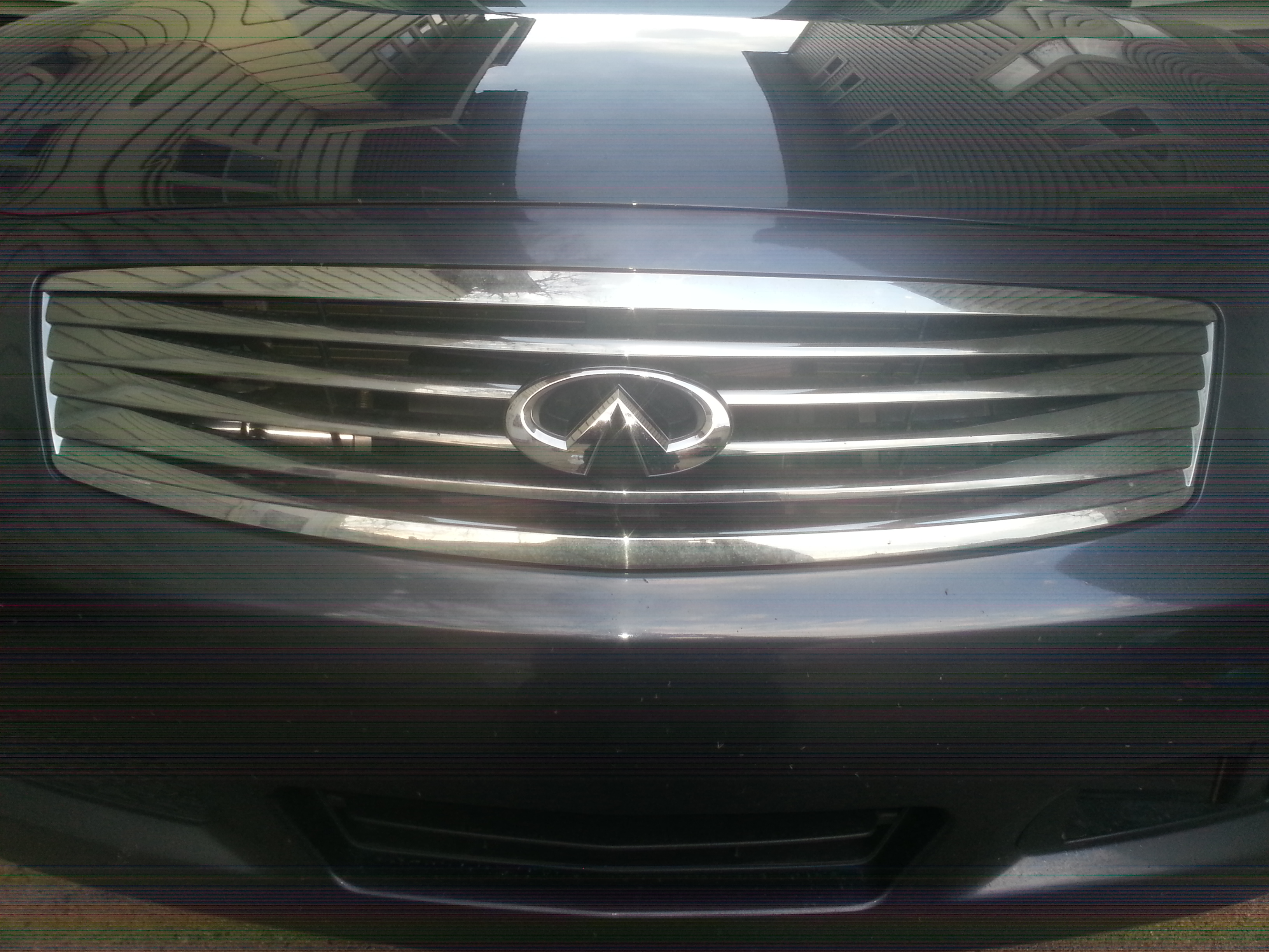

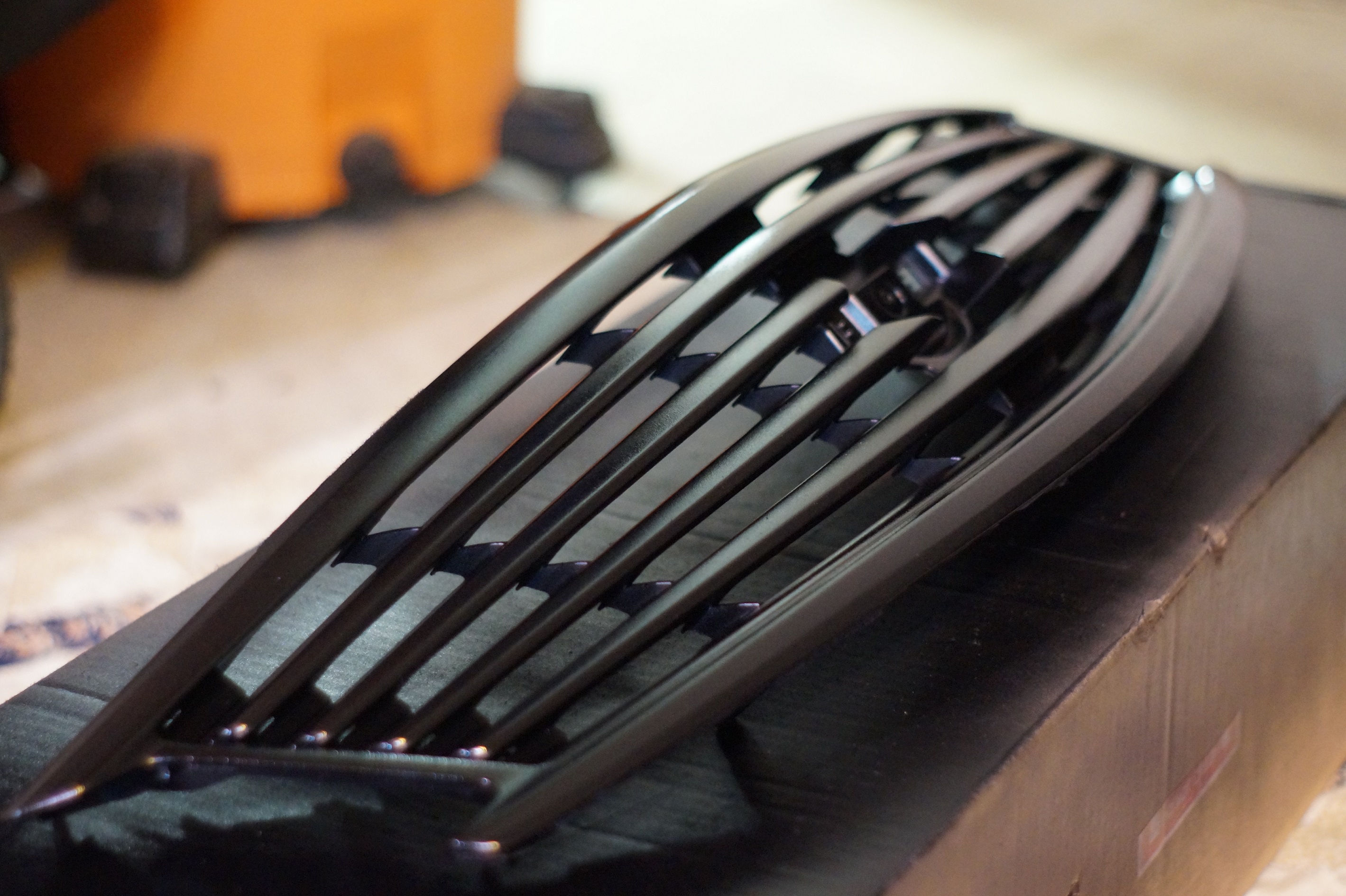

And while I was at it, I painted my grille. I tried vinyl wrapping the chrome on the midnight grille. That wasn't happening. So I washed and sanded down the OE grille, cleaned it up, put 5 coats of primer on, and I'm on my 6th coat of gloss black. Clear coat tomorrow. IDK, I think it's actually coming out pretty good

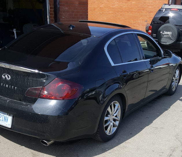

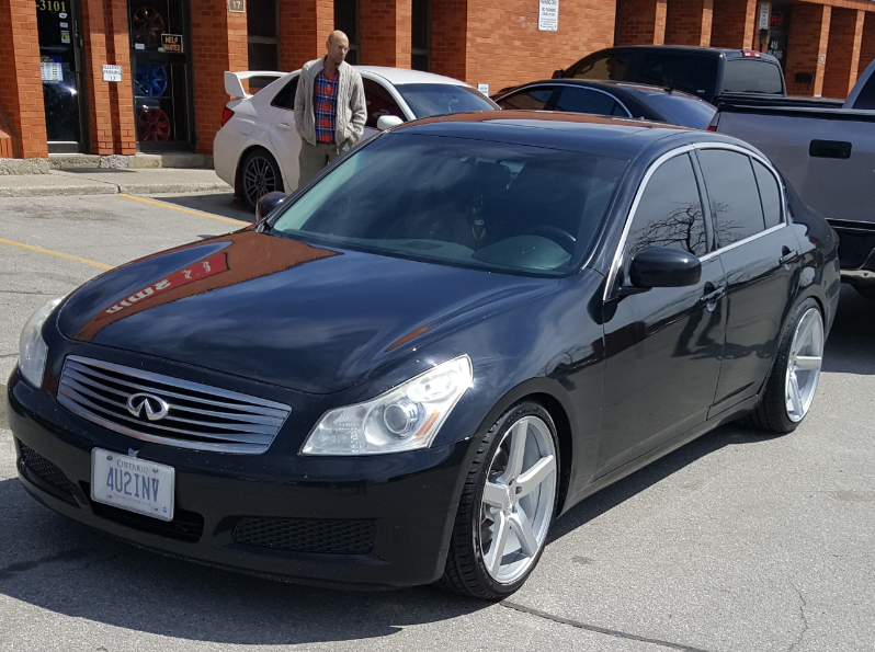

She finally got to put on her shoes today, sorry didn't get time to wash her, she'll be cleaned up after the next project coming in a couple days... getting the calipers and rotors painted

Wheels look great!!

Nice choice Kirtis, what wheel/tire specs are you running and what are you dropped on?

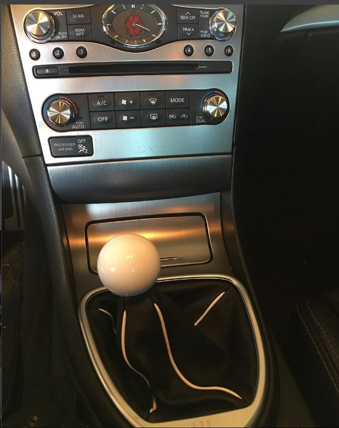

swapped out shift ***** and installed a redline shift boot. finally covering up that monster hole I've had for the last 6+ months.

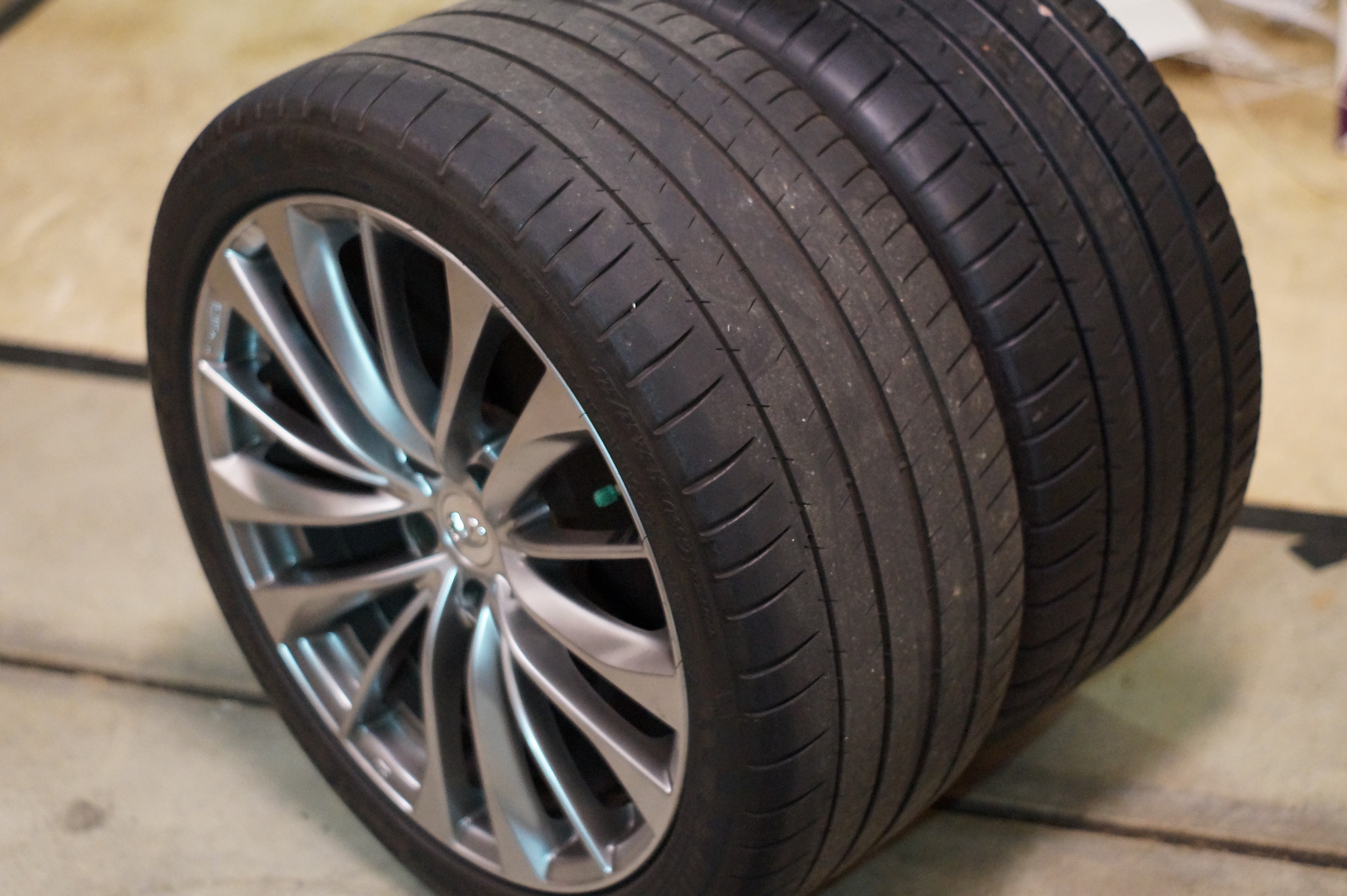

kiseliok let me borrow his vert wheels for a while. They look really good.

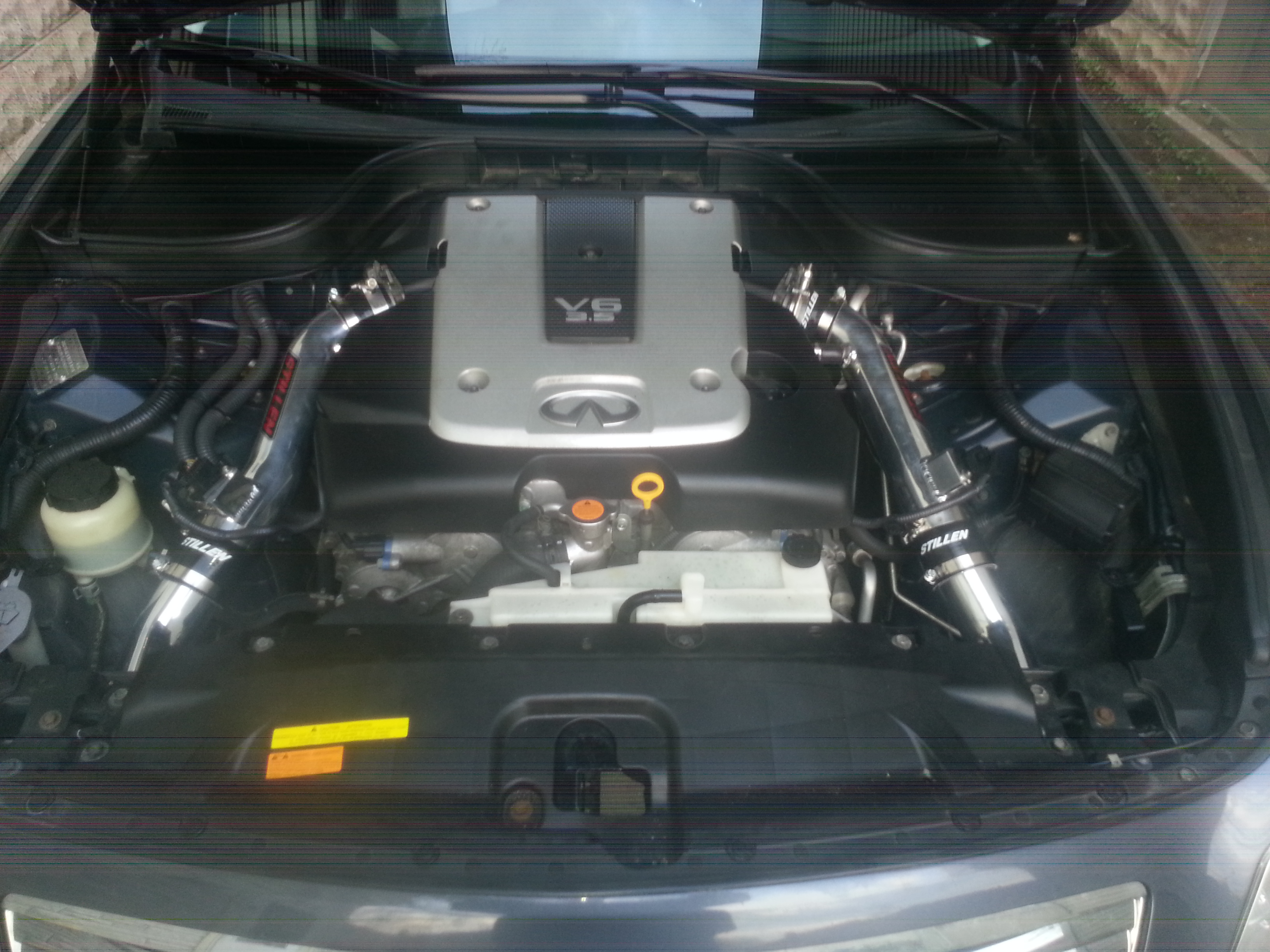

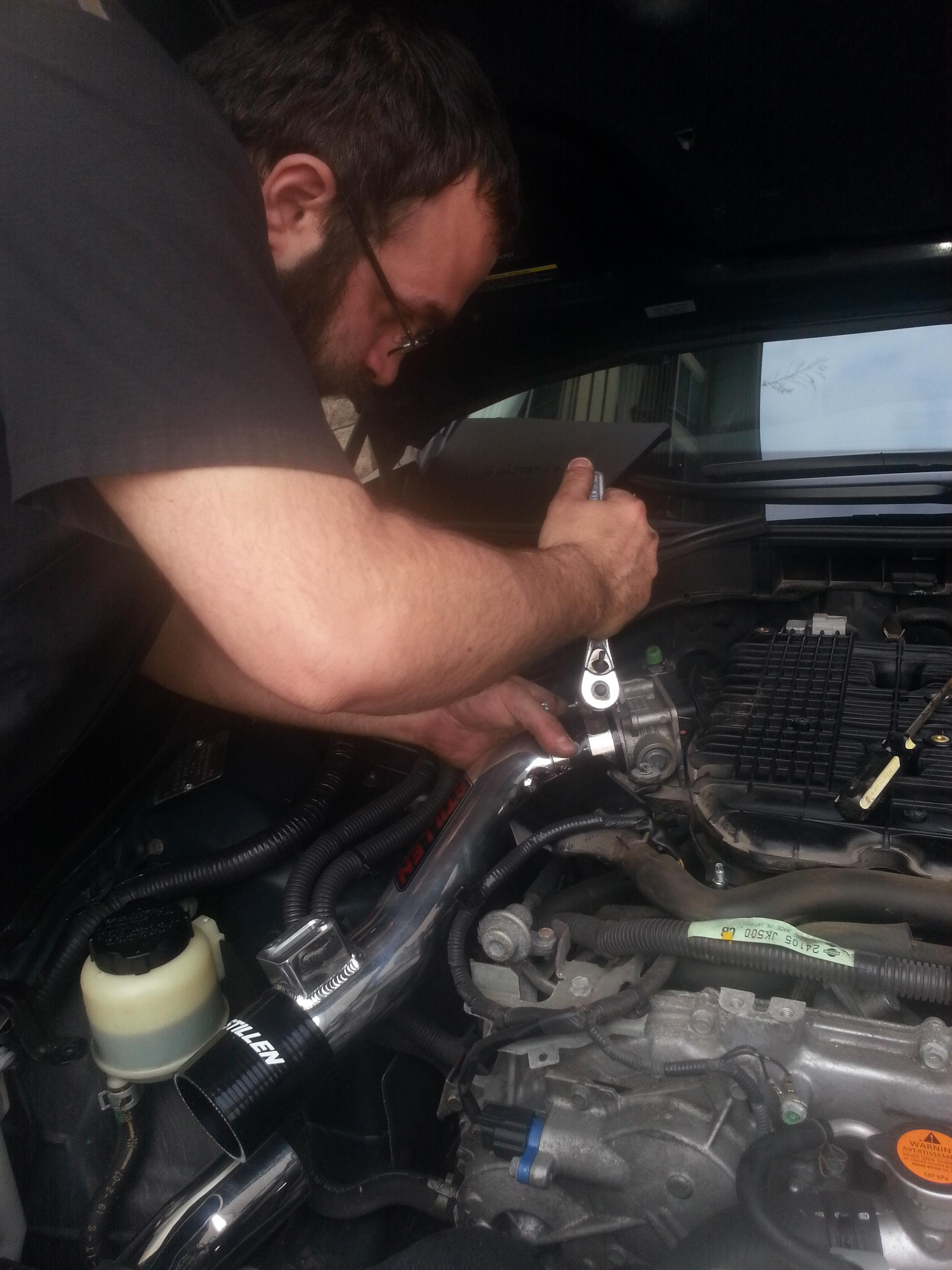

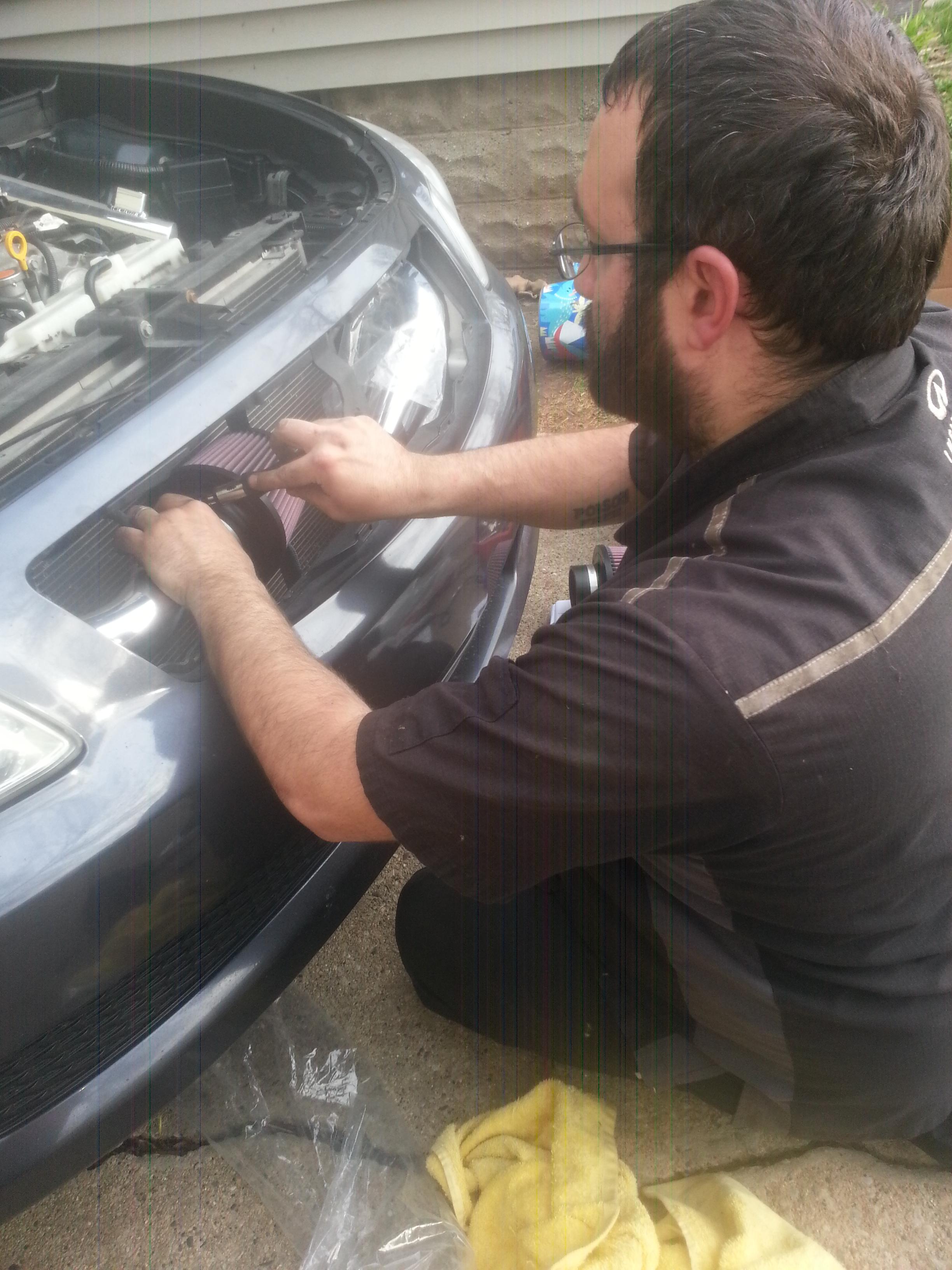

Well this was kind of a pain, but when my dremel bit was staying on that part went smoothly. Believe it or not the clamps were my least favorite part. Took me about 4 hours.

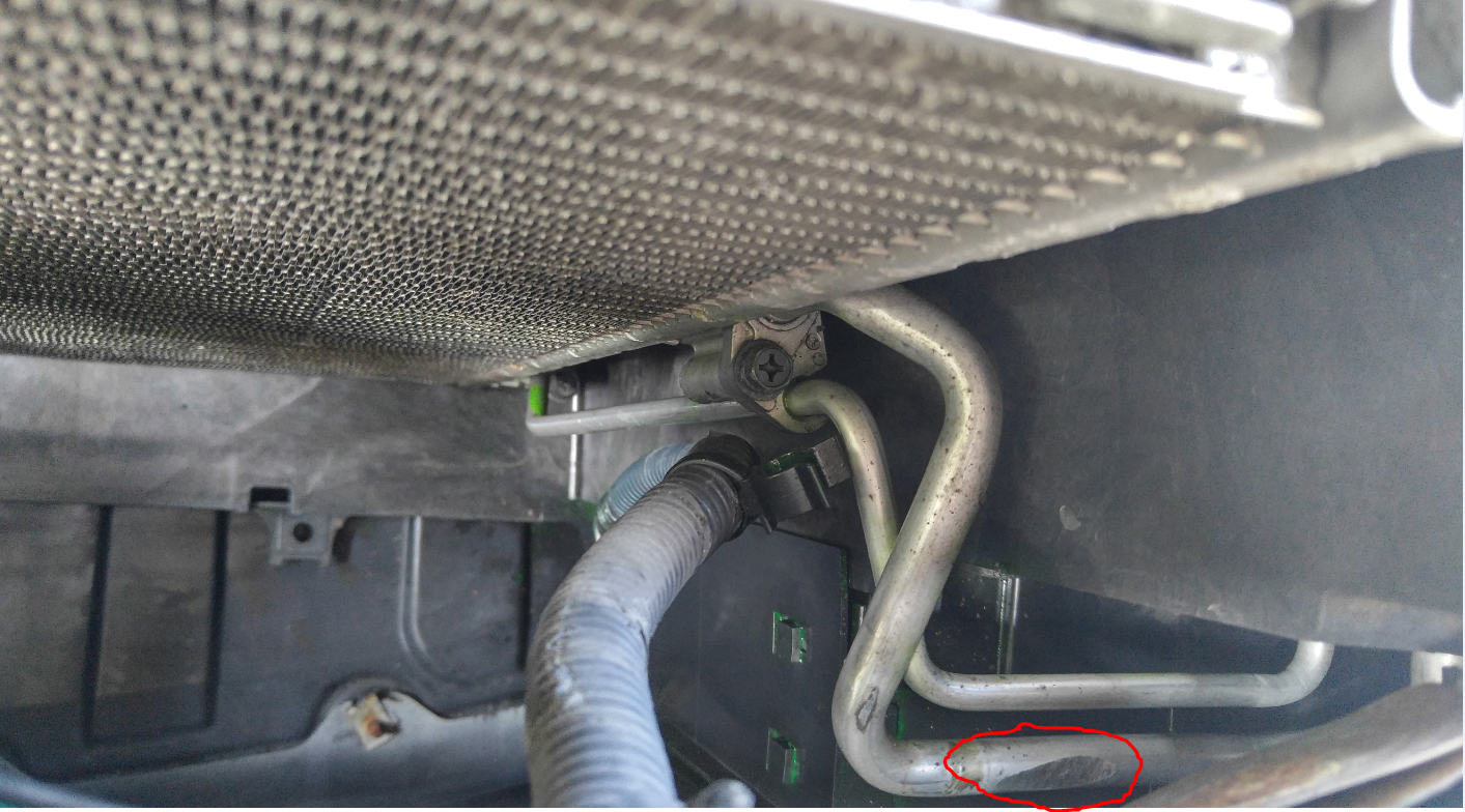

Dont feel bad, thats how long it took to do my first time, also make sure your cold air intake does not rest on AC line which has 2 aluminum hoses, right below right side tube as it passes through the hole you had to open up.
Long story short, after 2 years my intake tube wore out 1 mm hole which leaked out the AC. Replacing it wasnt fun. I still have pic.
The green stuff you see was fluorescent leak tester, **** was expired, while I was looking for leak by spraying this stuff into AC line, gauge blew up and sprayed this expired **** allover my engine bay and me, stuff smelled worst than ****, took me long time to clean it up.

Stillen must have updated since then, they sen't me two hoses that you slit horizontally and cover those tubes with.

Thanks Bro. I'm running Niche Concave Machined Finish, Staggered set-up. 8.5 wrapped in 245/35/20 in the front and 10.5 255/35/20 (stretch so there's no rubbing) in the rear. I'm dropped on Eibach Pro-Kits, everything fits so perfectly, looks like I'm on coilovers.

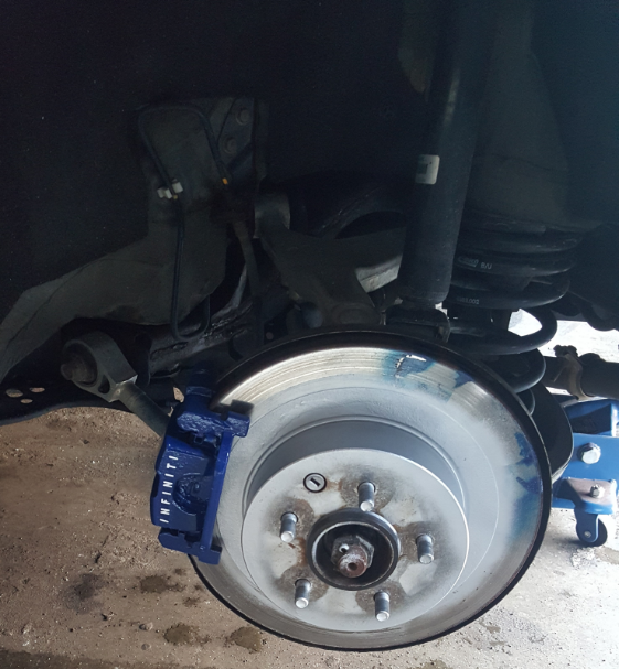

I got my calipers done today, not 100% happy with the shade of blue, wanted it to be a bit brighter, but oh well, next time I guess
Front
Rear

^ holy **** wtf dude.

Please elaborate, tough love is welcome here man Lol
