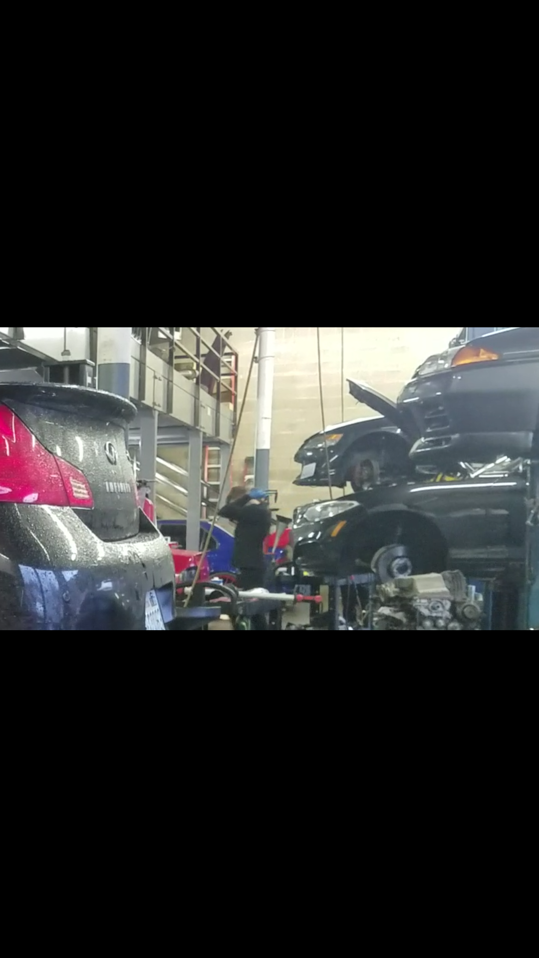

This is another vid of Calvon's G on the dyno. The guy below shows that it was a little loud in there lol.

Old Feb 7, 2018 | 12:02 AM

Lmao it’s not that loud
Myself and the young man on the video say otherwise lol
