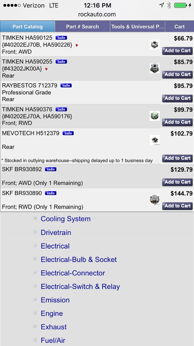

Originally Posted by Infiniti7
whats up guys
I am about to order some parts off rock auto and it gets a bit confusing as far as which exact part to order since there are multiple ones to choose from. I have a 2009 G37xS and I am in need of both front wheel bearings, front left control arm and brake pads. I know I asked earlier in this thread but i was wondering if somebody could help me out and guide me to the exact parts because I honestly don't know which ones are the best to go with.
This is what infiniti gave me for part numbers but cannot seem to find them on rock auto:
Wheel Bearings- 40202-4GE0A
Front left control Arm- 54501-1NA4B
thanks
Coupe or sedan?

Never mind checked the thread here you go. The first one you need two of them.
