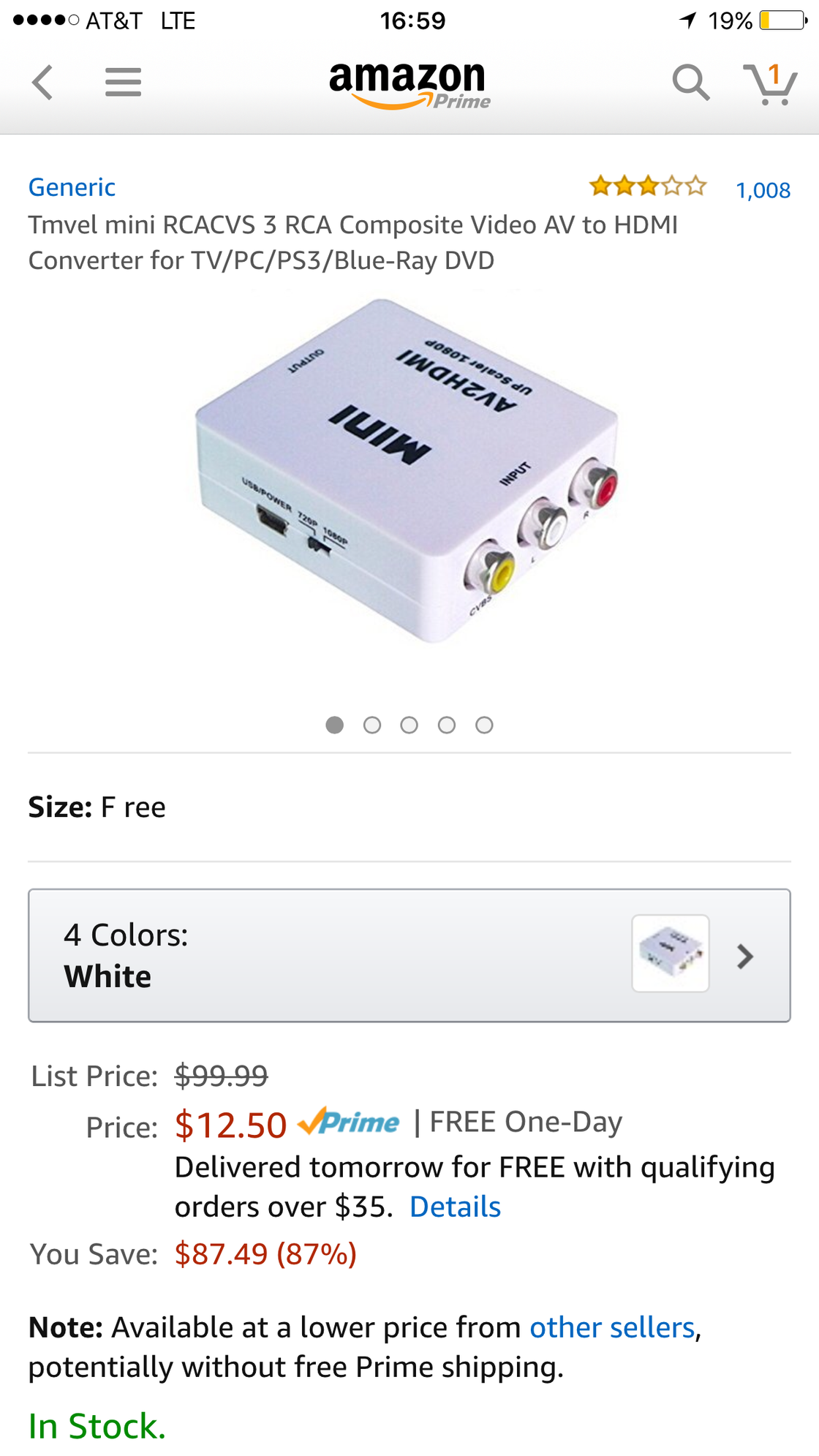

I installed this a couple of weeks ago and I'm very happy with it. Ran all the wires through factory holes/rubber tubes. I'm very pleased with it. I'll put up the entire install later but as far iphone mirroring, here what you'd need plus av cables and a short hdmi cable.
I already have this set up for my aux inputs (one major benefit of having a pre-2010 G) in the center arm rest. I'm using all three aux input since the stock aux has video and audio connection but the naviks only has video, however that's no problem since you can use Bluetooth to get the sound.
naviks actually sells this, but with a huge mark-up in price and no other necessary cables.
I'm not totally sure if this works better but don't expect anything revolutionary in terms of screen resolution as this is all going through av cables but I use it to watch anything I want on my screen as well as the Waze app.

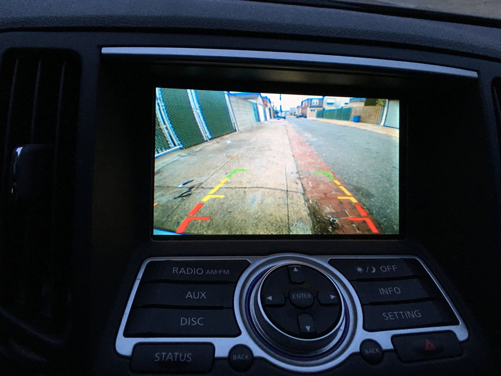

Oh and the naviks main unit has two av inputs and comes with three cables, two of which are connected to a switch for av 1 and the other is a single wire for av 2 which I used to tap into the reverse lights so av 2 turns on when that cable receives 12v. If you have the rear camera you could potentially add anything you want to the second av as well as another switch giving you the the ability to go between the stock screen and two av inputs.
Here how my rear camera looks
Personally I'm very happy with it and it's virtually all plug and play, aside from tapping into a 12v source and ground

I have a 2009 g37 sedan so if I purchased the things you have hear from Amazon I would be able to mirror my phone?
