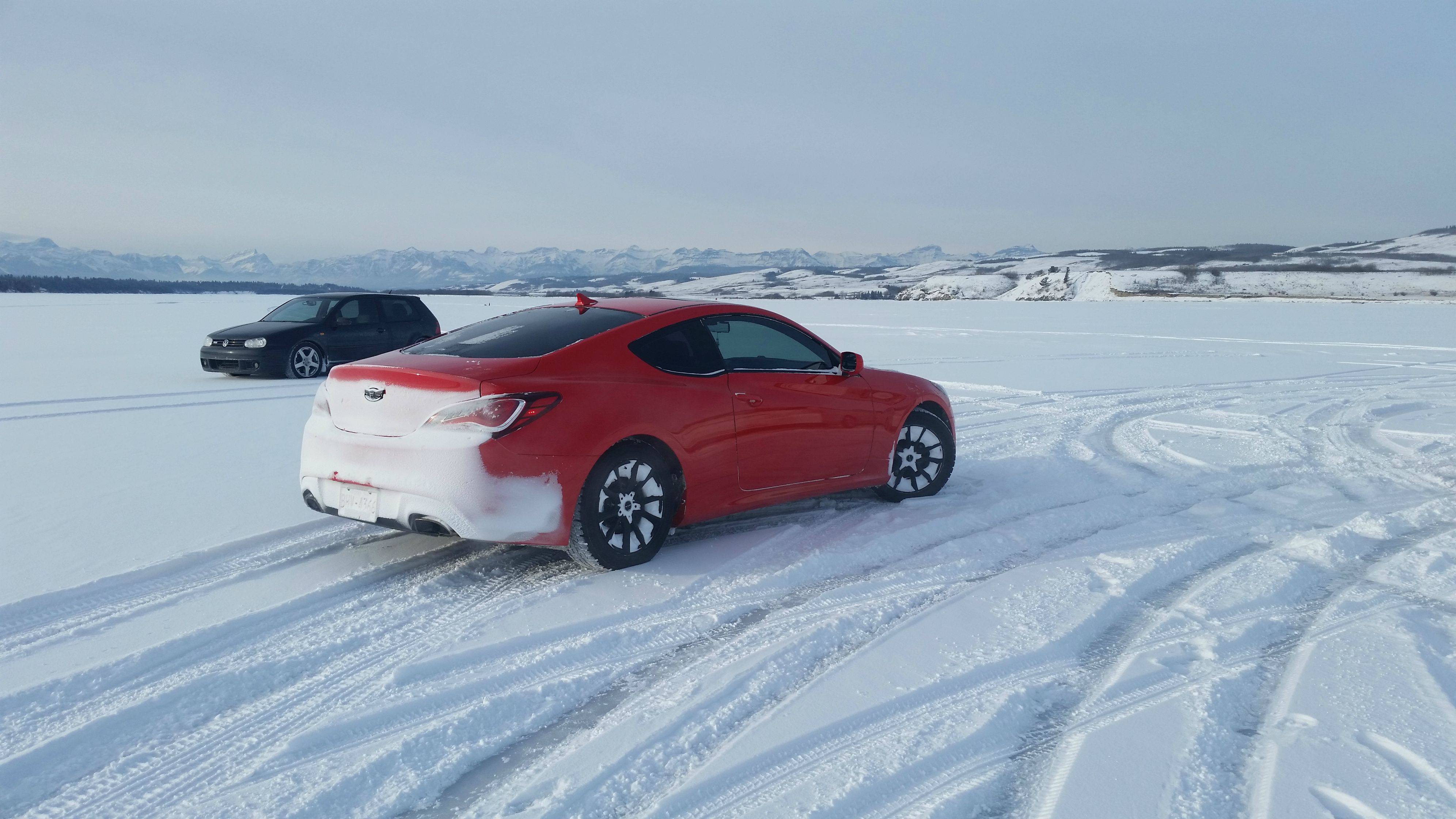

Agreed on everyone else saying you'll be fine, I spent the last couple winters in different RWD cars and good tires without too many problems.
Originally Posted by PG-v36_6MT
RWD in the snow? No problem
Different car, but here's my RWD mountain pic from a performance winter driving course done on a frozen lake last winter.
