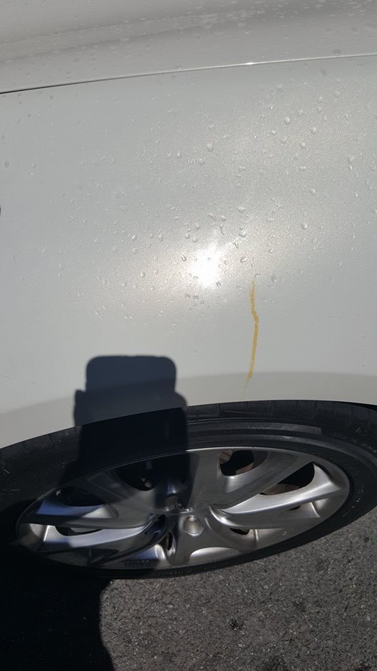

Hey everyone, I'm new to this site but I searched for this topic and didn't find any help. I woke up to my car having this bad oil stain and when I wiped it off clean it left back this yellow stain on my white paint. I used cleaners and clay bars and it didn't help, any advice?
Attached Thumbnails Bad Yellow Oil Stain-11824120_10153449080068936_1557653031_n.jpg
Probably etched into the clear coat similar to what bird droppings will do. Probably have to get some compound followed by polish and a final wax.

Hey thanks a lot for your response, I'm freaking out about that stain, I'm going to buy some of those products and check it out today.
I've been happy w/ Maquiars Ultimate compound, you can give that a try w/ a quality microfiber towel or sponge (dampened first) and you may be able to go straight to wax depending on how much compounding you end up doing. If you do need a polish the Maquiars Ultimate polish will work well followed by their Carnuaba wax.
