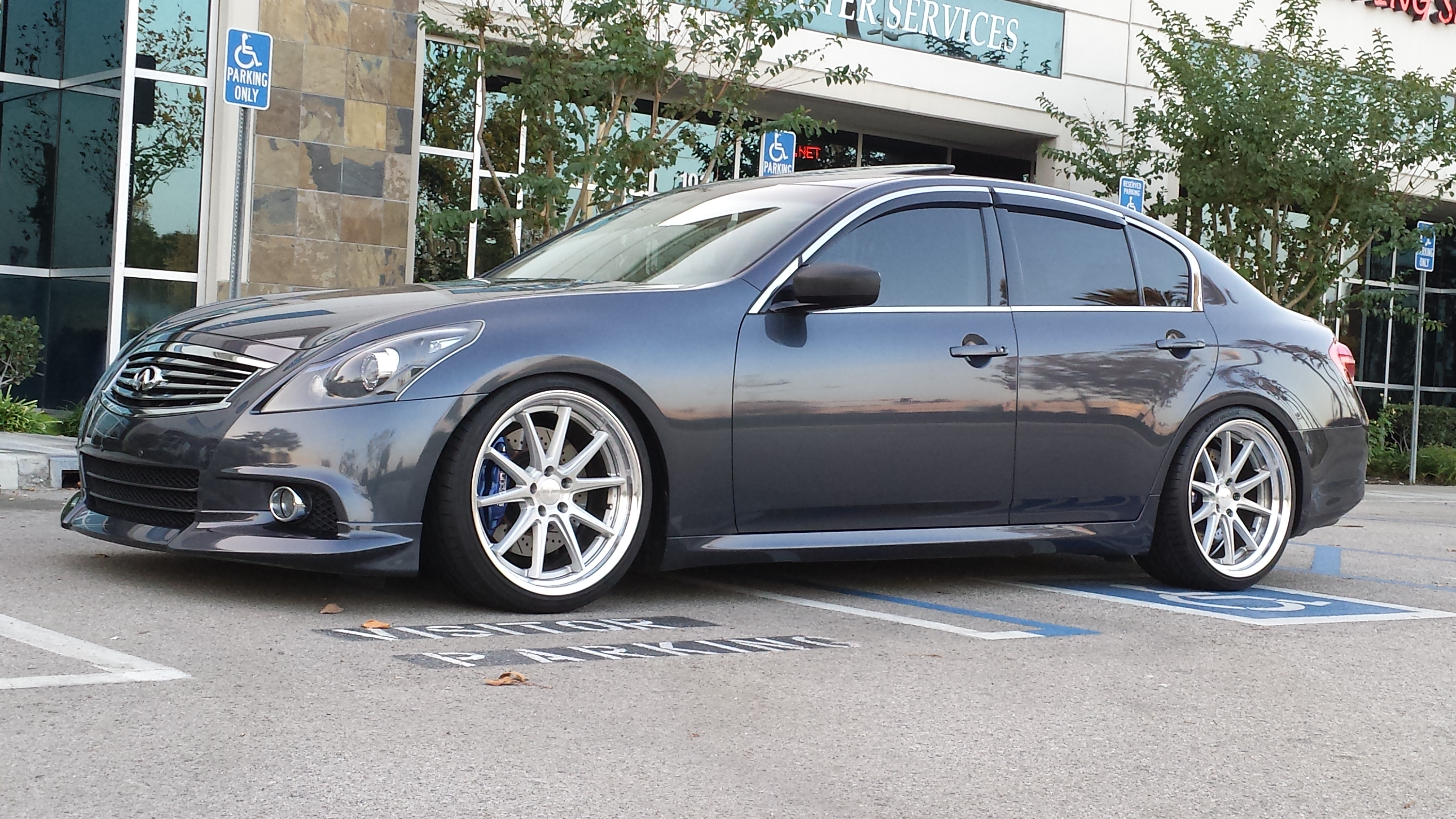

BTW guys this is the stance I am wanting. I know I don't have a Sport and I am not sure if he has 20"s but this is the look I am going for.
Who ever this car belongs too- to you.
Thanks

Nice look, that's about a 2" to 2.25" drop all around, so you're almost back to those H&Rs, lol.
Yeah, that's pretty low. Easily a 2" drop, and not something I want. Fortunately for the OP, those CO's will allow him to dial it in wherever he wants.
BTW, that's Lorenzo's car... parked across no less than three handicapped spots like a boss.
Zoster is bagged, isn't he? Totally different ballgame.
