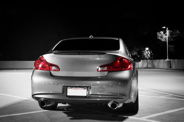

Here's how mine came out. You can't see any residue whatsoever (car has 24k miles). I'm probably going to add a new Mt Fuji emblem to the back, relocated to the middle, but I'm rocking it naked for now.

I just used waxed dental floss and goo gone, then cleaned, clayed and polished the area with Meguiar's stuff. I'll give WD-40 the next go around if I decide to black out the emblems.
Here's a pix after debadge and getting bigger exhaust tips installed
