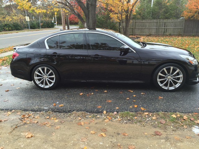

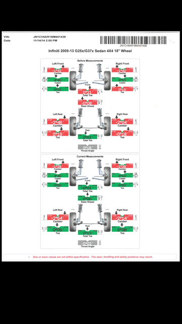

I have a 2011 g37xs and I used the same eibach kit. I'm using spc rear camber arms and toe bolts. Give me some time and I'll upload an alignment sheet and a pic.
As you can see the drop isn't that deep, also the alignment sheet is with stock camber arms/toe bolts.

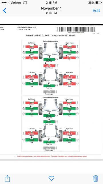

Here's the alignment with spc rear camber arms and toe bolts installed.
I don't think the guy at the dealer knew exactly what he was doing since he test drove my car twice and commented on how hard it was to loosen the camber arms. Thought that was weird seeing as how I had them installed about 20 minutes before going to get the alignment. All in all my tire wear has been nice and even.
Old Apr 22, 2015 | 07:22 PM
I think I would try another shop though, they should be able to get that camber easily in spec w/ those SPC kits. Nice to hear you're not burning through tires though.
