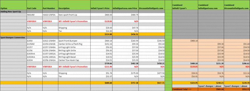

Hey guys I recently started throwing the idea of changing my base non sport front bumper to the much more attractive sport front bumper. I was wondering where I could purchase a sport front bumper, how much it would cost to purchase and if I would need to have the bumper color matched to my moonlight white paint.

I, and many others have completed this upgrade. You'll need to reference this thread here:
https://www.myg37.com/forums/g37-sed...onversion.html
Also I have attached this spreadsheet detailing the parts you need for the upgrade. I pulled the image from my post in the thread above. If you can't read something on this spreadsheet, reference the original in the link above.

Sedan and I am located in Long Island, NY
Attachment 107899
Thank you very much!
