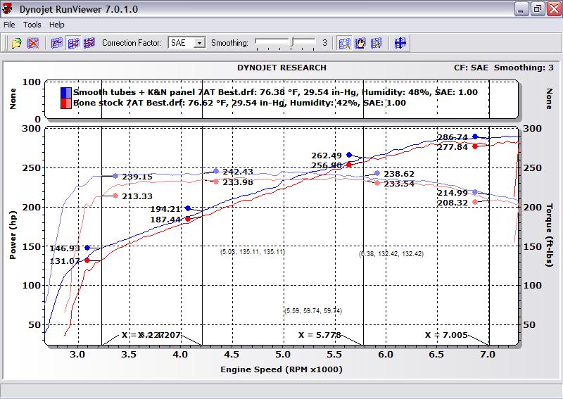

I understand your point on the intake, but it's dyno proven that stillens Gen 3 makes very good power. Also i'd like to see dyno results of your intake vs.a gen 3. if you are right I'll be surprised, but please real dyno charts because I didn't find any. I don't like spending $500.00 on a CAi I thought it was too much, but I wanted the best intake I could buy and that seemed to be the best hands down.
https://web.archive.org/web/20090228...ing.com/?p=160
Dyno from a 370Z attached.
Nothing wrong with the G3, I'm sure they sound bad *** too, but you can get a majority of the gains for a fraction of the price and not have to cut the bumper.
