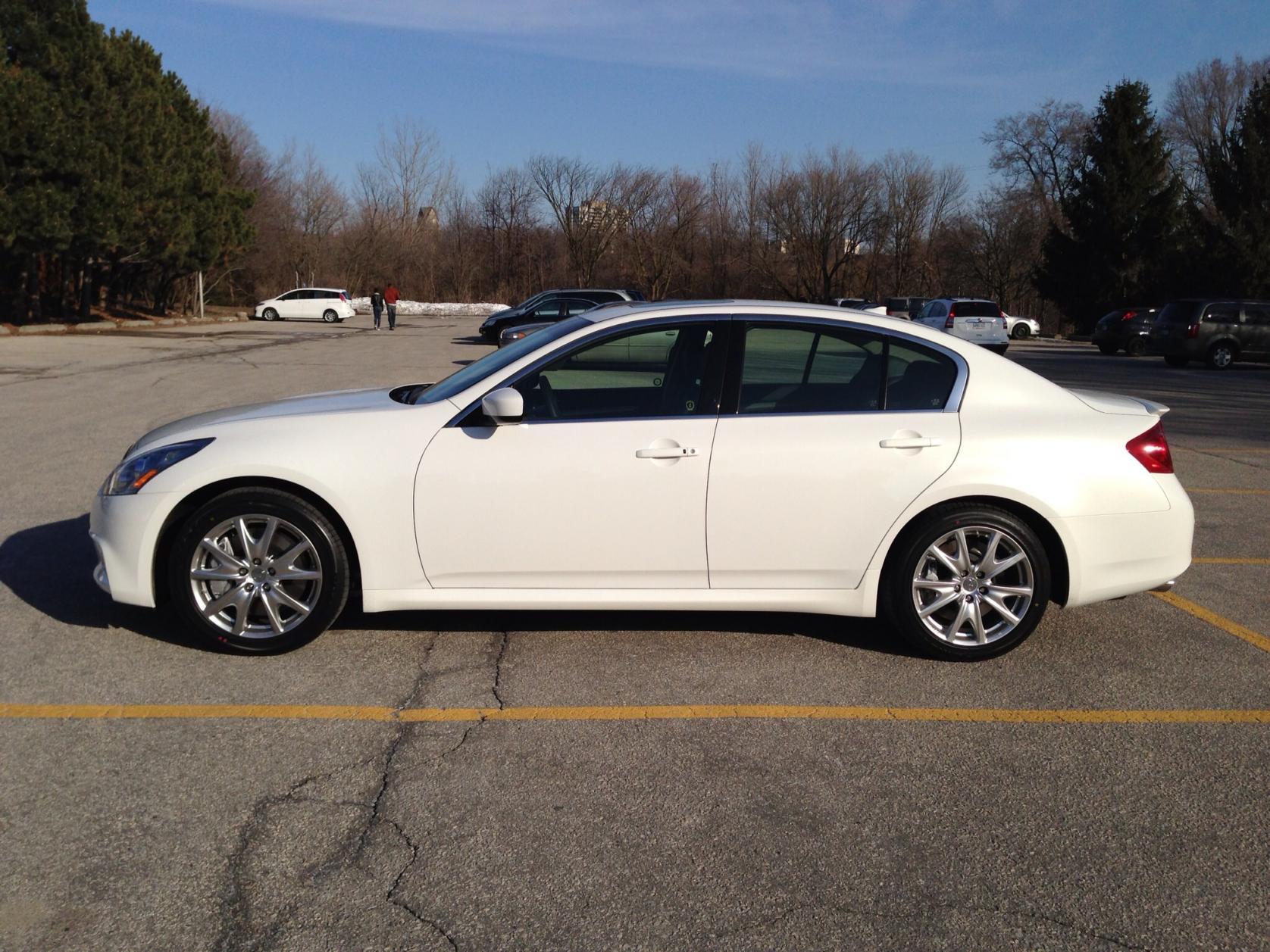

I've got a white 2013 G37S M6 Sedan. It's a fantastic car and the handling is superb. If you care about a fun drive, get one of these.
However, even with excellent winter tyres, I was a couple of times stuck in heavy snow and ice last winter, and had to maneuver back and front for a few minutes until I was able to move again, while the rear end of the car was dangerously skidding sideways.
Some manual transmission cars also appear to have problems with the clutch slave concentric cylinder which tends to fail suddenly. With no warnings, the clutch pedal will not lift back from the floor. I have not had this issue; however, if my car is left for a few hours in temperatures below -15 degrees Celsius, the clutch pedal will lift slowly from the floor (like not following the foot). The problem corrects itself after about ten minutes of driving, when the engine and gearbox warm up.
Despite the above, this car is so fun to drive that I would never ever consider an automatic transmission, FWD or AWD car, an ever-growing problem in Canada where MT cars seems to become rara avis.
