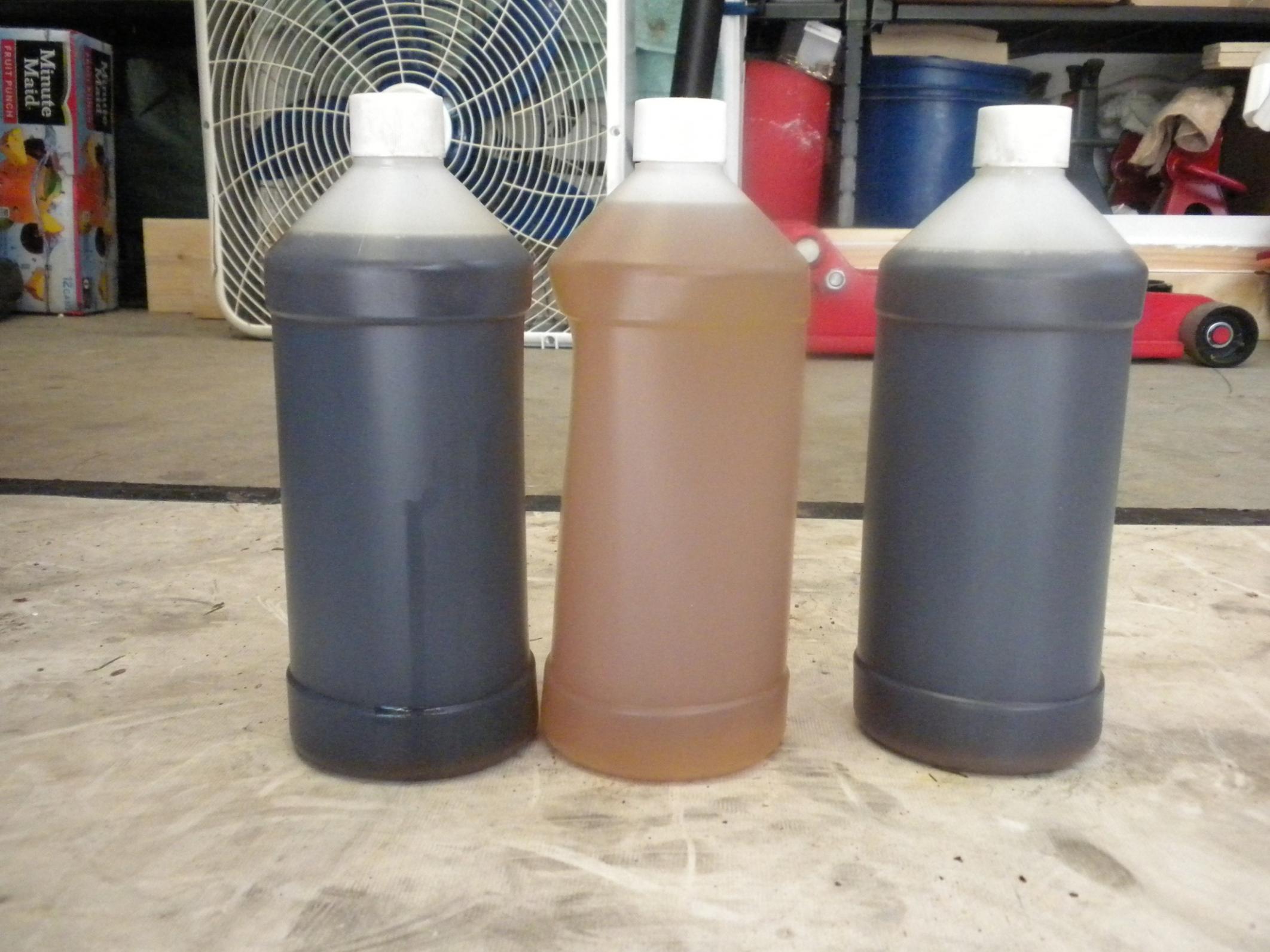

Pic of my 6MT trans fluid at ~18K. I can't imagine the auto being that much better.
Guess which is new vs 18K
Lego, back in June, at 19K miles, I had my tranny fluid swapped out for Redline MT-85. Now I don't have a side-by-side picture for pudding proof, but the OEM fluid was clean as baby spit, just like the new gear oil.
(We'll just pick this conversation right back up off the table, four months later. LOL)
Old Nov 12, 2014 | 03:32 AM
  #29
vqsmile's Avatar
vqsmile
Posts: 459
Likes: 142
From: SF east bay area (925)
Pudding? Proof???
Guys, manual tranny gear oil is nothing like auto tranny fluid. Just because it may have a darker color does not mean it's not still perfectly good. Unless you have tracked the car and know that the tranny temps were high enough to burn the oil, I wouldn't worry about a little color in oil that's been used less than 20K miles.
Old Nov 12, 2014 | 06:41 AM
  #30
Lego_Maniac's Avatar
Lego_Maniac
Posts: 4,042
Likes: 528
From: Charlotte, NC
Beats me
Maybe mine is a result of all those 7500 rpm shifts??
