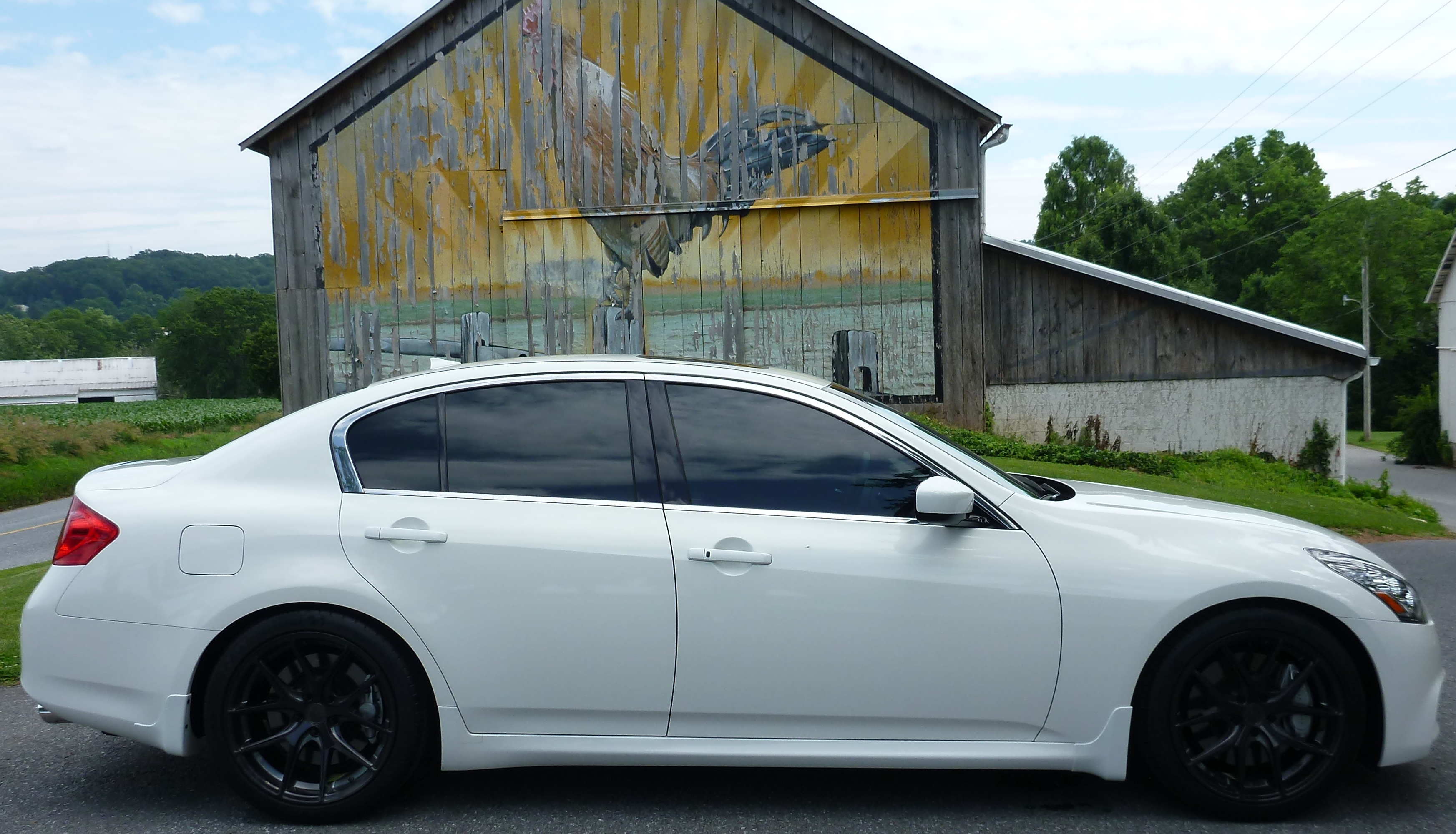

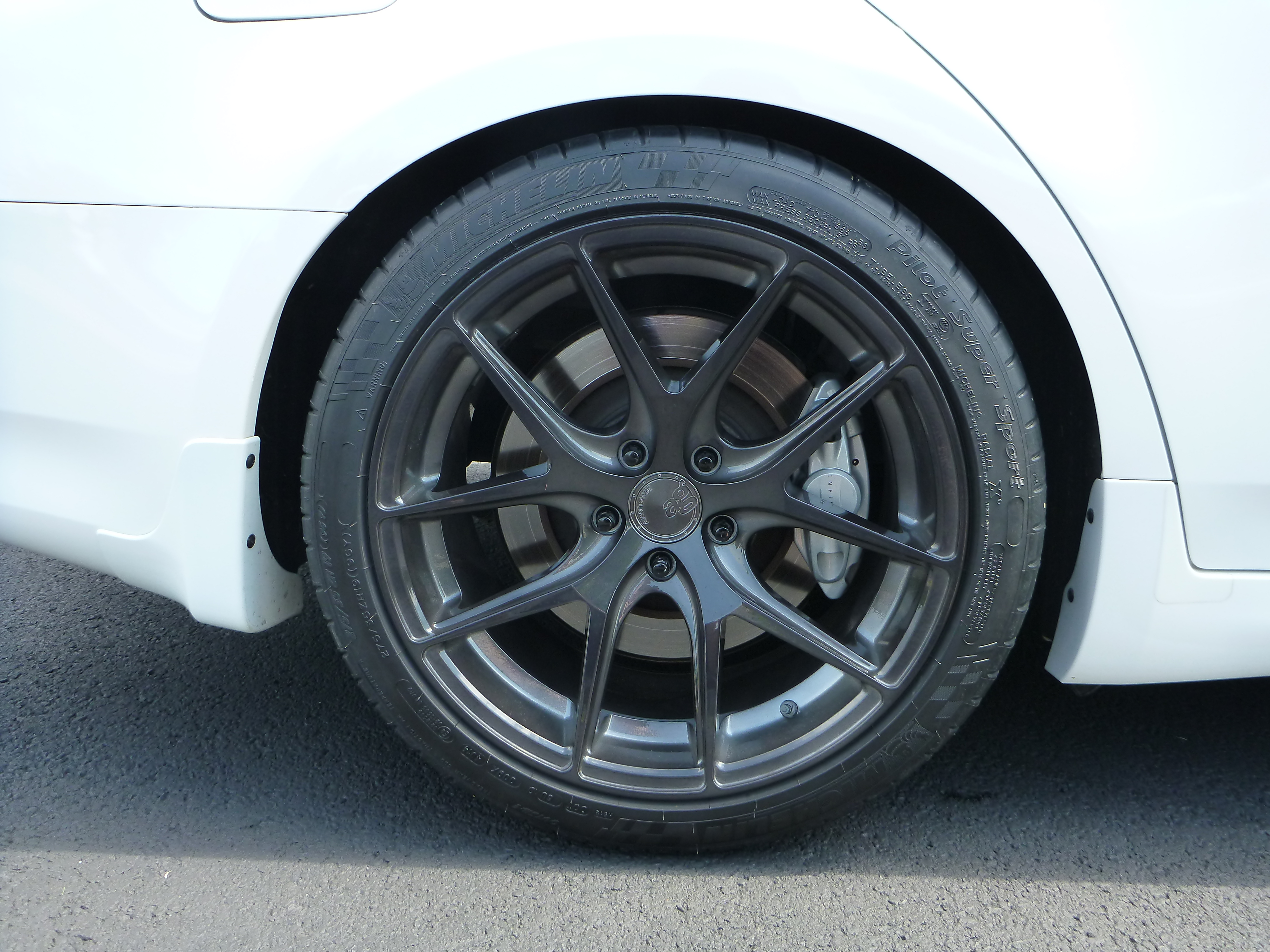

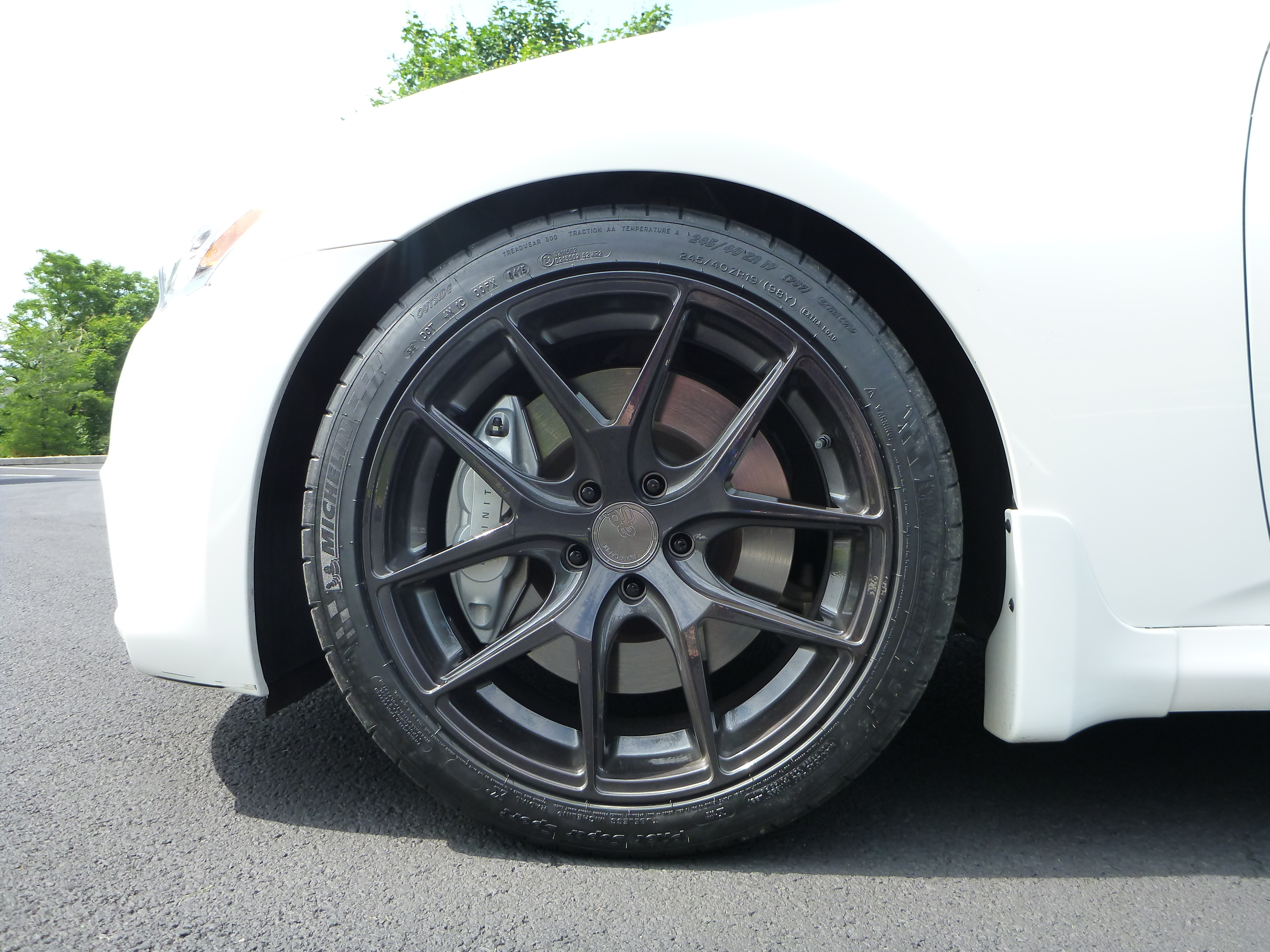

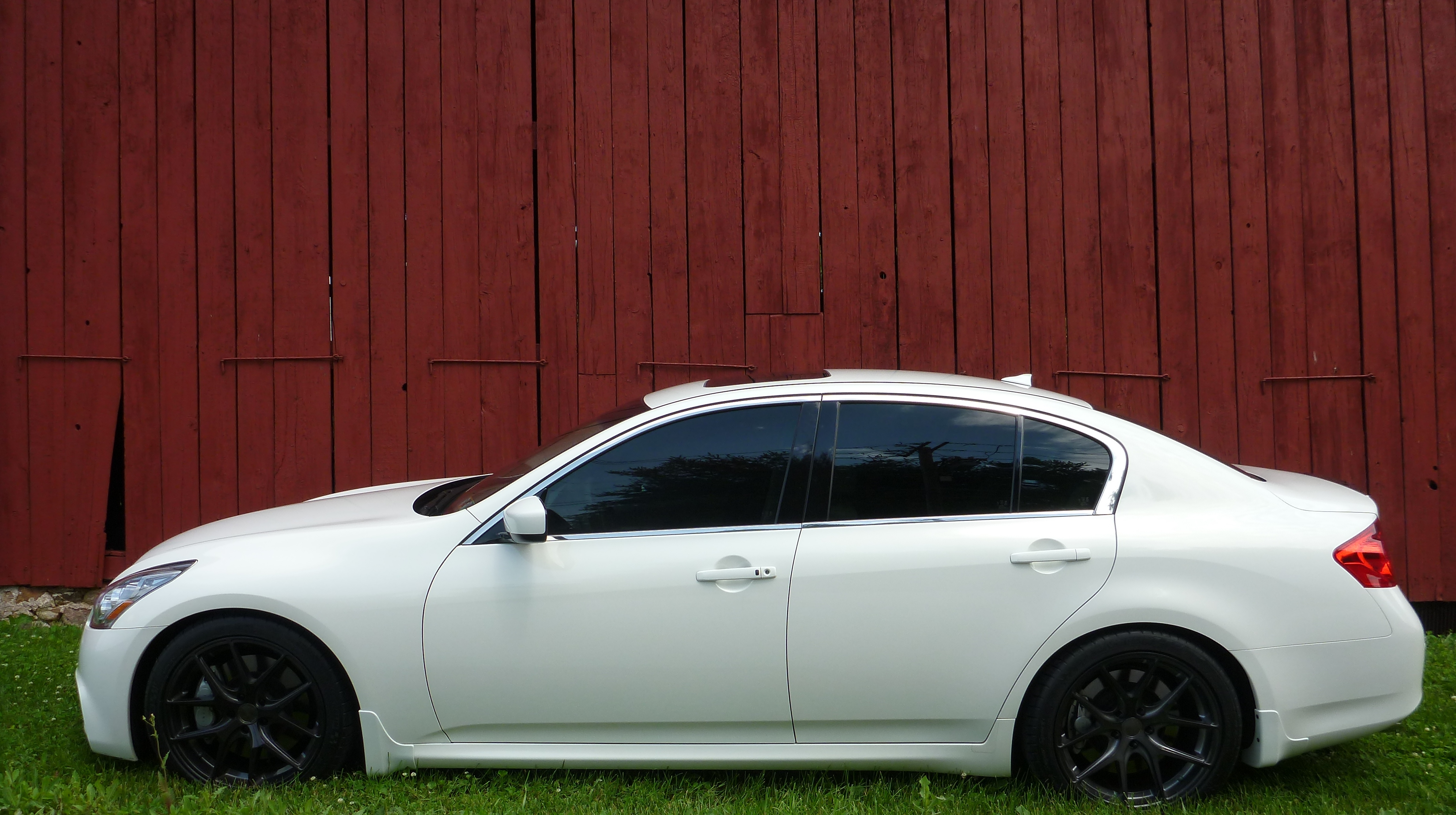

Hello all, I'm pretty new to the forum. I've really just posted questions so far over in the tech subforums. After some help from blnewt over there I finally finished the first round of mods. I have a '12 RWD w/ sport package and just installed Swift springs last week along with new Avant Garde 580's in smoked graphite (19x9.5 R & 19x8.5 F - 275/35 R & 245/40 F Michelin PSS). BTW, Jason with getyourwheels.com was great to deal with.
I was concerned with a drop in ride quality with aftermarket springs after coming from an A4 dropped on Eibach springs that produced a ride that was stiff and jarring in all the wrong ways. Anyway, I absolutely love the Swifts. The new springs have produced no discernible difference in ride quality over the OEM springs while vastly improving the cornering and handling. Along with the Michelin PSS, it feels as if I'm driving a different car.

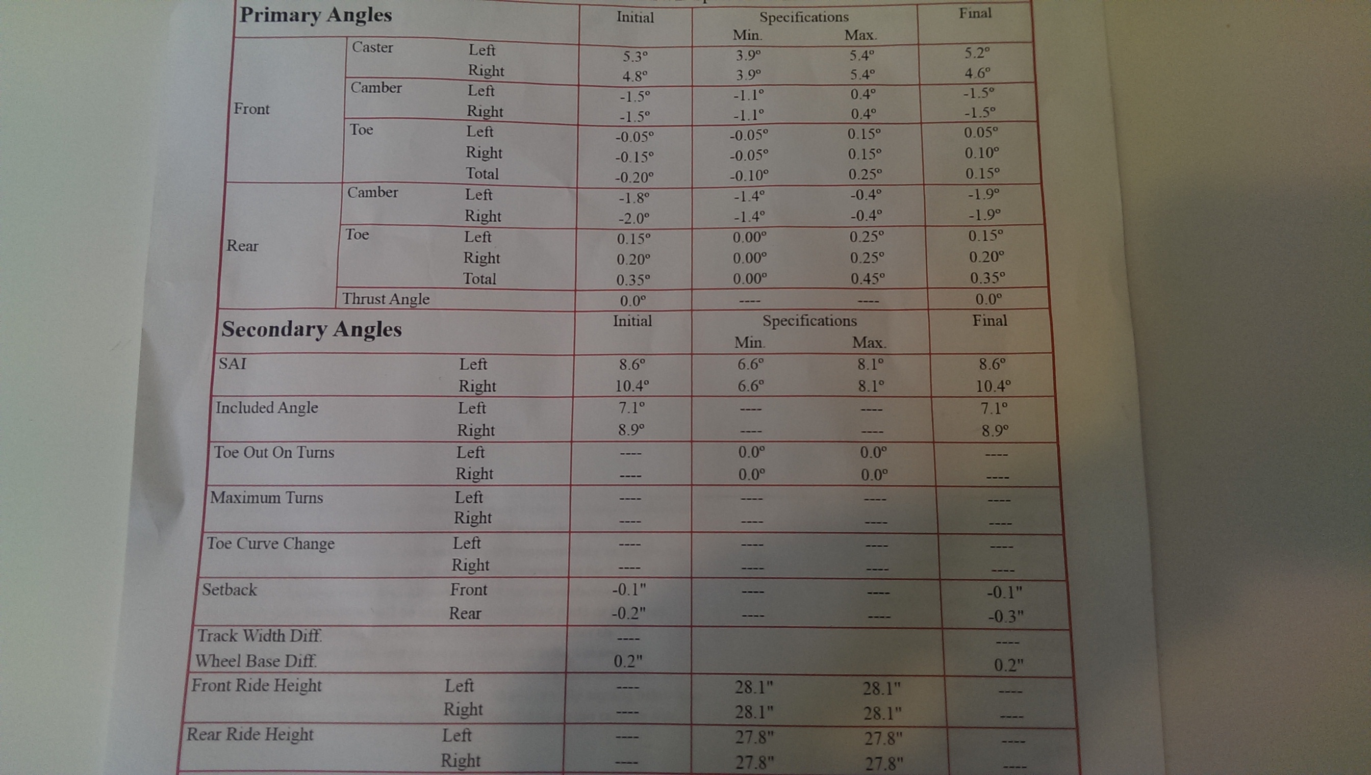

I just got an alignment today and here's the specs. Everything's within spec for toe and camber. I was hoping for the camber to be a little closer to factory spec, do those numbers seem like they'll be OK though?

Fitment looks perfect. IDK how you pulled that off with 19's and RWD Swifts, but pics don't lie. I swear, sometimes I think every car is different, regardless of identical make/model.
Technically, you're 1/10th degree outside of rear spec... splitting hairs.

Looks good efp11.

Nice job all around efp11, glad Jason hooked you up and the wheels/tires fit so well.
Drop looks proper and those alignment specs should result in decent tread wear.

efp11, great choice on wheels and tires. Your alignment looks pretty spot on for a lowered G37. In order to get the camber/toe closer to spec (aiming for zero is actually wrong), it would require camber arms and toe bolts. Anything under -2 camber is good for decent tire wear.
What offsets are those rims?

Thank you! The rears are 40 and the fronts are 35. I would have preferred 45 in the back but that wheel in that size didn't come in that offset.
