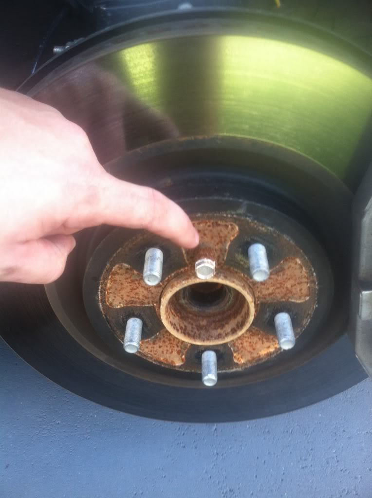

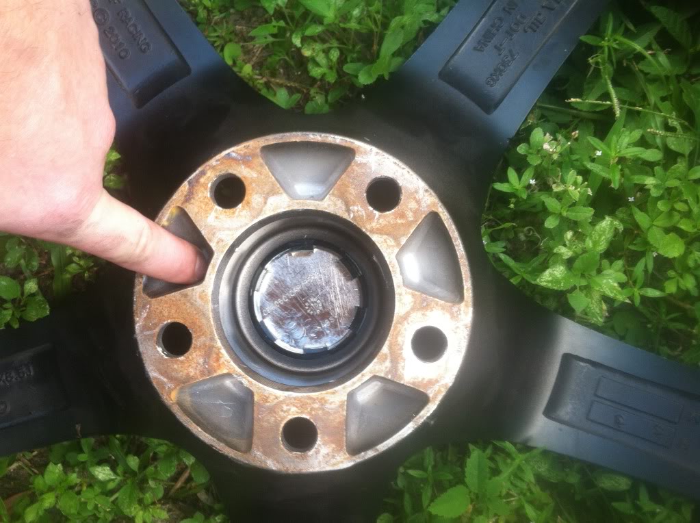

What is this bolt?
Was test fitting my old rims on my 37S, back wheels fit np but front wheels keep hitting this dam bolt? WTF is that? Rims clear the BBK, just not this stupid bolt. Anyone else have this issue?

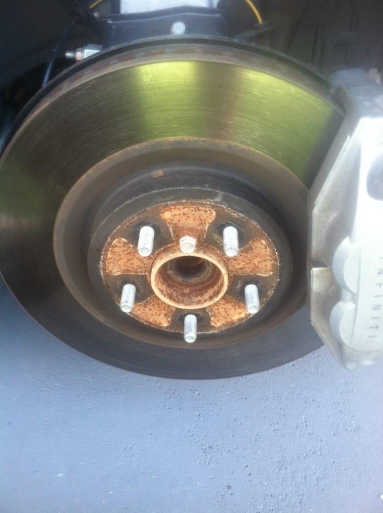

Stock rim depth is noticebly deeper...past my middle knuckle

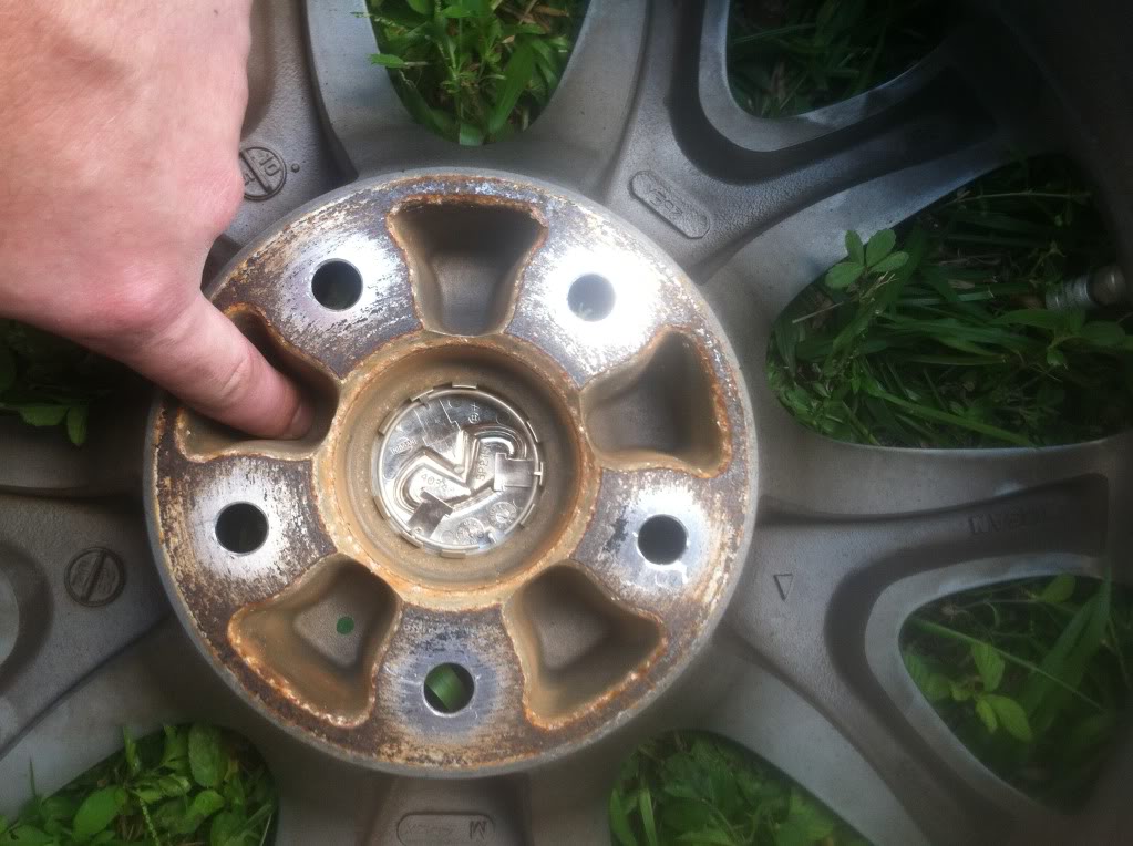

Aftermarket rims...not so much

You have to remove it in order for your rims to fit.

so I can just take it out? what is it?

I think it's an indexing bolt just to make sure you don't mix up your staggered wheels. No evidence of that, so don't quote me on it.

ok^^^ so anyone else have to remove this bolt when putting on your aftermarket rims???
Yes .. it was to keep people from mixing the staggard sized front and rear wheels. You can remove it and keep it for later if you want.

great, thanks everyone for their feedback...back out to remove da bolt
