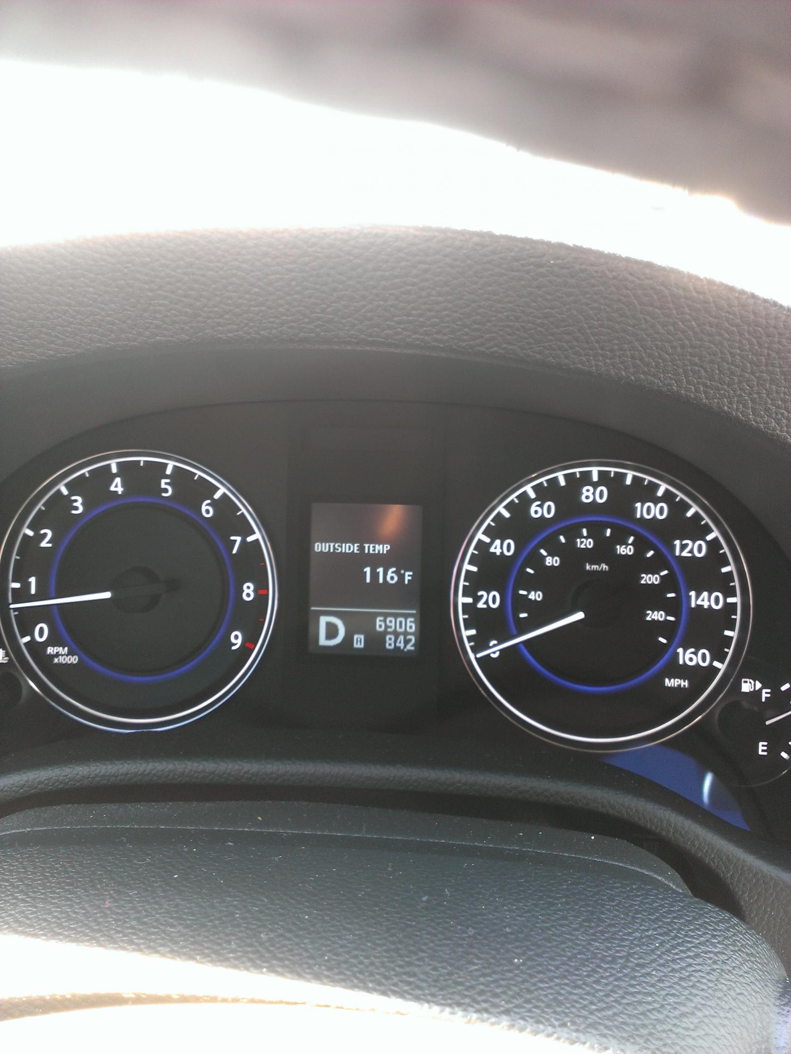

Anyone know where the temp sensor is located? I'm really doubting the accuracy of this feature as there is no way I hit the displayed temperature. It was parked in a lot for about 45 minutes but it never gets that hot in So Cal!

I live in So-Cal, and it can get sometimes up to 110 during summer.
The temperature displayed in my car is somtimes a few degrees higher than it actually is. I always do my comparisions at this intersection near my house where the "actual" outside temperature is displayed.
Through my many observation, the car sensor can be off by a little as 2 degrees and no higher than 8 degrees.

if the car is sitting in the sunlight it always going to read higher till you start moving
and has to chance to reflect close to the temp it should be..

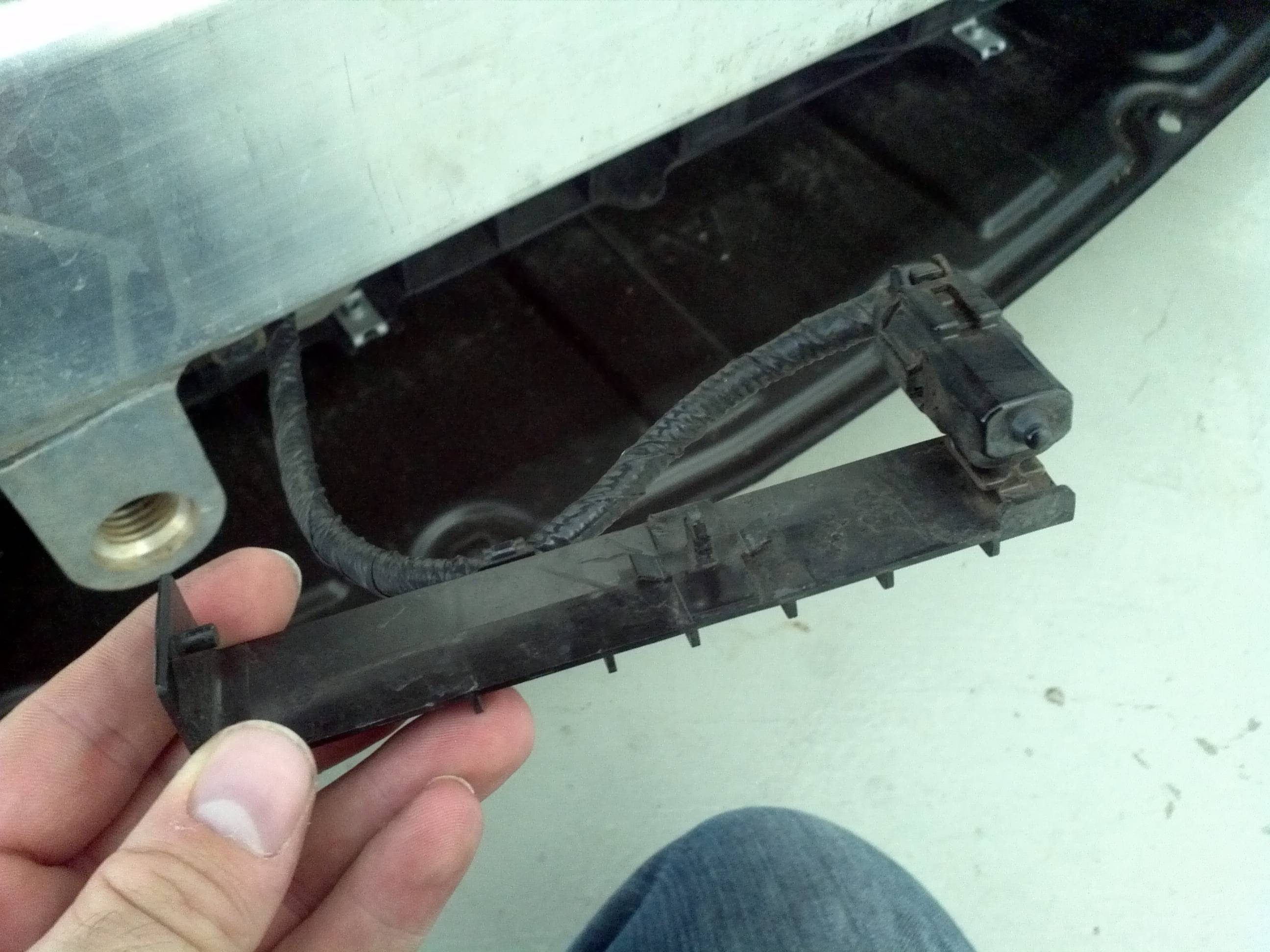

I have the same issue as well, after my TT install, my temp is reading 10C more lol, wondering where the sensor is?
Old May 13, 2013 | 02:50 PM
SilentR's Avatar
SilentR
Posts: 19
The sensor is located behind the grille, at the bottom of the AC condenser (radiator) right in the middle. You can get to it by taking off the bottom engine shield, it's attached with a connector so changing it is easy.

Found a few pics, can be useful; maybe we can think about relocating it? The valley is getting too warm!

Oh and as far as your temps, when your car is sitting your start reading temps off the car, you really have to be moving to get the air flow in order for it to be half way acurate. Once a car is hot and you park it you will see very high temps!
