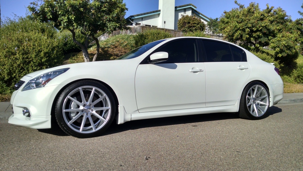

Time to save this thread...
Great idea.

Originally Posted by Furlow
Great idea.
Are those mud guards on your car?
Old Jun 14, 2015 | 05:46 PM
  #4754
Furlow's Avatar
Furlow
Joined: Apr 2010
Posts: 431
Likes: 65
From: San Diego, CA
Yeah for when I go off-roading.
Old Jun 14, 2015 | 06:14 PM
  #4755
Posts: 19,829
Likes: 5,137
I think they look good with the OEM ice-breaker, don't you?
Both are optional, qmantran. Although 99% of G's sold have splash guards.
