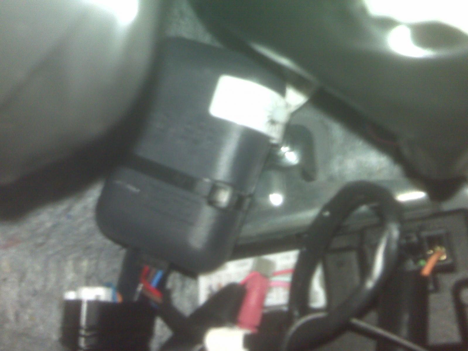

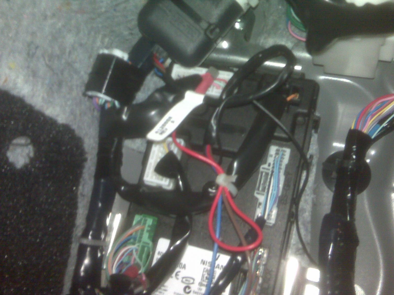

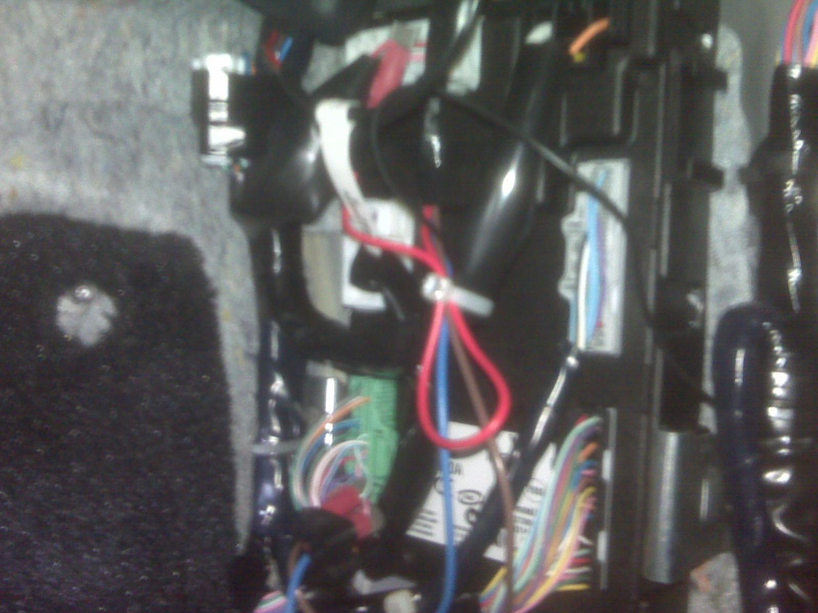

pics
here they are
Attached Thumbnails Please help major issue!!!-img00828.jpg   Please help major issue!!!-img00829.jpg   Please help major issue!!!-img00836.jpg

However, they found some aftermarket sensor spliced into the PCM wiring and because it was done poorly the wire connections are coming apart.
That is NOT an aftermarket shock sensor that is OEM nissan shock sensor part # 999M2-vU003 and shows application as: "G35/G37 (2008~)" on the instructions.
It appears to be connected using the OEM wire taps that nissan includes with it, red with gray caps. Tell the dealership to show you that part number and you will see that it is the same. However it should be taped around those connectors per the installation instructions.

Infiniti knows of these shock sensors because they are regularly installed at the ports where the cars arrive in the states.They consider it a dealer add on. If the dealer you went to called the tech support line they would know all about it and they would of told them that these shock sensors are causing all kinds of problems. Hope this helps.
