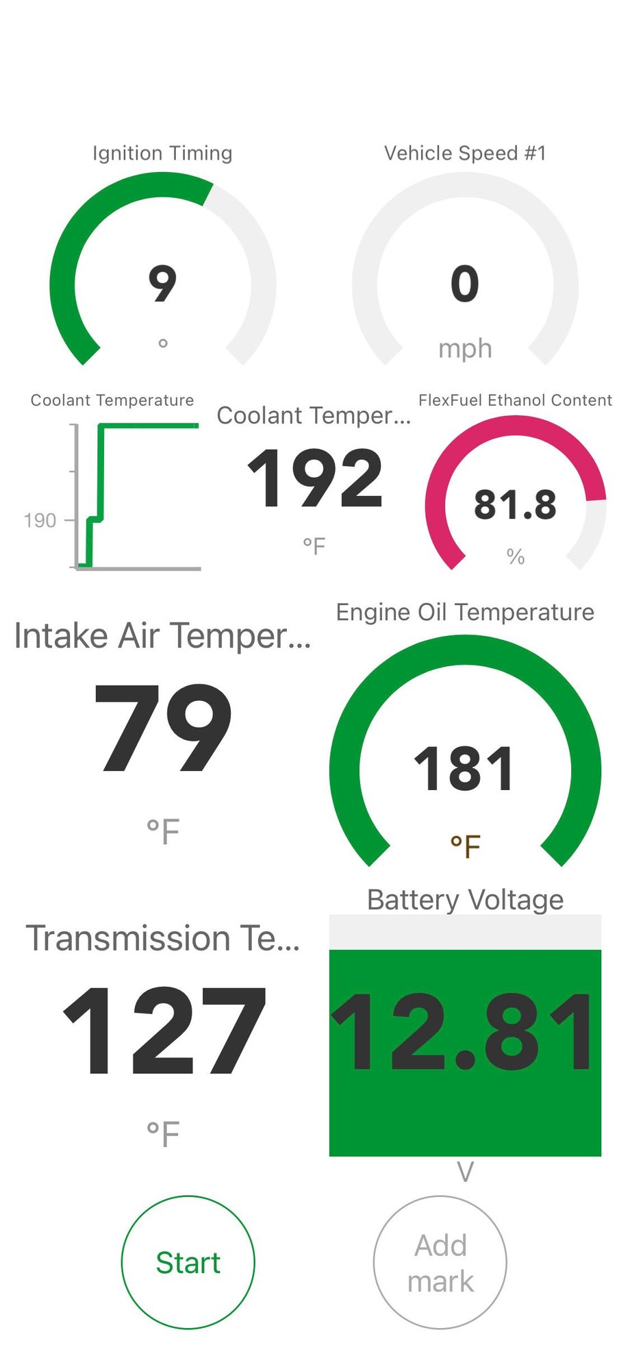

My Ecutek bluetooth dongle is showing a lower voltage reading on my phone compared to when I measure the battery voltage.
I measured ~13.3V at the battery, which seems to be the consensus for normal range for these cars.
My Ecutek has always been showing an average of 12.6V which is concerning, because that's almost an entire 1V that my car is not seeing action with.
Anybody else get lower voltage readings from their ecutek device?

When I first start the car, it reads a healthy 13.98V from ECUteK
After driving around for a bit, maybe 3-5 minutes later, I can see the voltage starting to drop down to 12.6V average
No idea why the voltage is normal at first, and then drops down like that. Also, if I shut off the car and start it back up, it reads 13.98V again and then drops down as I drive around
