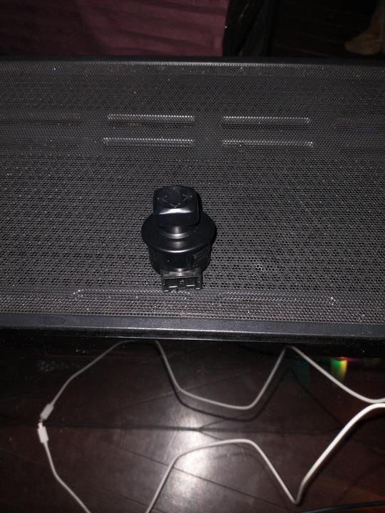

Anyway the car had a few minor problems when I got it, like most cars do. The hood's not staying open and the steering wheel won't adjust. The switch to control the steering wheel adjustment is all floppy and flaccid. I'm hoping that replacing the switch fixes it so I bought this off ebay.
Can anyone tell me how much of a job it is to swap out this switch and what tools you will need? I tried googling but I can't find anything on the matter. Wonder if anyone here can help me out? Also can anyone tell me other things I should check or possibly replace in car of this age and mileage? Thx in advance for any tips

Removing the switch will be a super simple, 30min. task. All you will need is a flat blade and phillips head screwdriver. You will not have to remove the steering wheel.
The following video is for installing paddle shifters, however, the procedure to remove the trim pieces is spot on:
Once you remove the lower trim cover, there will be 2 (or 3) clips (I don't remember) that hold the switch in place. Press them in and the switch will pop right out. Installation is the reverse of removal.

Well I got some time to try and install the new switch today and hit a major snag. The position the wheel is stuck in is too far retracted into the dash and I can't get the plastic trim pieces off even though I removed all the screws in the video. There is just not enough room to get the trim pieces off because of how the wheel is positioned telescopically.
Is there anyway to get the steering wheel to telescope out without the switch working?

Were you able to get the top cover loose? There is a "ridge" on the upper and lower covers that gets "tucked" up behind the steering wheel. That said, at this point you have three (3) options:
1) you can try popping the lower cover out from behind the steering wheel;
2) you can try popping the switch housing out from the lower cover. The housing clips into the lower cover. This is risky as those little tabs can easily break
3) last resort, remove the steering wheel.

More than likely it will be your motors. I went down this path and found the same with my switch.
The switch doesnt see as much action as the motors do.
EVERY SINGLE TIME your door opens or your car turns it moves, add this to your exiting routine. I use the wheel as leverage to exit the car, many times I've used the wheel as it's going up. This will put a strain on the motor.
The motors are simple internally and most kill the bearing leading to premature bearing failure or kill the brushes.
The motors can be replaced without taking out the column however they can be tricky. A new motor will probably be impossible to find/expensive however theyre both the same. A trip to the local JY could yield some motors for you.
Note: the used motors might also be bad. I brought a couple of motors with me to gut and replace the parts in mines.
My first issue was a dead motor
Second motor was working however really noisy.
Third had dead brushes
4th was the hybrid of the second and the third.

As OP stated the switch felt "broken" it is a logical starting point and easy fix- provided he can get to the damn thing.
Can be a tricky one. I ended up pulling on the switch while I finessed a small flathead to pop it. If done correctly the covers don't need to come off(not like it's that difficult). I chose to leave them, came to find out my motors were at fault.
