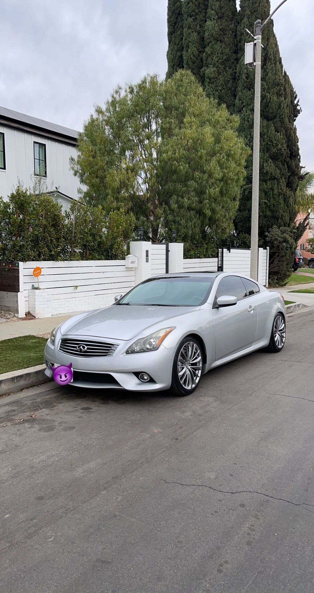

Hey guys so Im new to the car scene and i
have a g37s coupe and it’s currently running -3 degree camber in the rear and -2.5 in the front with 0 toe all around. The car is lowered on swift sport lowering springs. I was wondering if you guys think this is too much camber for daily driving but with some canyon attacks. what would you’ll Recommend I should have as I’m about to buy new sport tires and I want to get the most out of them without causing too much extra wear. Thank you !

The only way to fix your camber is getting camber kit. If you didn’t do it when you put on the springs you probably weren’t worried enough about it. So you’ll burn through tires 20% faster, not the end of the world. I’d leave it.
