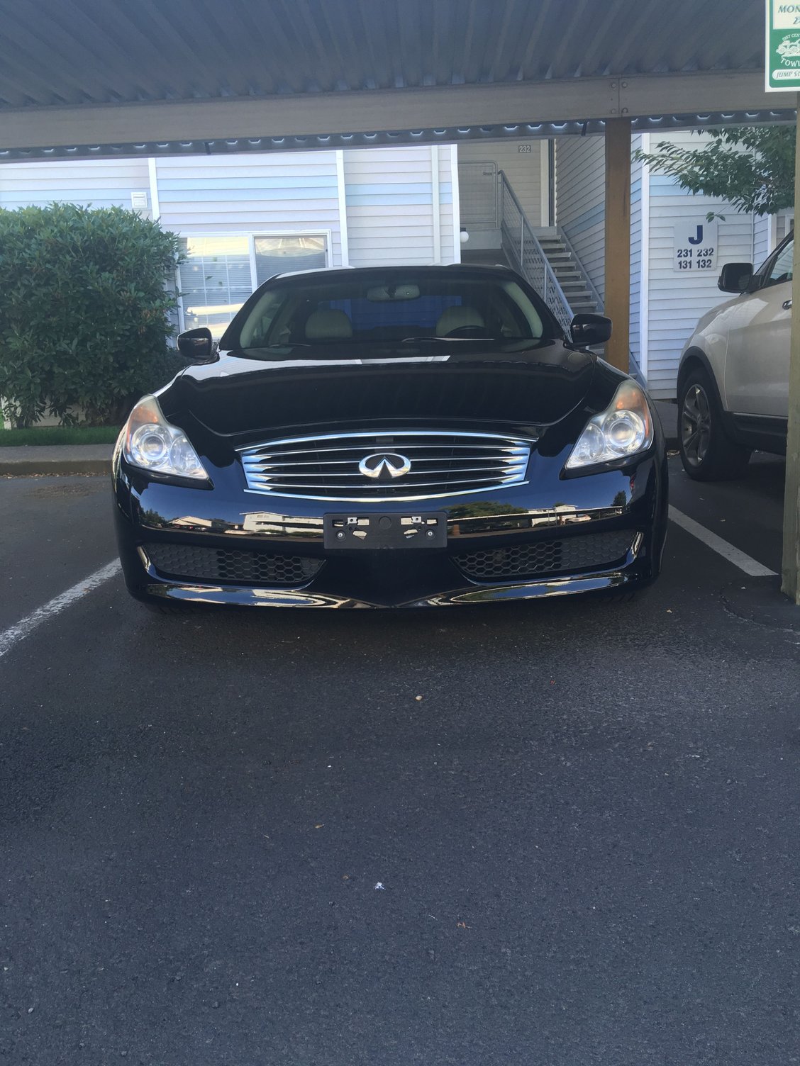

Hey y’all first post on here. I’ve been reading different posts on here, learning about the g37 for a while now. I always wanted a g35 (only because they were in my price range) but I’ve been somewhat loyal to Subaru after owning a 02 Impreza OBS for years. After looking on offer up and Craigslist for around 4 months I was closing in on a g35 sedan.
Then there she was.... a 08 Black g37 with luxury package, tinted windows, new rims, no emblems, 154k auto trans (I drive in traffic everyday) for $5900. Price was due to salvage title from a accident where someone backed into the passenger fender. Fender damage doesn’t appear bad at all but totaled title still. Also no plates due to the owner transferring them to their other vehicle. After talking with the owner for a while he said he’s the 3rd owner and got it from the 2nd owner (his uncle). His uncle owned it for 3 years and the current owner for 6 months. He works construction and needs a truck and the g37 his uncle gave him serves little purpose for him. After talking him down on the price I decided to meet up.
We met up and I instantly fell in love with the car as it pulled up. I did my best now to show it and checked it out, drove it for a bit. Shifted very smoothly and felt no lags in power. Didn’t experience any squeaky breaks. So now we get to the issues. Has 3 codes all for the evap system (small leaks, gross leaks) autozone says one part will fix all 3 codes idk about that though. Has condensation in the driver side rear taillight. Needs new hydraulics for the hood lift.
I talked him all the way down to $4650 and bought it. After I bought it I was wondering what it would take to get it all fixed up and registered with tags and plates in my name. Also heard rattling from where the exhaust system would be and got a bit louder after a 40 min drive home. The title is under a insurance company that dealt with the accident and sold it to the guys uncle. I have the reassignment paper that shows the transfer from the company to his uncle, to him, to me. Will dmv give me issues with this? Also, what am I getting into to here? All help is appreciated. I’m glad to be part of the g family no matter what.
P.S. Codes are P0441, P0455, P0456

Car looks painted. Possible rear accident which would explain taillight and evap codes. Evap box is probably cracked.

Could be but if so it didn’t appear to be to me. But who knows. Taillight just appears to be letting some moisture in. My 02 Subaru has this too and thats with no accident, just happened over time.

All of those codes look like a cracked evap canister, get under the car and visually inspect it.
You can see if it's been painter/repaired/etc.
Not to sound like a debbie downer but look at this:
Paint is fenominally clean for it to be original
Trunk has been debaged, common for shops that remove the emblems and forget to mark where they're supposed to go so they just eliminate for a cleaner look
Leaking tail (possible weather strip from removing and breaking it/cracked tail/ bent body so the tail doesnt fully seal.
Multiple Evap codes.
You have to understand coupes dont have too much impact area in the rear so a rear end crash will do more damage on a coupe than a sedan.
Get a flashlight, take some pics then comment with progress here.
