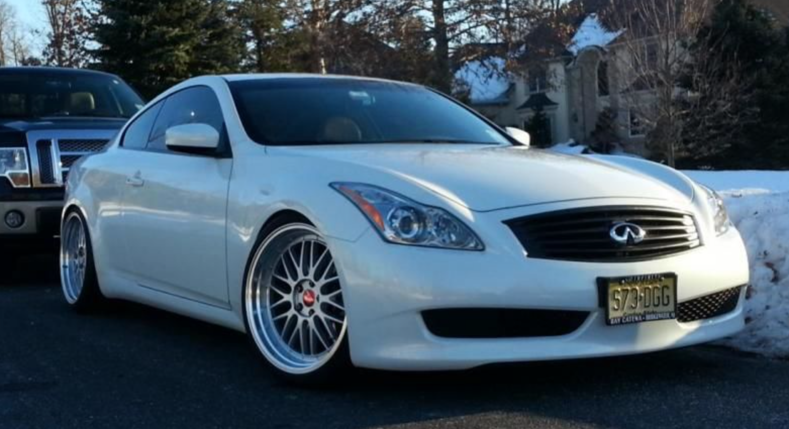

Hey man,
I did the same swap, its really not bad at all. Use this guide to remove the bumper (just a few pop clips and screws)
https://www.myg37.com/forums/d-i-y-i...l-install.html
After you've removed it, just essentially go backwards once you've installed the new one. The only thing to consider when swapping from a non-sport to sport is that you will need to purchase a slim washer tank in order for the new bumper to fit. The tank on the non-sports is larger and prevents the sport bumper from fitting. I'm cheap, and never use the washer fluid anyway, so opted just to remove the original one and not use any reservoir at all. Cheers

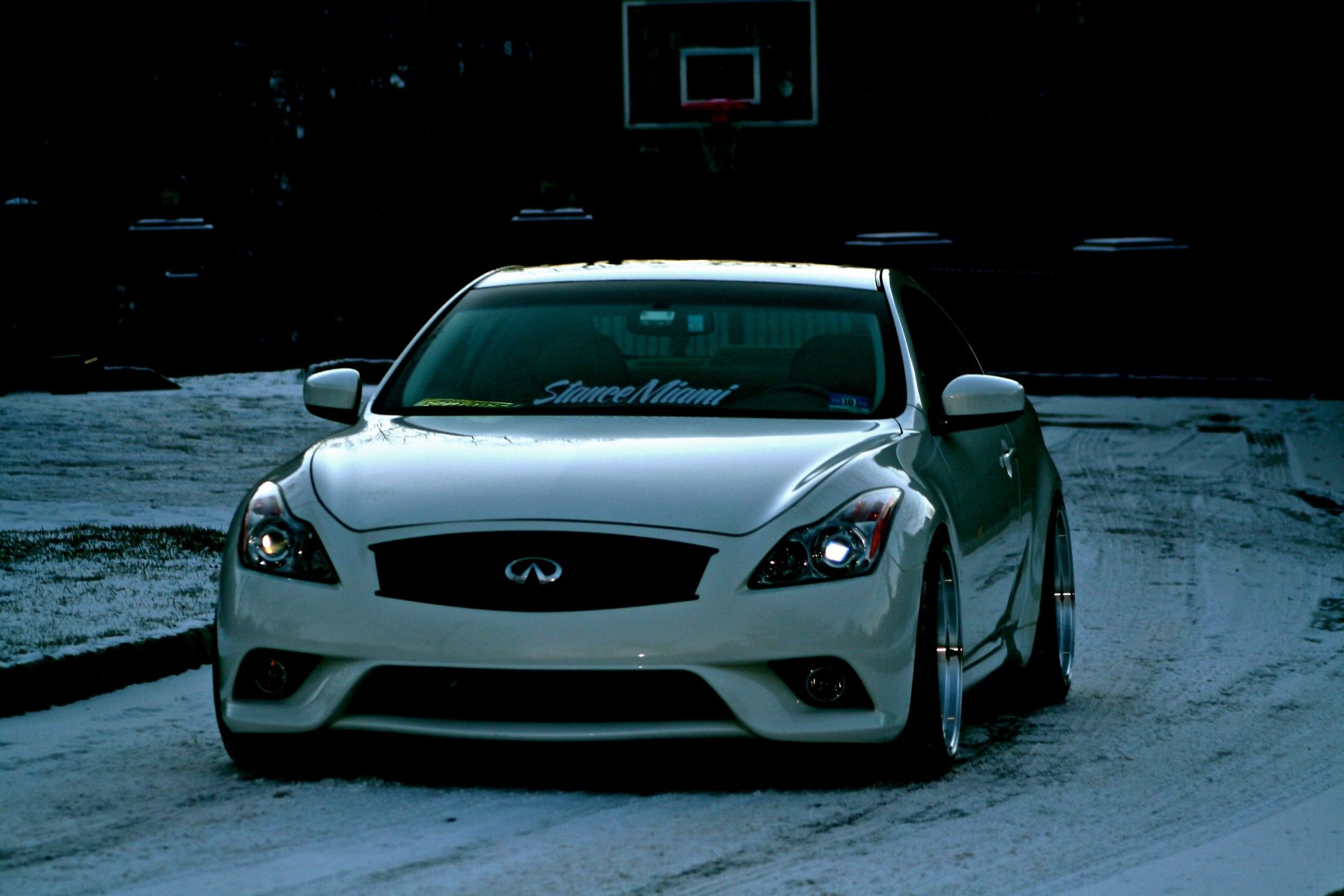

I never got around to doing the fogs, I don't think it should be too bad. I got scared off because i thought you needed to splice the wire from the in-headlight fogs down to the lower fogs, but I haven't really looked into it.

So your bottom fogs are just for show? They aren't working?.. Either way the car looks nice.
