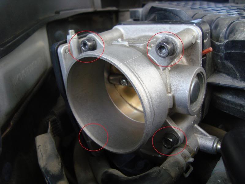

From https://www.myg37.com/forums/d-i-y-i...le-bodies.html
Those look like fairly standard allen cap bolts. Take an old one with you for size/thread. Our local ace hardware has all sorts of metric hardware. I bet they have something similar. This is not a high torque bolt either so it doesn't have to be a high grade.
