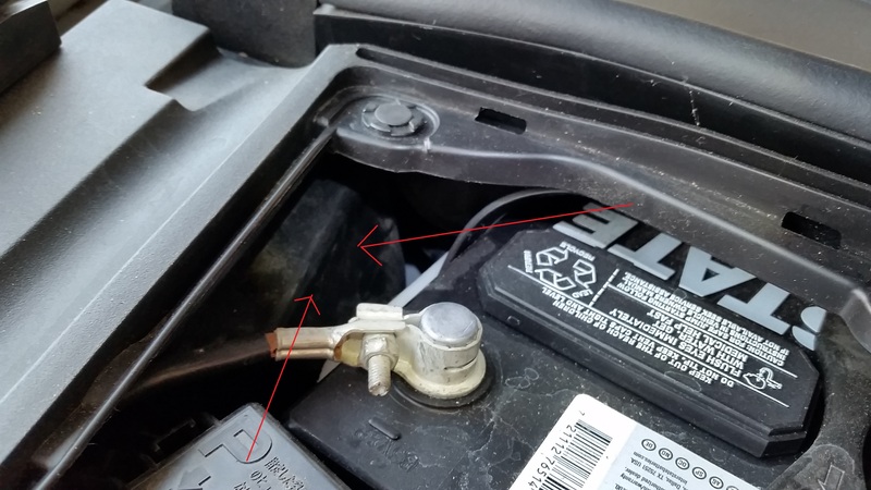

This is the fuse box you are talking about right? I'm confused as to how you can pull out the box to open the fuse box to pull the fuse without removing the battery. I removed all the trim pieces just a minute ago but could not pull out the fuse box enough to be able to open it without removing the battery (it only came up a couple inches). But if I removed the battery, how would I put the car in ACC mode prior to removing the fuse?
NOTE: I was unable to pull the fuse box out enough to see the "steering lock" label. I'm assuming it's further down...
A full DIY is totes unnecessary. Look at this 370z video and it is exactly the same deal.
The wire harness below the fuse box is stiff and bent in a way that makes it difficult to pull up initially. Taking the battery out does make it easier to pull the box out, so you could do this and then put the battery in and hooked up to get the car in acc mode. The box comes out quite a bit.
The box goes back in easier so you won't need to pull the battery to get it back in place after you pull the fuse. Just make sure you have the fuse box closed and sealed correctly as water gets around this area.
