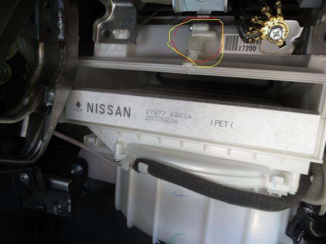

Originally Posted by saywat?
Might wanna research that telecomman
saywat
Here is a photo of the original factory cabin filter taken prior to changing the cabin filter for the first time in my 2012 G37S. Note the direction the arrow is pointing.

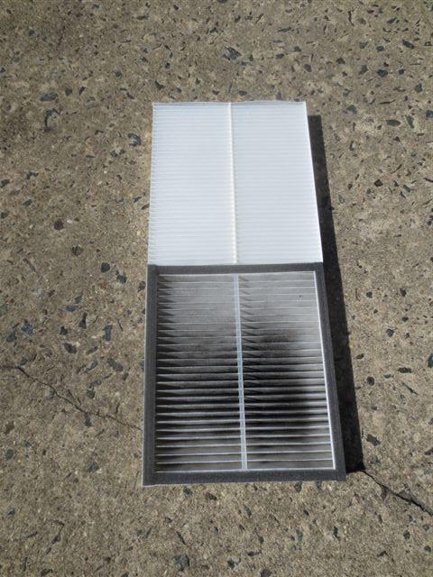

The blower motor is pulling air down otherwise the dirt would be on the bottom of the filter instead of on the topside of the cabin filter when you remove it.
If you did not install yours correctly you may want to check the arrow direction.
Telcoman
