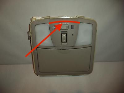

mine rattles where the sunroof controls are, that plastic trim around it. For my case a small piece of felt in the gap fixed the problem. I'm running a ZenEnclosure with 10" Alpine Type-R with a JL Audio 500.1 Amp I can add photos when i get back home this weekend.
you are a blessing sir
