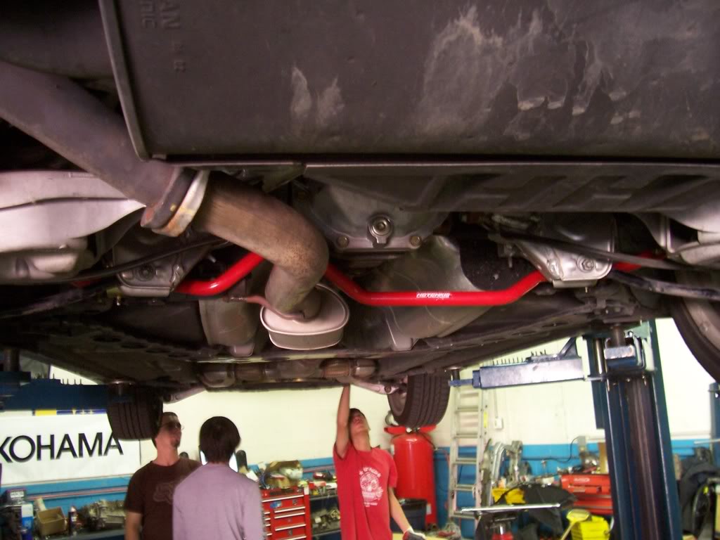

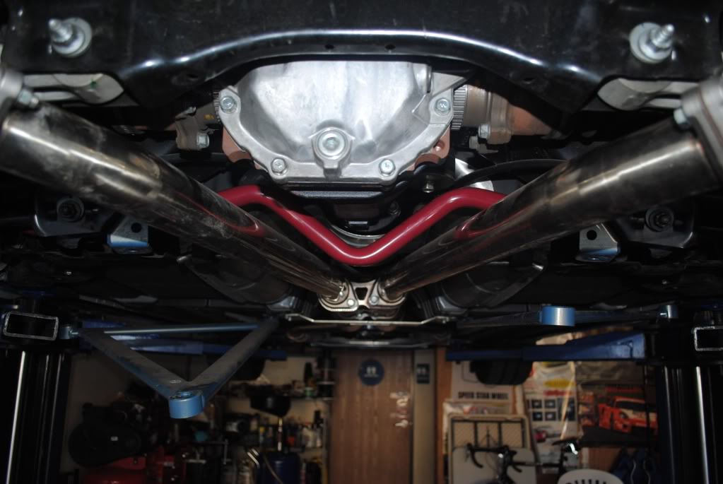

I believe it will fit but you'll have to remove your rear sway bar or modify the exhaust I think. Your best bet is to call z1 and see what they say. But I can say for sure that a g35 coupe exhaust will fit a g37 buy removing the sway bar.
g35 rear sway

g37 rear sway
g35 rear sway
g37 rear sway
