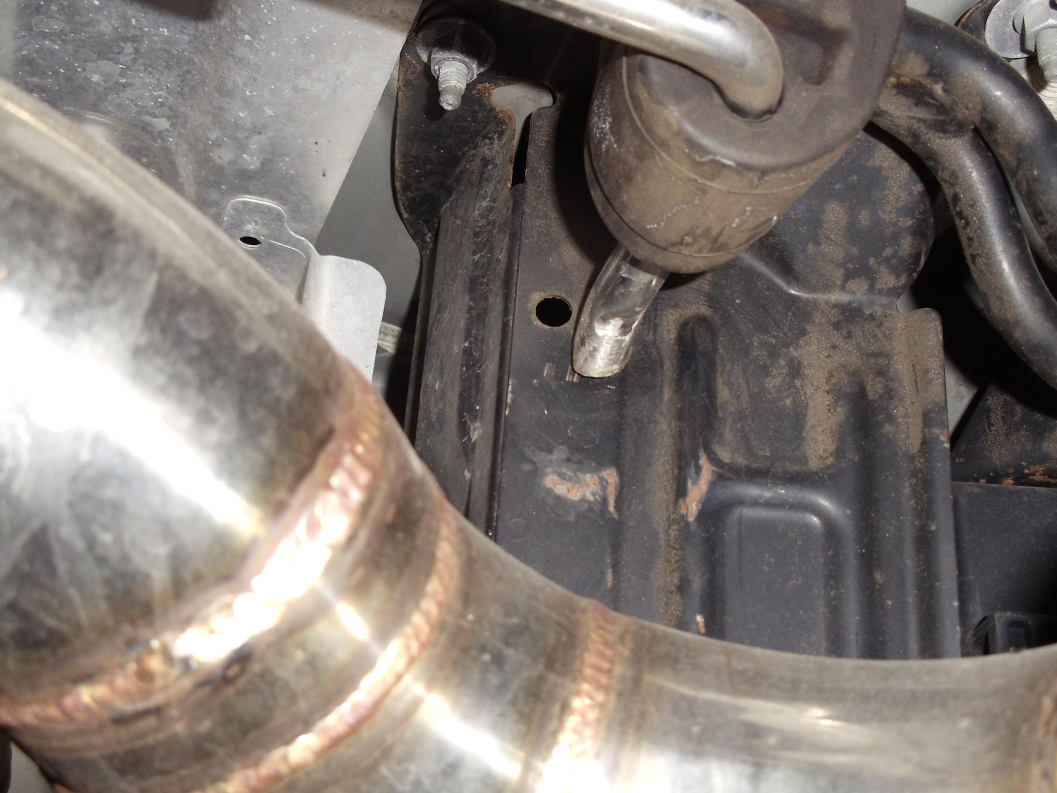

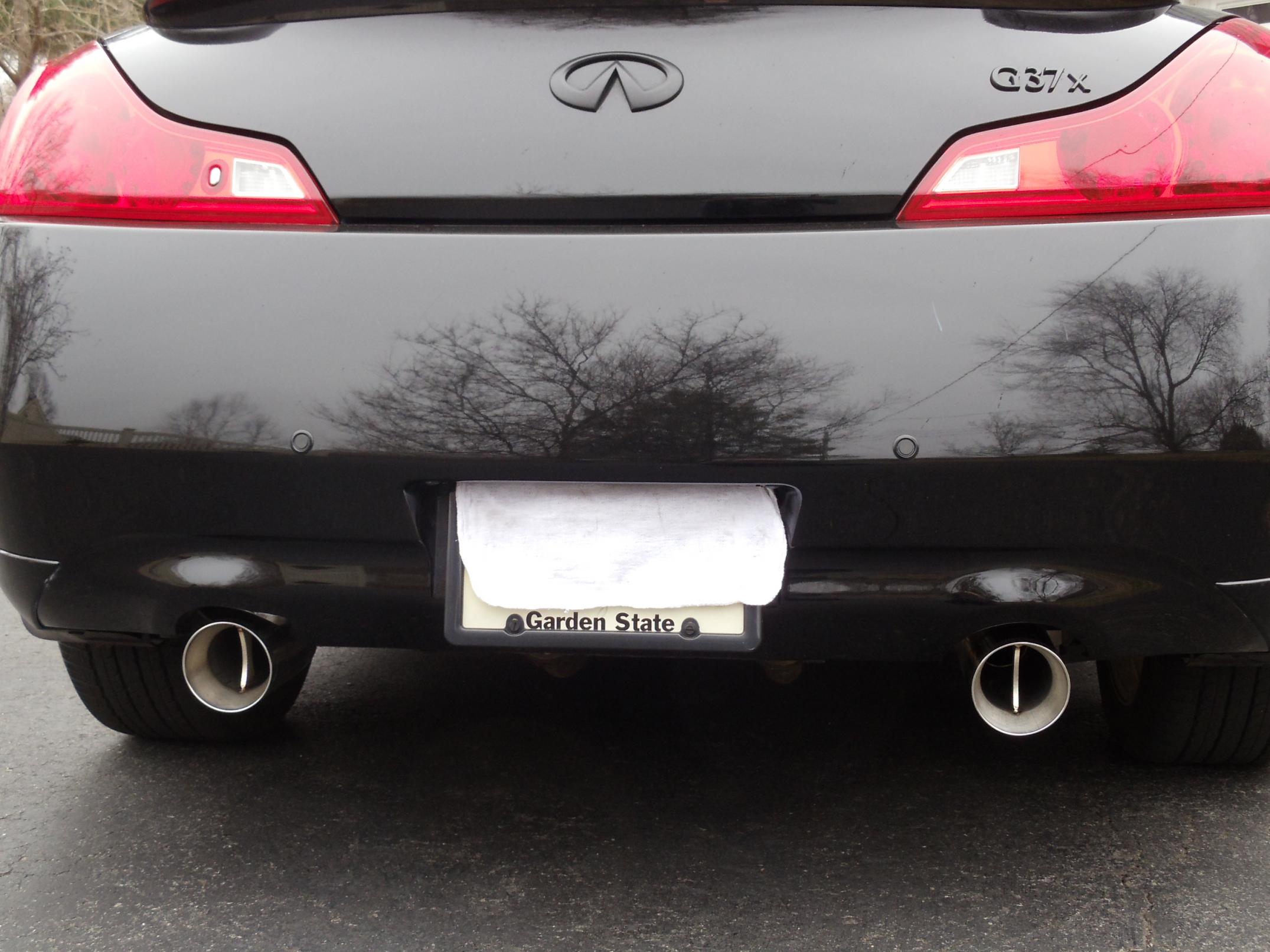

I have the meisterschaft stainless axleback on my 2011 awd coupe. It bolted right on and the only fitment issue I had was the hanger rod on the right side was barely touching a metal shield(charcoal canister?). If I Did'nt already tighten most of it I would have cut off 1/4 inch of it. I just ground it down a bit and looked today and it hasn't hit or rubbed in the six months its been on. I was going to get the infiniti oem accessory muffler but decided on the M/C.
