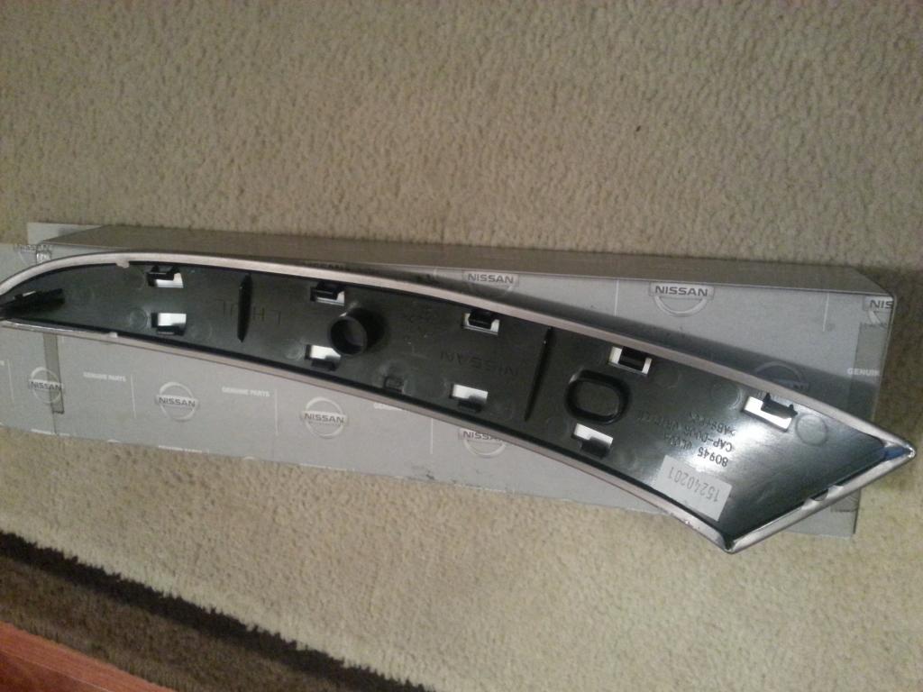

I have a 2008 G37s and am looking to remove/sand my chrome door pulls. Is there a way to get them off without taking off the door panel? Thanks.

If you are referring to the silver piece that you hang onto when you close the door, then I can help. It is just held on by 9 clips and hooks into the top. So you take a small flat screwdriver and insert it between the silver and black part of the handle at the bottom towards the back of the car. gently pry away from the door and pull the bottom out then downName:  2014-08-31222124.jpg

Thats exactly what I needed. Thank you very much.
