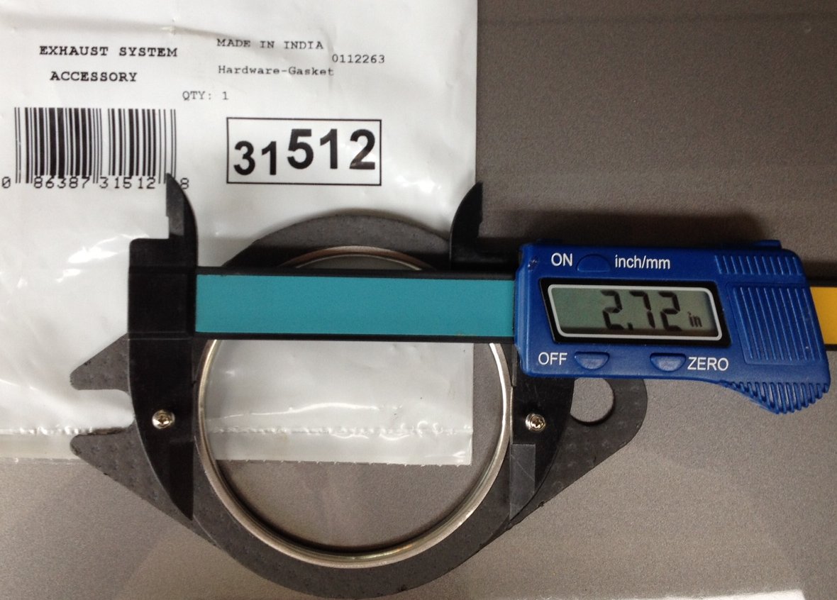

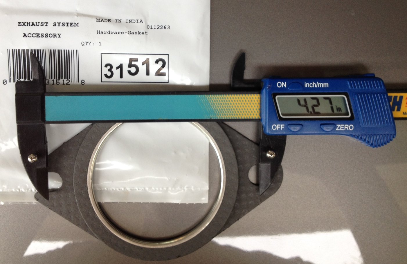

If anybody has been hunting for a replacement Y-Pipe to Mid-Pipe gasket for the Tanabe Coupe exhaust... I have found a PERFECT solution!
I purchased a Walker #31512 gasket from my local Auto Zone for around $5, and find this to be a PERFECT fit. In my opinion is a better, and more durable gasket that the original.
After literally hours of searching for Tanabe gaskets online I simply measured the old one and compared it to 'stock' gaskets available at Auto Zone, and this one matches within just thousanths of a inch. Pics attached...
I hope someone find this useful!!
