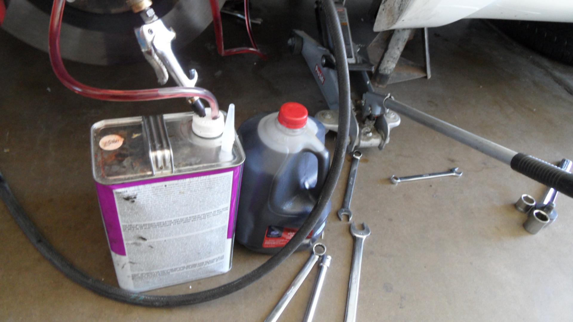

I use to do my acura at 5k do to there reliability issue! did the g at 30k which was also fairy dark .better safe than sorry. fluid is cheap-that the old fluid.let us know what they say?
Attached Thumbnails i think the dealership messed it up..-passport-tranny-001.jpg
