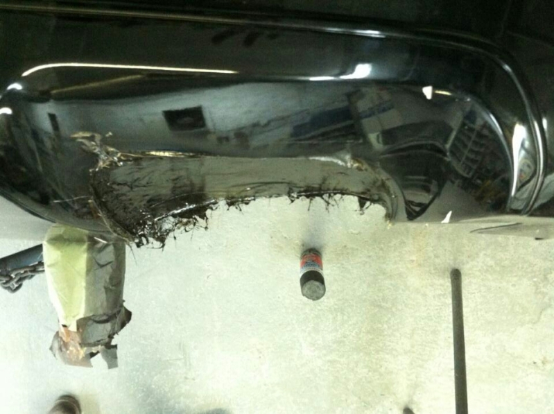

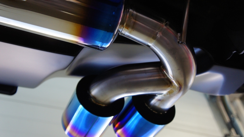

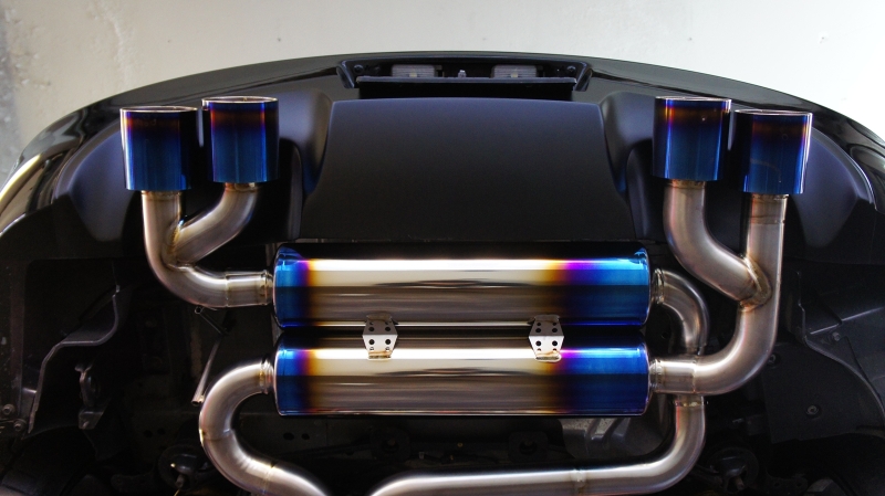

Originally Posted by Dr.Pat
To do it right, a body shop would have to fill in the stock bumper cutouts and then re-cut them to fit the dual tips.

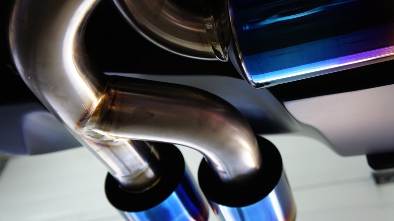

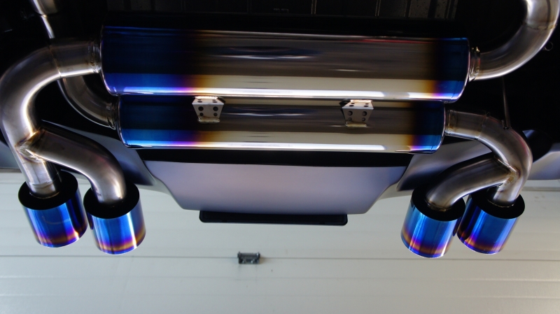

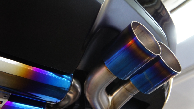

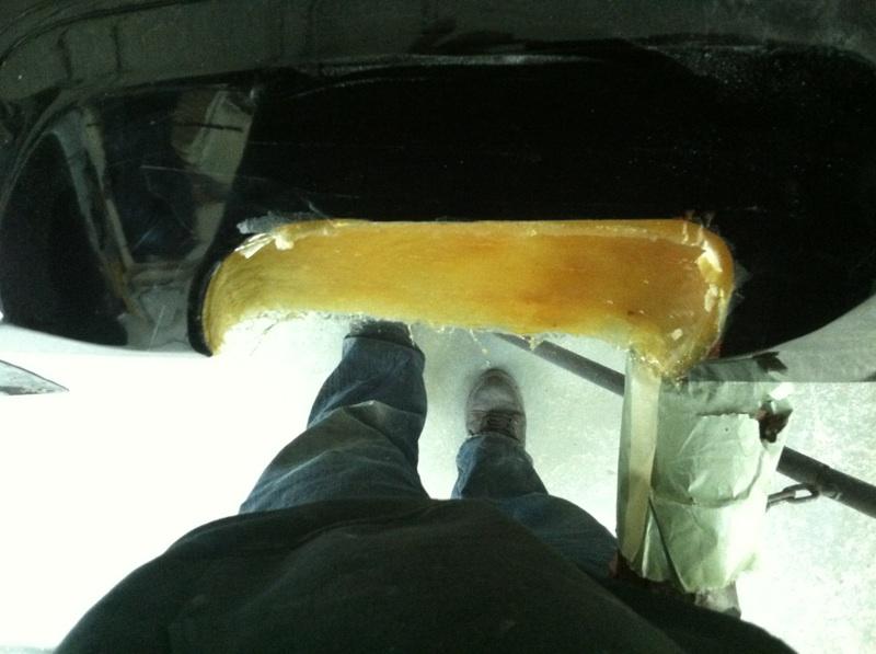

I do not have the stock rear, but I would not settle for trimming the bumper. I had new "tunnels" built to accommodate dual tips. First a steel template was built and then a mold created. From there, the new cut-outs/"tunnels" were fiberglassed.
In progress:
Completed:

^^ looks amazing. If your going to do it, get it done right.
And fugly? I don't get it dude. Car is slammed stanced and the exhaust was done right.

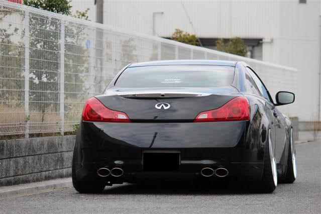

By the way, here is a better shot of the G in the original post...

Looks incredible man! So what rear bumper/diffuser is that?
