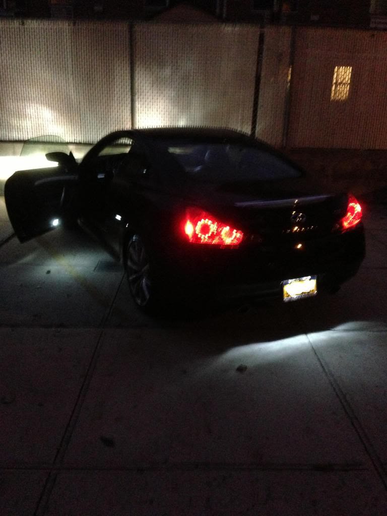

I just did my 1st mod and installed the LED Stage 2 package from Diode Dynamics. I think they look a lot better than stock.

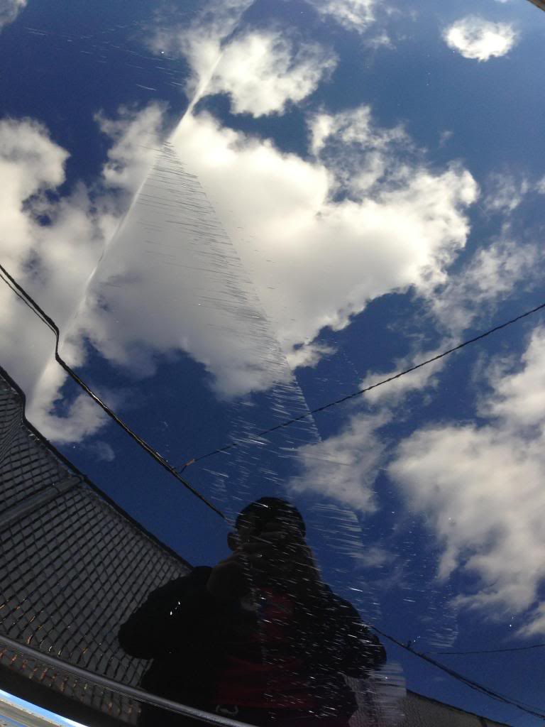

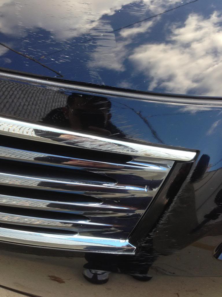

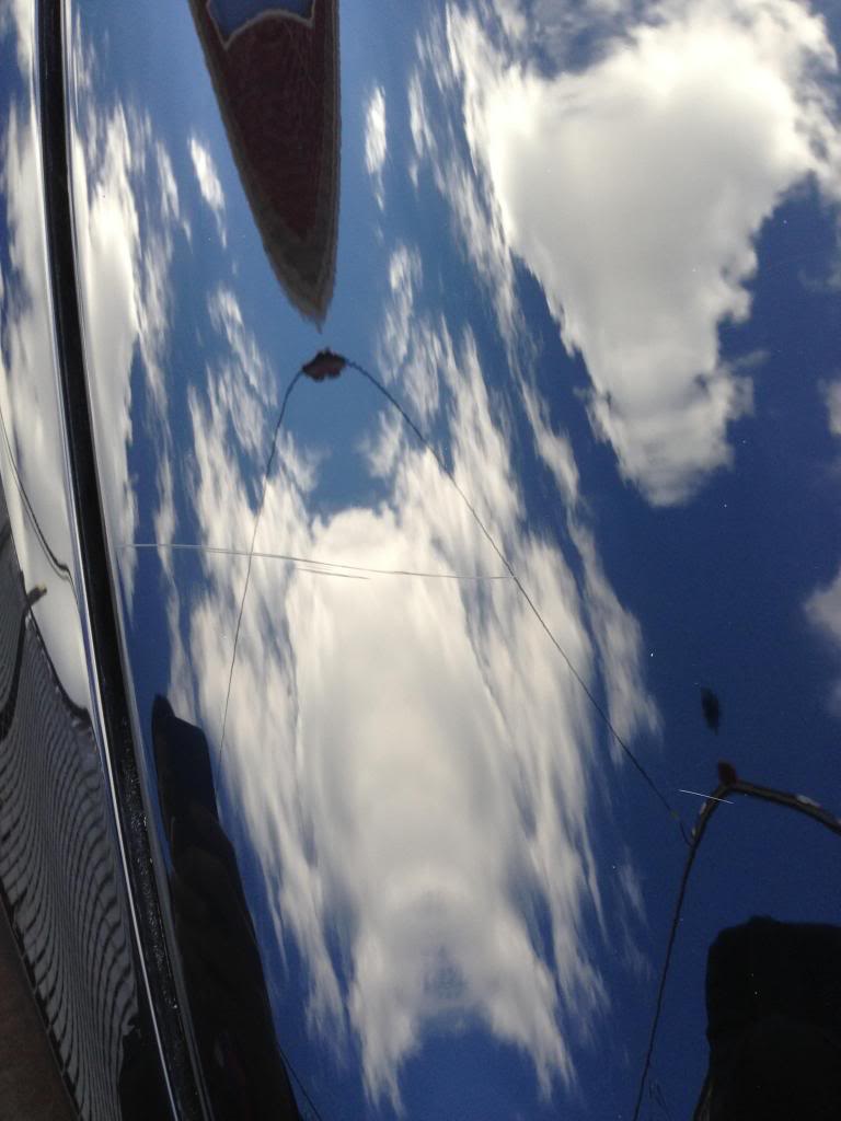

My car also got scratched by Hurricane Sandy. I know my damage isn't as bad as that of some other people who had their cars flooded but the scratches hurt nonetheless. Any advice on fixing these blemishes? Any any estimates on cost or maybe this is something that I can fix myself?
Many thanks.

Glad you are ok and, as you said, the damage isn't that bad. As far as the scratches go, some look like they will go away with a good compound and buff job. I can't really tell by the pictures if the clear coat is still good on some areas like the bumper and grille.

Thanks guys. I actually just left this parked in my driveway. Had the car for less than 2 weeks and that bitch Sandy already scratched my baby. Chunks of my condo fell off from the winds and scraped against my car.
Do you think I can do this myself? Seems like I might have to invest in those rotary buffers..

If you can feel any of the scratches with your fingernail, buffing won't do much.

Yeah, I can definitely feel some scratches with my fingernails. I might have to run this through insurance. Wonder if Geico will view this claim as having any merit. My deductible is 550. This might actually seem like a good opportunity to fix up my whole car( I bough it as used so there are some minor dings).

Wax.. Polish.. Then Compound..
Bring it to someone who details cars and he should be able to take care of those scratches.. YOU WILL BE SURPRISED AT WHAT THEY CAN DO! Should cost you $200 max to do the entire car..
The comopund will actually melt a layer of clear coat and spread it over the scratches. But it has to be done with the rotary machine and by someone who has experience so I would not suggest doing it yourself..
I'm telling you it's worth a shot.. I recently got hit on my door panel. Brought it to a friend of mine that details cars and he got it off 98%!! I was really surprised at how well it came off..

No no no, Compound, polish then wax...
You have the order reversed.
But you are right, OP will be surprised what a 2000 grit sandpaper and a little TLC can do.
Good Luck OP! Does not look all that bad and glad to hear you (and the majority of folks) are OK.
