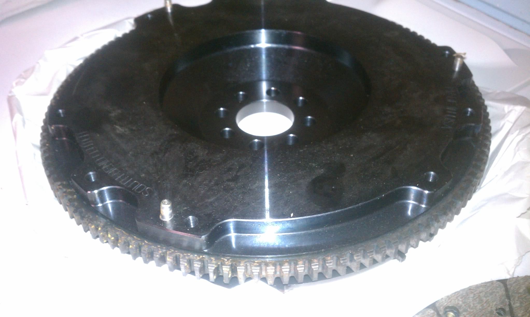

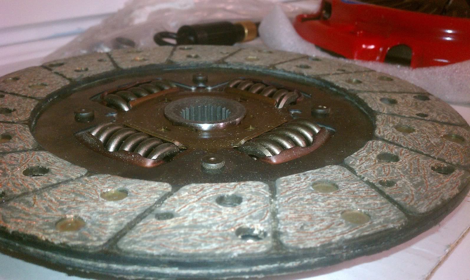

Hey everyone!
Well, my clutch started to slip badly so I ended up having to replace both clutch and flywheel.
They are not covered under warranty, so I went aftermarket.
After asking many forum members, and reading threads here and there, I decided to go with the South Bend flywheel and Stage 1 clutch.
Special thanks to Coz @ Concept Z Performance for all the help. Fast shipping and great pricing as well!
The combo came with all the necessary hardware and a braided stainless steel line, which gives the clutch a nice solid feel:

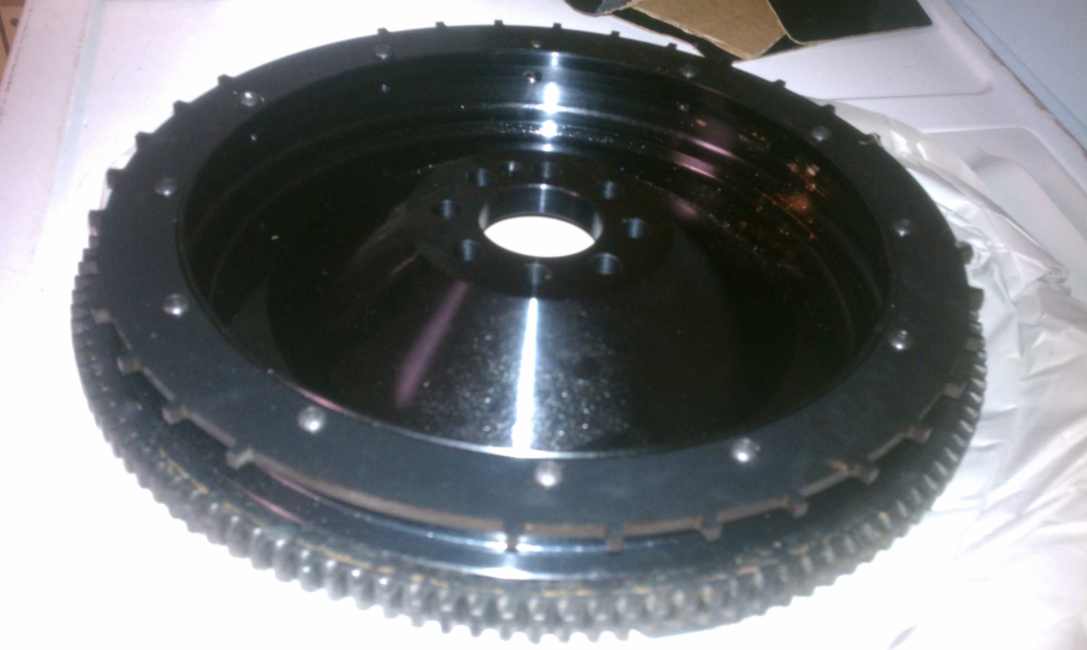

The flywheel is lighter than the stock Dual Mass Flywheel, but not so light that it creates the dreaded loud chatter that I wanted to avoid. It's about 7 lbs. lighter than stock, and although there is some unavoidable chatter, it's not bad at all. It only makes noise at idle (not always) and while taking off but only at low RPMs, as soon as you go over 2K RPMs, the chatter is completely gone.

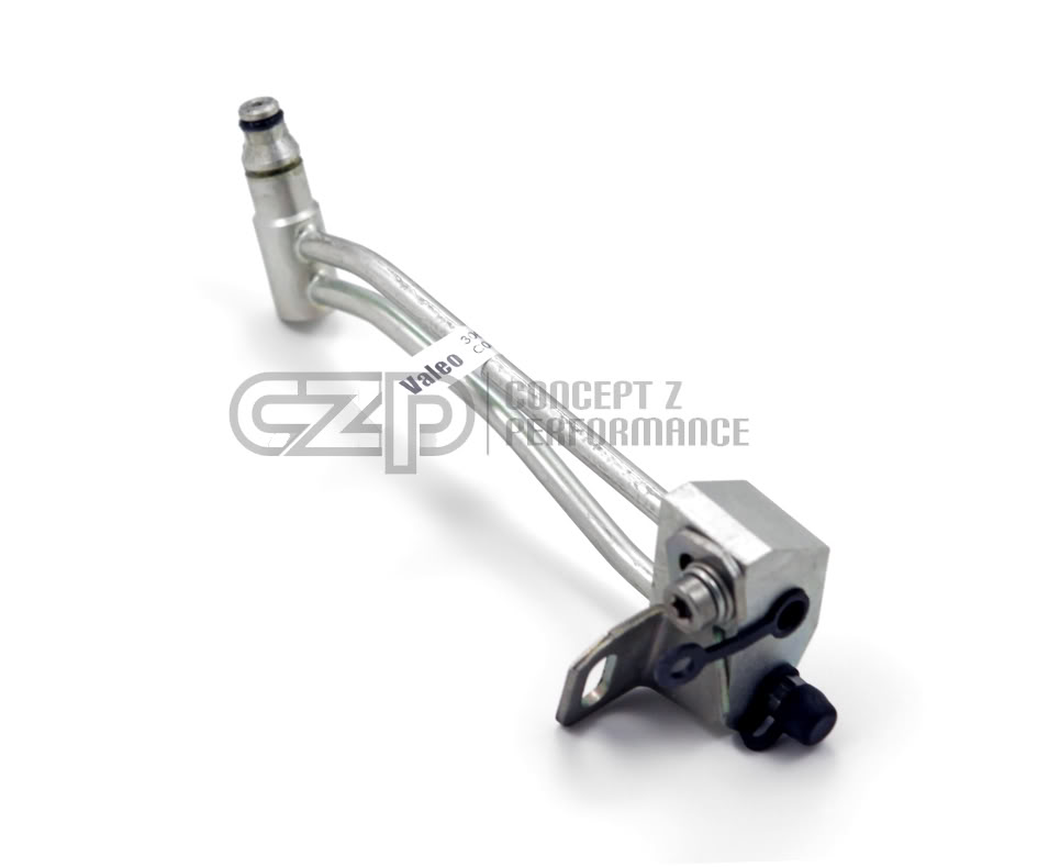

While they were being installed in my car, the CSC (Clutch Slave Cylinder) was also found defective and had to be replaced. Unfortunately, I needed and wanted the car done the same day, so I had to bite the bullet and pay the stealership for an OEM CSC (if you have the time get it in advance, as it is cheaper buying the OEM CSC online and have it over-nighted to your house than buying from the dealer!)
FYI... The CSC is NOT replaced under warranty and the dealer will tell you that you HAVE to replace the CSC "tube" each time you replace the CSC... Not true. Have your shop inspect it, mine was flawless and did not need replacement. Saved myself about $60 there...
Neither I, nor my dealer had any clue as to what this famous "tube" looked like and couldn't give me a part number. I looked online and found it, so if you need one, the part number is 306a2JK40A and this is what they look like (picture borrowed from ConceptZ for illustration purposes)
Fortunately, Concept Z Performance carries all these parts, but they also carry a HD CSC version which is highly recommended, as the OEM part is mainly made of plastic!
I've had the new parts in for a week now. The clutch feels a little stiffer than OEM, nothing crazy. In the words of Black Betty... "it grabs like a ****" lol. And it does, although BB has a stage 3 clutch, my stage 1 still feels like a huge upgrade to the mushy OEM clutch.
The engage point is very low, almost at the lowest point of the pedal, which is expected to raise as it is broken in.
The lighter flywheel allows the engine RPMs to flow faster as it doesn't have to spin a 7 pound heavier OEM flywheel. It feels like I gain speed quicker, and find myself reaching high speeds faster.
So far I'm very satisfied with the setup and find even more excuses to go out for a drive!

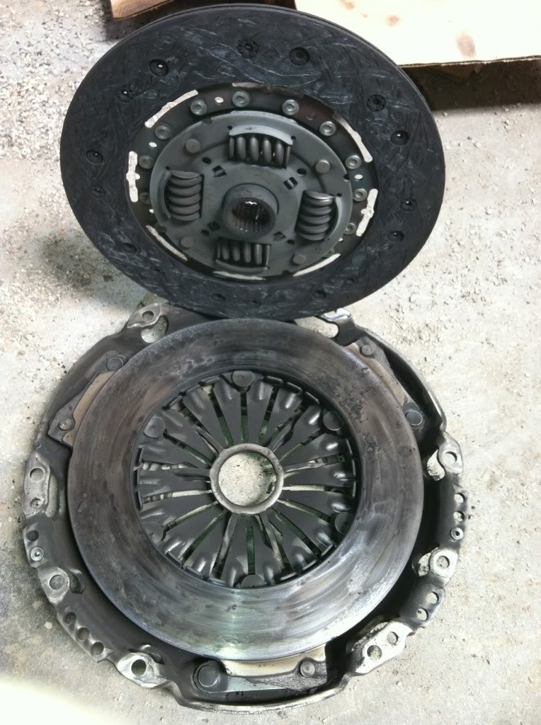

And for those interested, here are the OEM parts that came out of my car...
Who wants to buy this flywheel? "slightly used"
Clutch and pressure plate. Mint condition...LOL
I guess they KINDA needed to be replaced uh? What do you guys think?

The tube in question is to connect the fluid line from the outside to the inside of the trans housing.
The PDF below is a bit outdated, but you can see what/where it goes.
http://www.notre350z.com/forum/files...ructions.1.pdf
Also, from the Zspeed site, it appears the new heavy duty CSC has been redesigned so grinding down the tabs on the trans housing is no longer necessary. Truely a direct bolt on application. (I imagine concept Z is selling these new ones now too?)
Nissan 350z 370z G37 G35 heavy duty CSC Concentic clutch slave cylinder
They probably recommend replacing the stock tube because the oring may not seal properly after the tube is removed. Makes sense to replace the oring (I would) rather than the whole tube. Of course, probably easier for the dealership to replace the whole tube than mess around with a 50¢ oring. Or, some other damage/deformity may occur to the tube during R&R.
From the service manual;
Never reuse CSC (Concentric Slave Cylinder) body and CSC tube. Because CSC slides back to the
original position every time when removing transmission assembly. At this timing, dust on the slid-ing parts may damage a seal of CS C and may cause clutch fluid leakage.
Found this pic on ebay of the stock tube.
Jon, you don't have any pics of the inside of the pressure plate?
I couldn't find any, unfortunately. I have one of the old one that is all torn up, but don't think you'll be interested in that one?

Jon, I'd love pics of your old parts if you have any! I'd like to see what this stuff looks like after thousands of miles.
There you go buddy! Added pics of the "lightly" worn items on the main page.
Parts were replaced at around 53K miles. A little early, but as I stated before, the lady that owned my car before me didn't like the car too much I guess...
