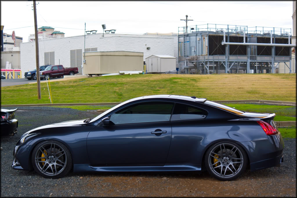

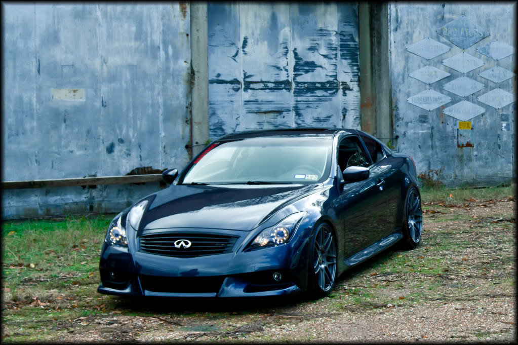

I liked my Forgestar wheels.

Hey... I am lowered with Eibach spring. What offset should I go with flush fitment. I have 255/35, 285/30 tires.

Depends on your definition of flush. You have meaty tires so could probably only get away with +18 (maxed) on a 20x9 in front and a +27 on a 20x10.5 rear. I was on coilovers, so I was able to adjust as needed. You may still rub and need to trim the bracket though. Good luck.

What if i just stay with 245/35, 275/30?

That's the set up I had with those same offsets.
In order to get a lower offset you would have to stretch tires which I didn't want to do.

Btw...@ breftayka.....that's one sick looking coupe!
