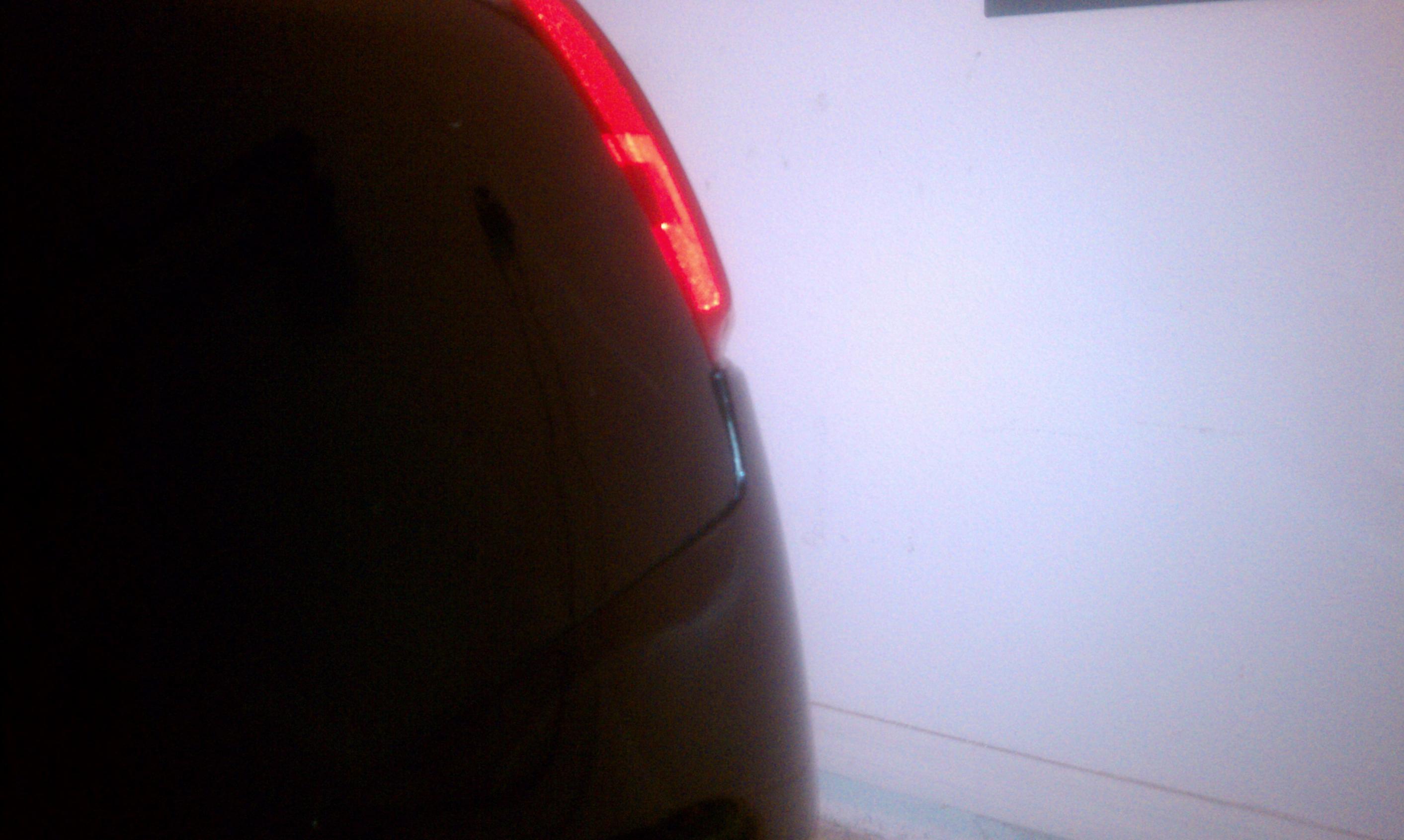

Rear Bumper
Has anyone had any issues with their rear bumbper not lining up on the outside edges? The dealer said its from the heat that the edges are starting to pop out.

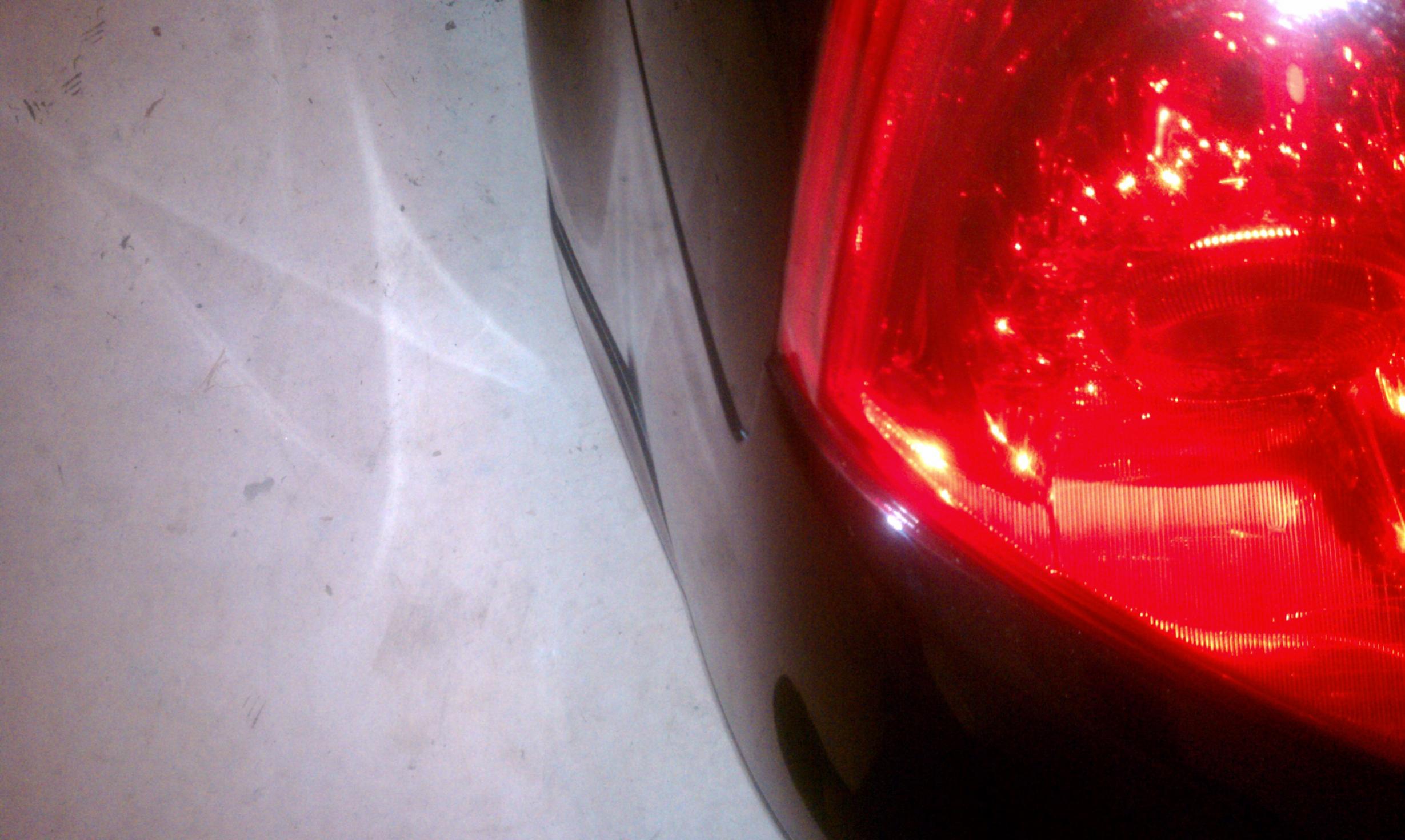

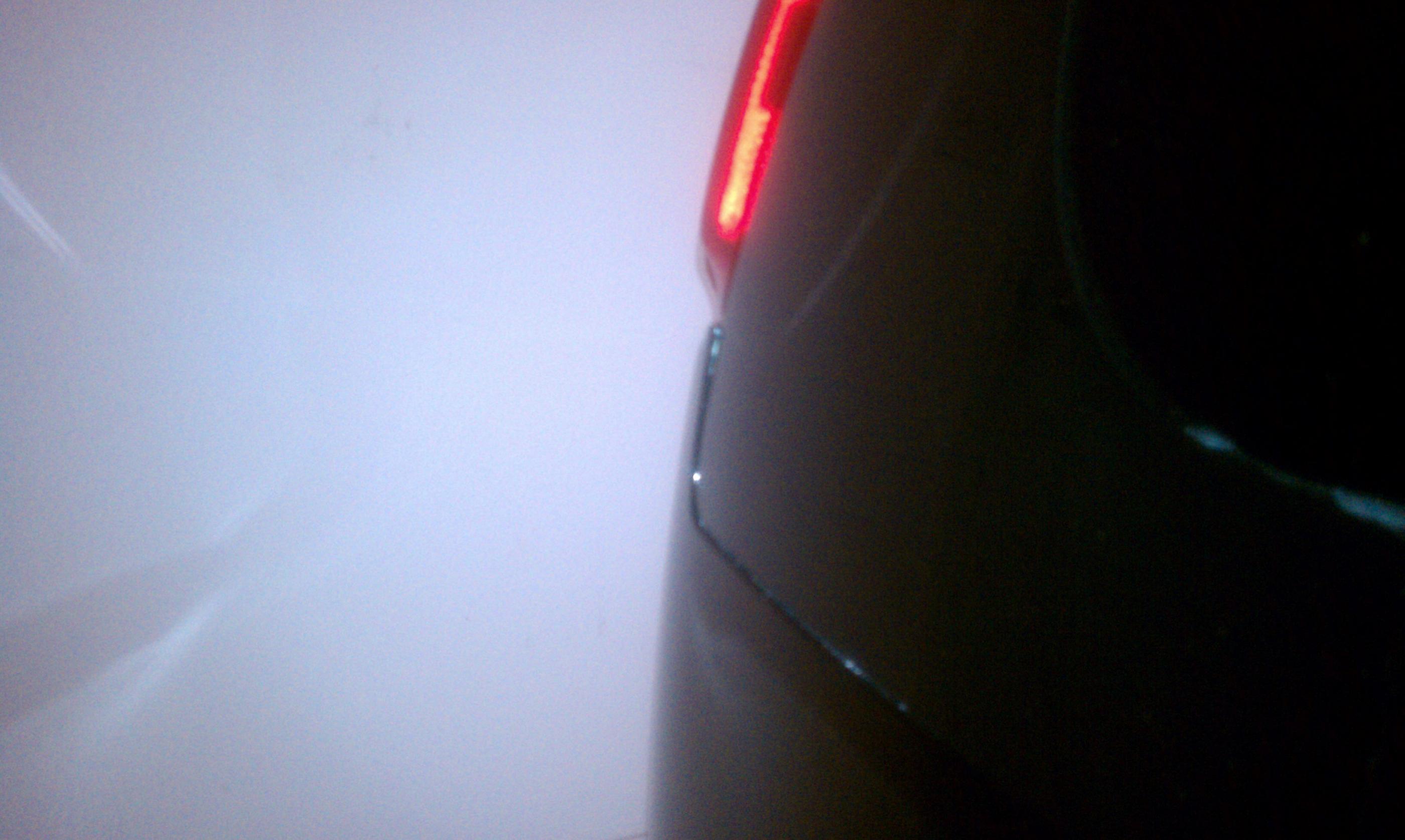

Old Nov 11, 2010 | 08:21 PM
jblyden20's Avatar
jblyden20
Joined: Oct 2010
Posts: 50
Attached are some pics. Sorry they aren't real good pics. I took them with my cell phone.

Old Nov 11, 2010 | 08:24 PM
Greggski's Avatar
Greggski
Joined: Feb 2008
Posts: 227
From: Woodinville, WA
My guess is the bumper has been replaced. I had mine replaced from a rear end collision and it did this too - it was even a genuine Infiniti replacement. It bugged me so I took off the tail lights to access the top of the bumper in that area, drilled a small hole in the top lip of the bumper, and pulled them in with stainless zip ties attached to a metal bracket at one of the bumper attachment points. Once you re-install the light, it covers everything up and you can't tell a thing. Has held up for about 20,000 miles now with no issues.
I had this exact same problem on my white '09 coupe. I bought it new and noticed it about one week or so after purchase. This is when the paint started flaking and peeling off the front clip and I carefuly inspected the entire car.
Long story short, dealer bought the car back. I know that's not helpful to you, but maybe the car was like that from the factory?
Old Nov 12, 2010 | 01:41 AM
tWistedMissiOn's Avatar
tWistedMissiOn
Joined: Sep 2009
Posts: 978
That looks so off man. I'm with Greggski, that bumper may be replaced, but if you got it new, maybe you should take it back to the dealer like AKG37 did. If the dealer says its from the heat, i say its total BS. Have it replaced man, make the dealer change a new one, and make sure it 'clips' great. That shouldn't happen to a new car. Even my front bumper that i've taken off and put back is not like that. Good luck man.
Old Nov 12, 2010 | 01:50 AM
REaL's Avatar
REaL
Posts: 46
From: CA
Looks like a re-manufactured replacement bumper (OEM but fixed to standards). All insurance companies will go this route first to save some money and unless the owner complains they get away with it. I had the same thing happen, I made them order a brand new one. It's now flush.
Sounds like a shady dealer that didn't tell you when you bought it. I would ask them to fix it.
