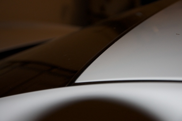

Here are pics comparing the glass fitment on both sides.
left side:
right side:
Old Aug 19, 2010 | 11:00 PM
hispeed-lowdrag's Avatar
hispeed-lowdrag
Joined: Apr 2009
Posts: 4,190
From: Pensacola Beach, FL
is that left = passenger and right = driver?
Old Aug 20, 2010 | 12:07 AM
brycerocket's Avatar
brycerocket
Joined: Jun 2009
Posts: 68
sorry mixed it up - the first pic is right and the second is left
