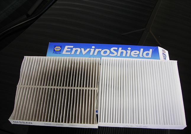

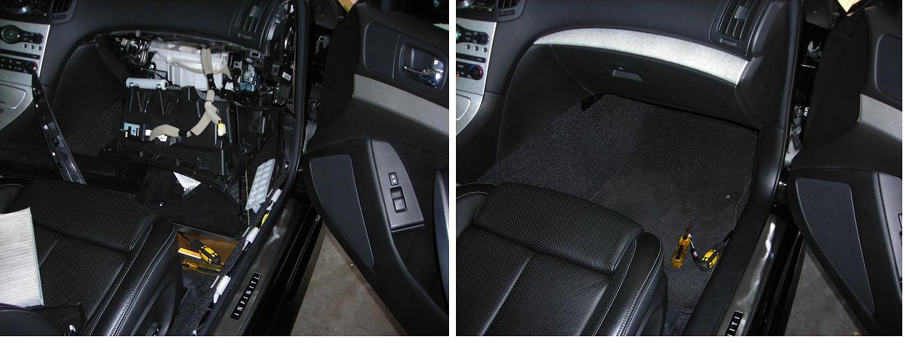

Replaced Cabin Filter @ 13K
Just did this today...it took a little longer than I thought it would..should have followed this link to do it
http://www.infinitihelp.com/diy/gsed...eplacement.htm
but decided to just 'feel it out' (which was dumb as you can see from the pic). anyway, Infiniti quoted me $54.99 for the non carbon paper filter (LOL), nissan quoted me $29.99, but I got one at Napa for $18, which looked exactly like the one I pulled out of my car. At 13,000 miles the filter didn't look too bad but I noticed a good accumilation of dirt at the bottom edges of the filter. I can definately tell a difference. no more odor plus the a/c feels / smells much fresher.
good experience...never done it before
spend 1 hour of your time and buy an $18 paper filter > Infiniti quote of $200 + $55 filter
Attached Thumbnails Replaced Cabin Filter @ 13K-nissannapa.jpg   Replaced Cabin Filter @ 13K-glove-compartment.jpg

happen to catch a pic of what glove box bulb is in there??

Jesus man all that work to install a firigin air filter. Couldn't Infiniti make it easier.. shheessk! While I'm at it Ill change bulb to LED.

so instead of paying the dealership $255, you did it yourself for $18?! that's awesome... I'm see it my local NAPA has the filter, any special name, model #, or size I should mention?
Old Oct 6, 2009 | 01:37 PM
cvt's Avatar
cvt
Joined: Apr 2006
Posts: 1,499
From: Los Angeles
The Napa Filter is called Enviroshield 4479. Just ask them what make and model your car is and they'll give you the replacement filter. I brought my used filter in just to make sure the size was correct...it was funny looking at both the Nissan filter and Napa...they were identical...but I guess the dealership had more than a $35 mark up just to stamp 'NISSAN' on the side...LOL.
No I didn't, sorry. I was just a little perplexed at the complexity of changing an in-cabin filter. My wife's Scion TC took me litteraly 2 minutes to replace the in-cabin filter...so, yeah I was a little in shock. LOL.
I can tell you that despite my fiddling around, the next go-around will be much easier. A lot of time spent was trying to easily nudge the plastic pieces out as to not break them. Plus all you needed was a phillips screw driver and a flat head.

Yeah this job isn't that hard. It's DEFINITELY not worth shelling out $100-200+ for the dealer to do this. You can do it yourself in under an hour (I could do it in 20 mins now that I know how to take that part of the lower dash apart). Save that money for girls or beer....or both

i just got a quote from TO Nissan for a carbon cabin filter for $41...kinda pricey but waaay under Riverside Infiniti's price of $75. I wonder if the carbon is even worth it...
